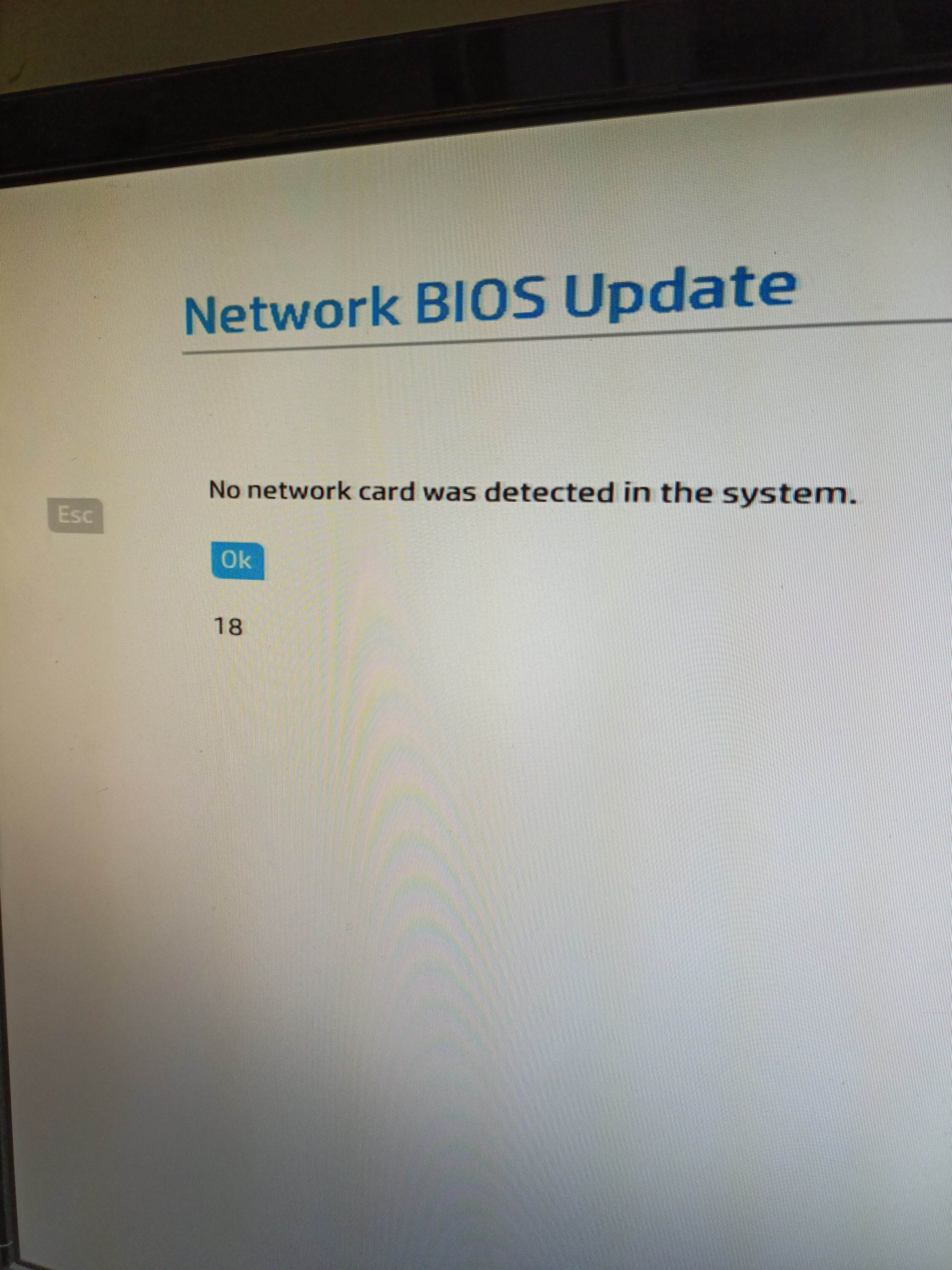

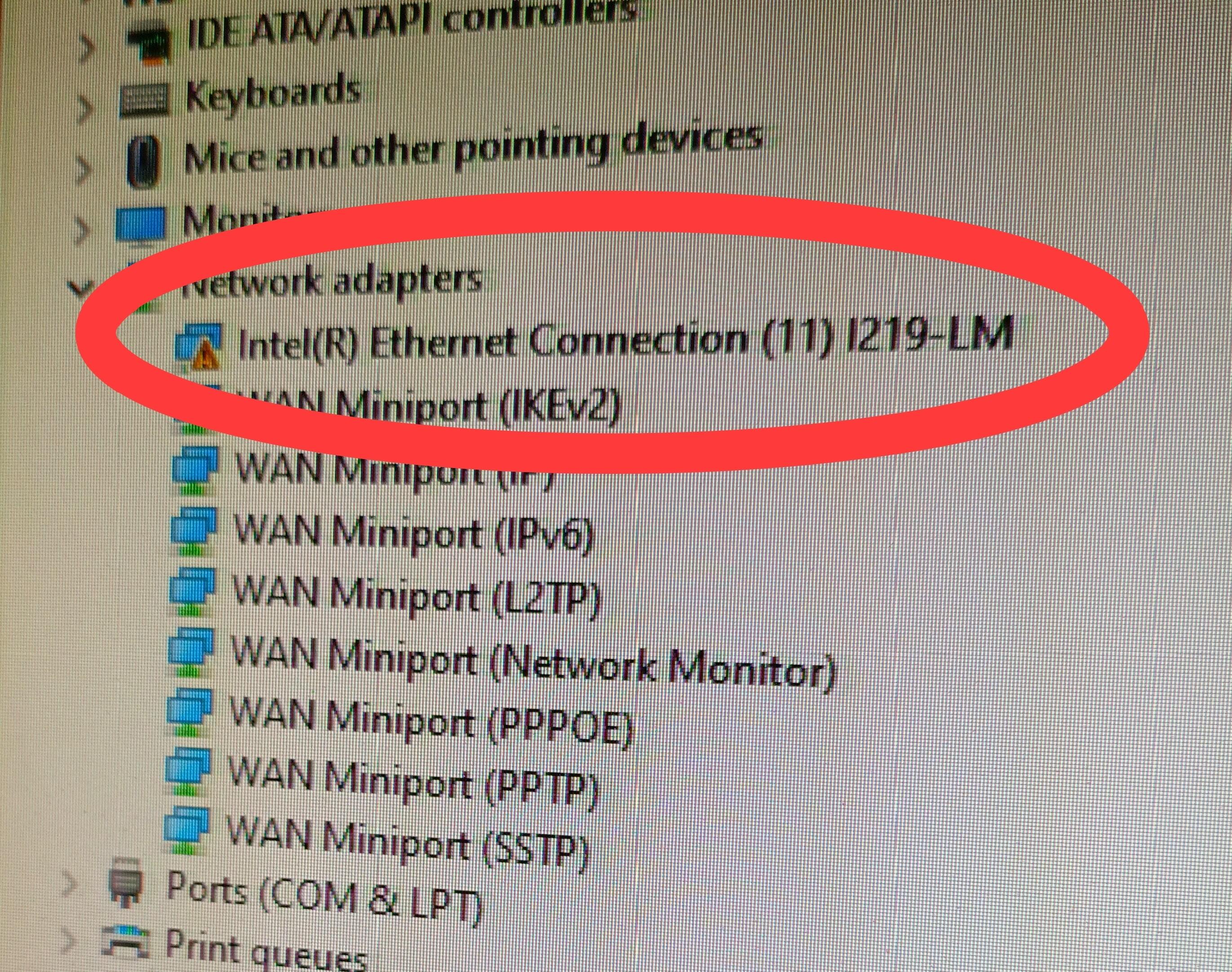

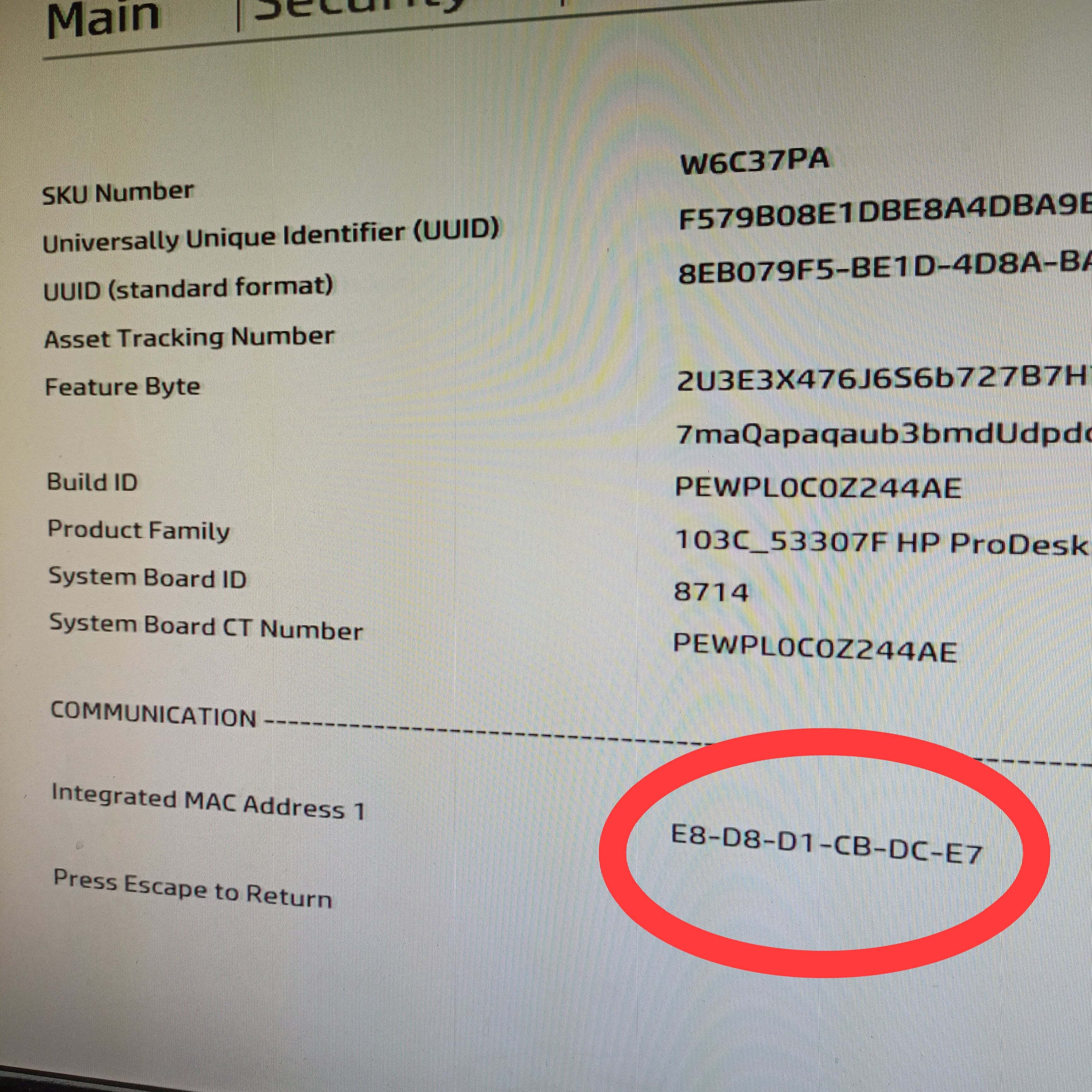

                            I have a Hp 600 G6 SFF motherboard with corrupt bios. I tried to fix it's original bios but it didn't work so I edited and used another bios. Everything is ok but it's ETHERNET port is not working. I even replaced the GBE region but no use. I have faced the same problem in another Hp 600 G6 SFF motherboard after using this bios so it's definitely bios problem. Kindly help to solve this issue. There is no label on the casing so I can't provide the serial number.
                            • ASB
                              • Dec 2020
                              • 133
                              • Pakistan
                              Someone please help to fix this issue.
                                • 21029
                                Try MAC address tools https://www.badcaps.net/forum/troubl...60#post1465160
