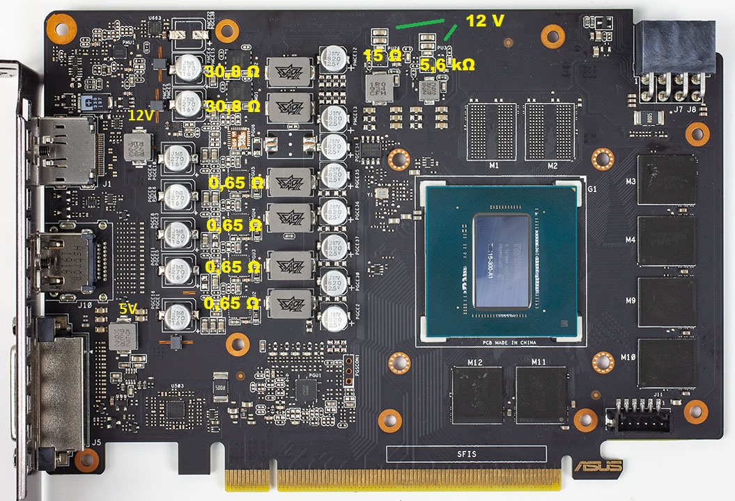

    Hi Guys!
    I would like to ask some help for my ASUS PH-GTX 1660 gpu.
    As you can see on the picture I found only 12V and 5V voltages.
    I have boardview and schematics but I don't understand why don't have more voltages.
    Anybody can help me?

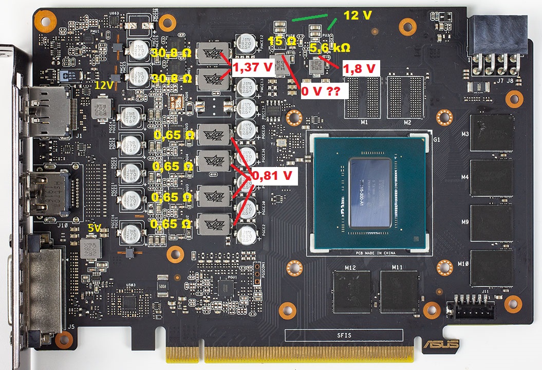

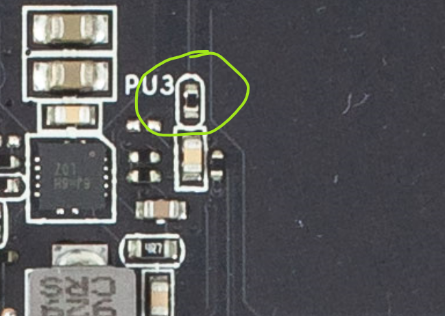

    Re: ASUS GTX 1660 dont detect, missing voltages
    OK, I finded one missing resistor: PR338 near of the PU3 chip.
    I added one 0 ohm resistor and now I have more voltages.
    VPEX is missing at the moment.
      I found more missing parts on VPEX line. After I put the resistors I got VPEX, but I dont get picture...
      Linux lspci lists the GPU but nvflash give error message: "Adapter not accessible or supported EEPROM not found"
      I can write this bios chip with ch341a + 1.8V adapter.
      In bios pin 1 I measure 1.8V continuity. It seems the CS (chip select) command is not received.
      Anybody has suggestion what can I do?
