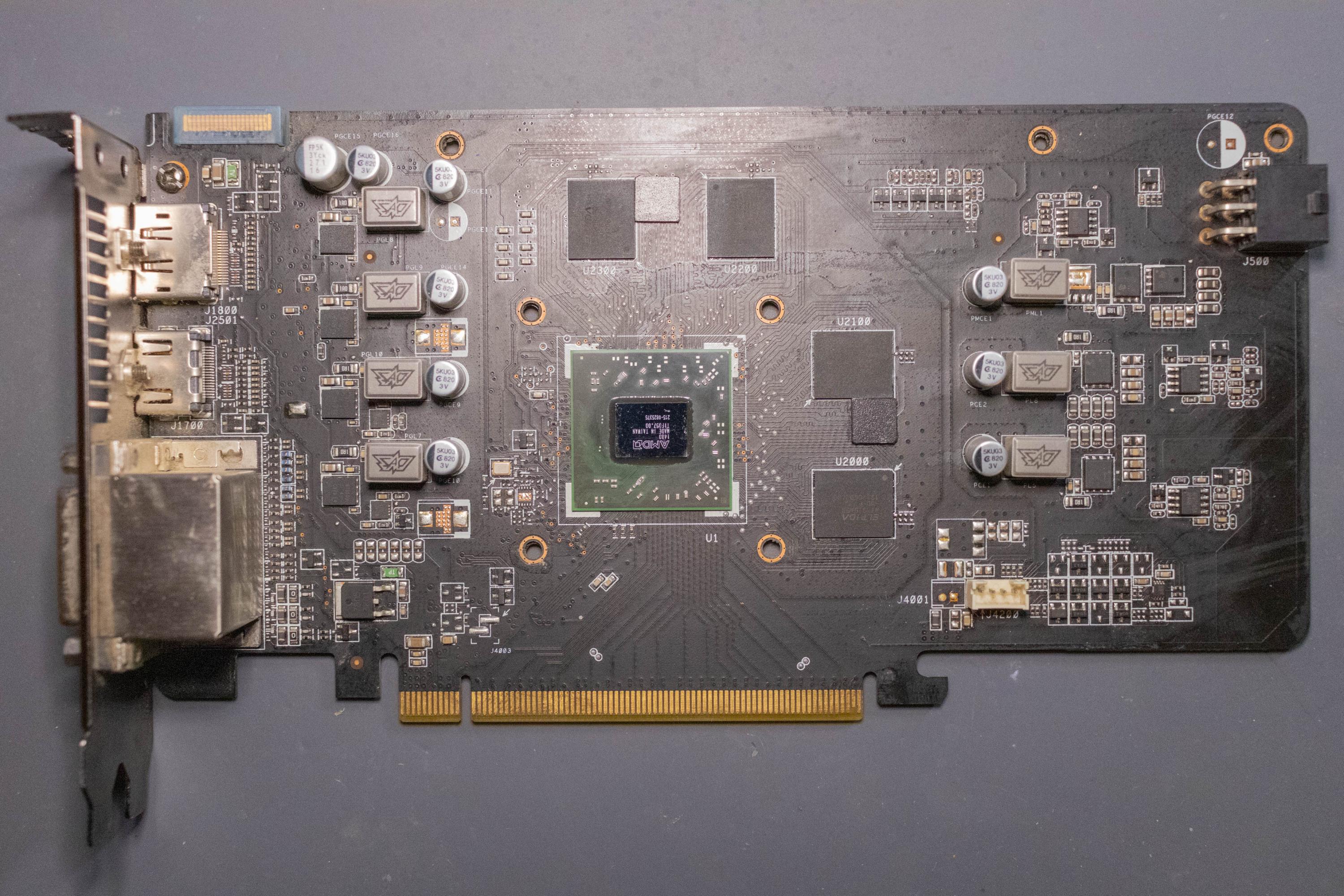

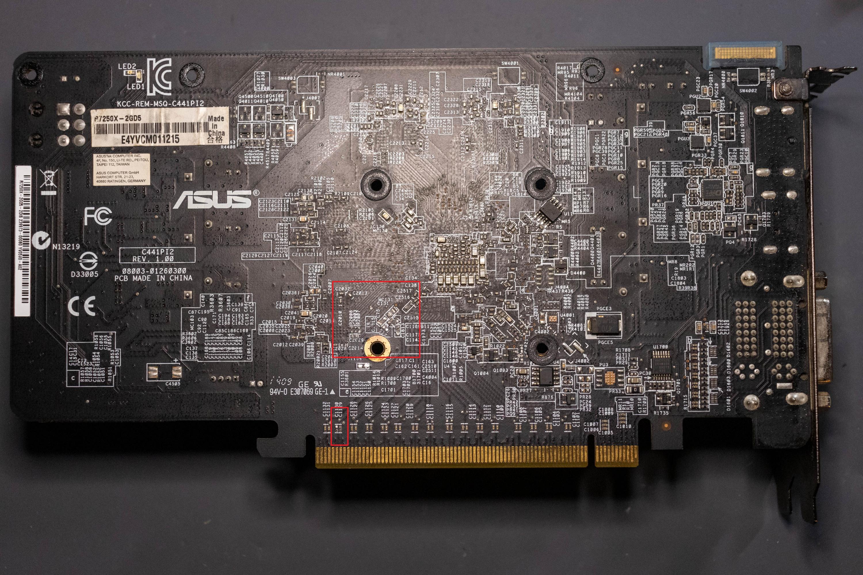

    I have got on my hands broken R7 250x (cooler spins but no video output).
    And on the back side, I see that there are some capacitors missing.
    I would like to hear:
    1. Could it be that missing caps could do that ?
    2. Could I Replace them from other different video card, relying on only by its size?
    3. Does anyone have a boardview file or schematic for this card ?

    If the missing caps are near the gold edge fingers then they are the mandatory dc blocking caps. Without the caps, the PCIe interface cannot function and the adapter will not be enumerated (detected).

      Yes, there is missing caps near pci connector.
      Does it have satandart value and i can take it from other video card that have it ?

        Yes, the ones near the gold fingers are standard values.
        They will be 0.1uf X5R or x7r 16volts or higher in 0402 smd size. That is pci express spec.
        Yes, you can take from other donor video cards if the other caps are near the fingers, they will be with the same specs.
