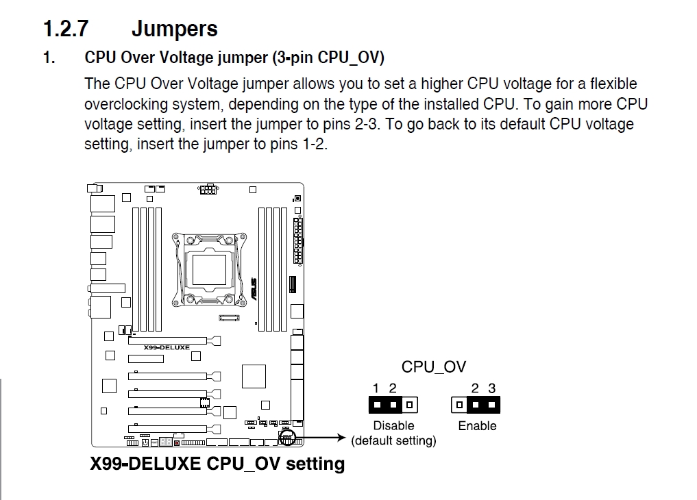

                      Have another idea: can you check what is the setting of this board jumper:

                          The pin 109 have 1v , and the jumper that you tell me below is in position 1-2

                              Re: Asus x99 Deluxe CPU OVER VOLTAGE ERROR
                              1V on 109 looks OK.
                              Change the jumper position to OC, and try to boot the board.
                              Try also too switch off VCORE monitoring in the BIOS and look what happens.
                                Originally posted by DynaxSC
                                1V on 109 looks OK.
                                It's still the same, it's already leaving me without ideas. There's nothing weird on the board either.
