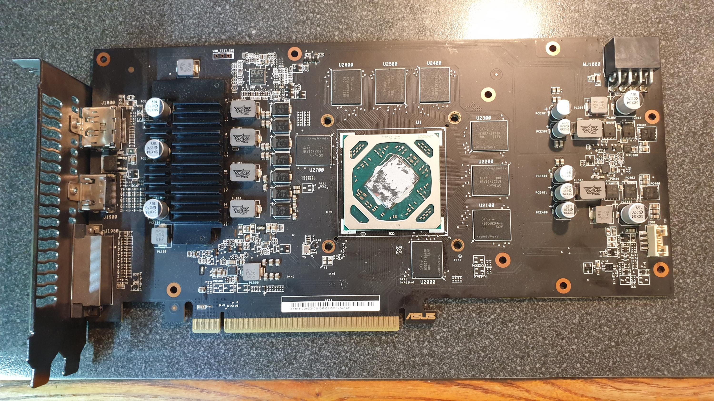

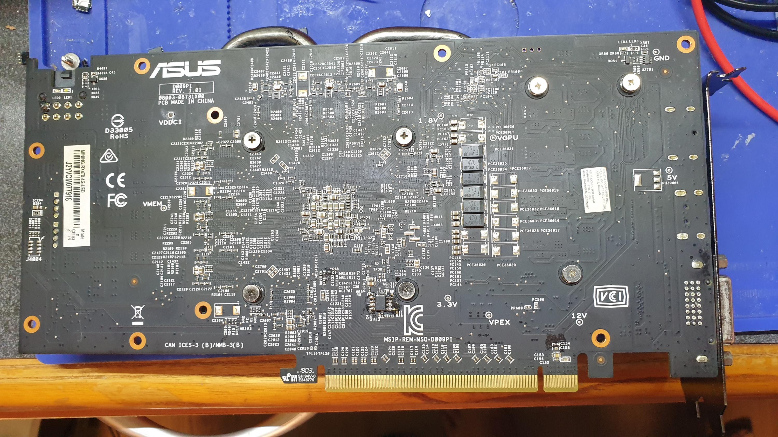

    Hi!
    I have 2 ASUS EX-RX570 4GB with same problem.
    The main voltages are present:
    - 5v
    - 12v
    - 3,3V
    - 1,8V
    - VGPU
    - VMEM
    - VDDCI
    - VPEX
    - no fan spinning
    - in the BIOS chip 1. pin no sign, fix 2,7V (this is chip select)
    - GPU is warming normaly
    The motherboard dont see the cards. I tried via linux, windows.
    Unfortunatelly I dont have boardview or schematic and I cant find it anywhere.
    Can anybody help for me? How can I find the problem?

                  Re: ASUS EX-RX570 all voltages present but not detected
                  Try to change network reistor array 330 beside the BIOS chip.
                  • Aliencomputres
                    • Aug 2019
                    • 217
                    • România
                    Just put the card in a pciex mainboard with no os and try it.
                    At this model fan not spinning at start.
