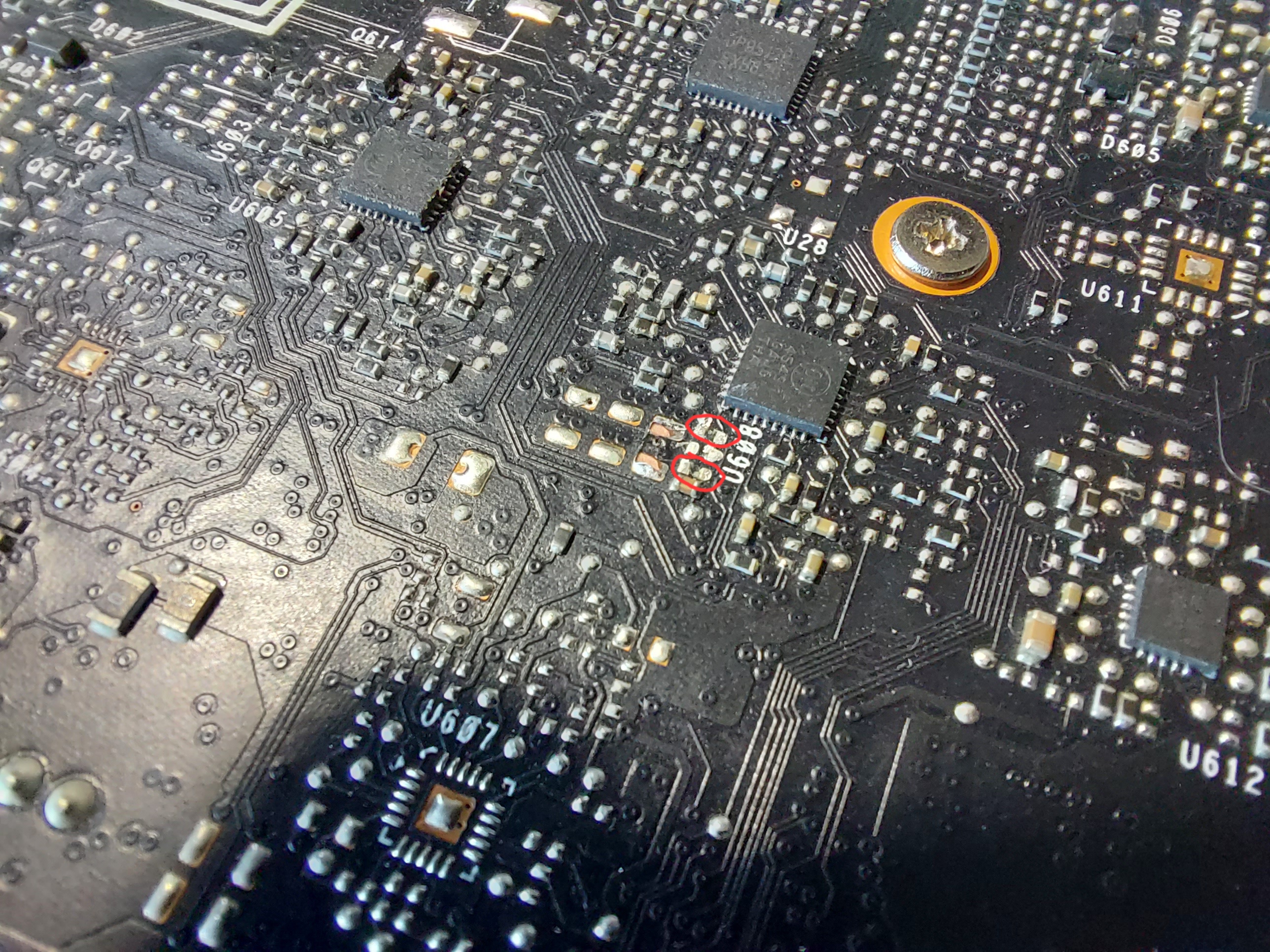

    Asus RTX 2070 missing resistors

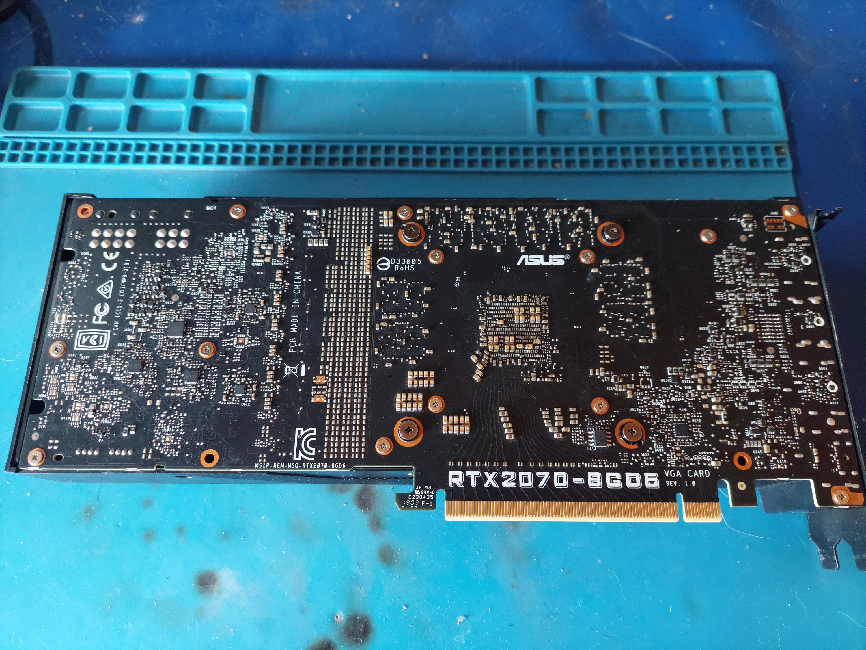

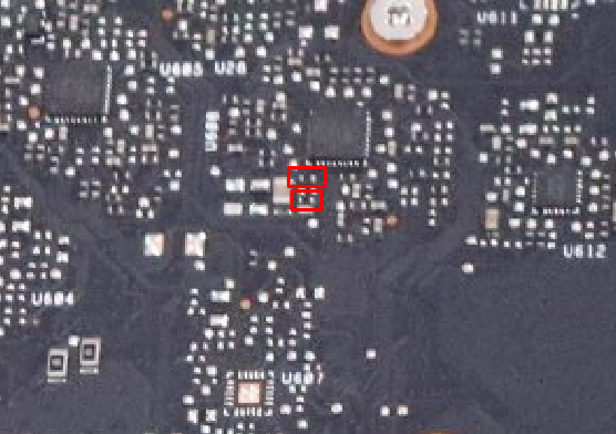

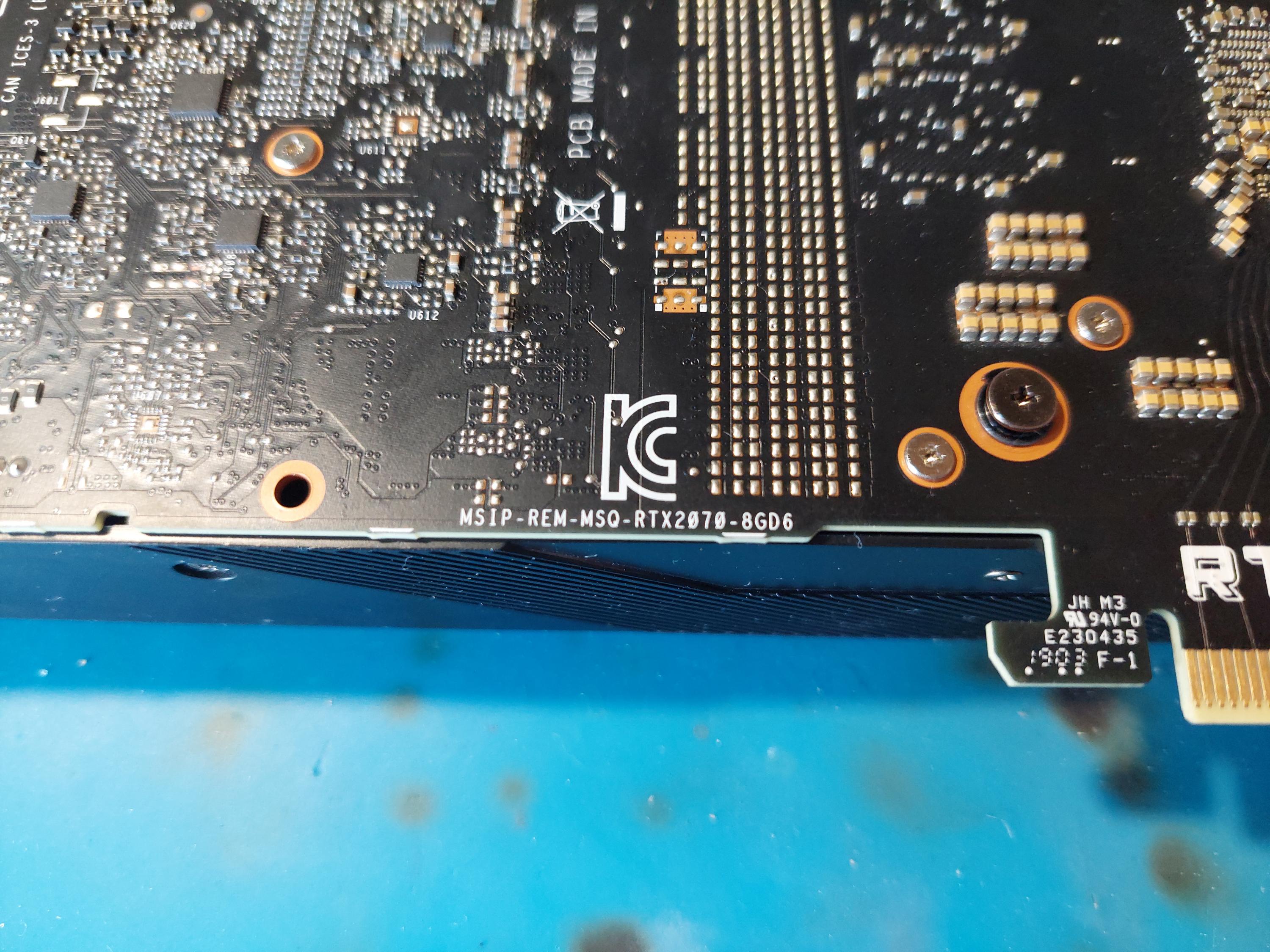

    Hello, I need someone with the same graphics card to take some measurements with multimeter, I have card with two missing resistors and a cap. The cap doesn't matter, I'll just stick 10uF there, but I can't find the value of the two 0402 resistors. Any help is appreciated.
    https://www.asus.com/Motherboards-Co...BO-RTX2070-8G/
    Pics in attachment.

    Re: Asus RTX 2070 missing resistors
    1k on top and 15k on bottom.
      Thank you for the answer.
