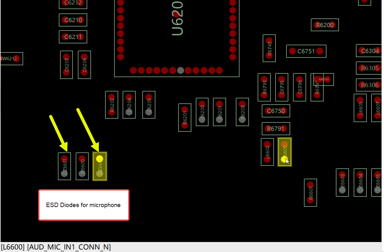

    Hi guys,
    I have this iMac with that fault, the integrated microphone is not detected, and also plugged an external one and same.
    Tried the "pram" reset procedure several times without any change, no noise is detected.

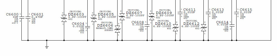

    I thought someone would connect a line jack on the past to the microphone jack and some protection diode was deployed, maybe a DZ6600 or similar.
    The other audio capabilities are ok, only the mic is not detected.
    On the BRD file and on the service manual there are some differences on the presence of some diodes (varistors?) and condensors on that line on the manual that are changed on the BRD file, that confused me, maybe different revisions on the board.
    Checked for shorts or broken lines to the audio chip and seems all is ok on the mic lines to the pins on the audio chip.
    Any one could point me to a correct way? Thanks!!

    Do you see the protection diodes on your logic board ?

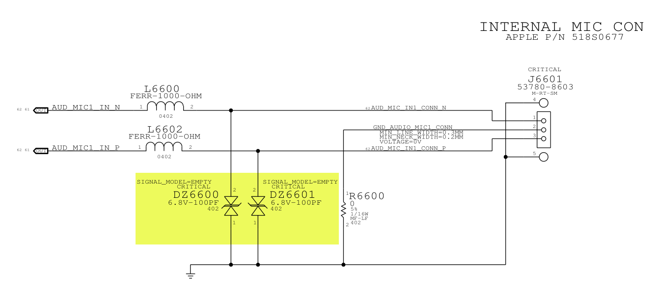

    Remove all power -> check the resistance to ground at the points in the attached with the yellow arrows.
    You can check with meter on:
    pin #1 and # 2 (Ground) of J6601 -> what is the resistance ?
    pin #3 and # 2 (Ground) of J6601 -> what is the resistance ?
    Confirm that L6600 & L6602 are present and not defective onboard.

      J6601: pin#1 and #2 -->3,31K
      J6601: pin#3 and #2 -->22,30K
      The values are about the same of other imac boards with similar sound chip
      same values at the pin 1 and 2 of each L6600 (3.31K) and L6602 (22.30K), functional coils.

        Check the voltage of the same pins # 1 and # 3 on J6601.

          0.000v readings on each one.

            Remove all power. Meter in lowest resistance scale.
            Check the resistance from the pin on the connector and to the one side of the inductor on this trace. It should be ~0 ohms.
            Then check after the same inductor. We want to confirm that each series inductor is not damaged so the readings should be ~0 ohms for each test.
            Repeat for the 2nd series inductor and pin on the connector.

              J6601: pin#1 to L6600 pin#2 --> 0,008ohm
              J6601: pin#3 to L6602 pin#2 --> 0,008ohm

                The pin#1 readings on the L6600 and L6602 are 0,003-4ohms, so I think the inductors are OK

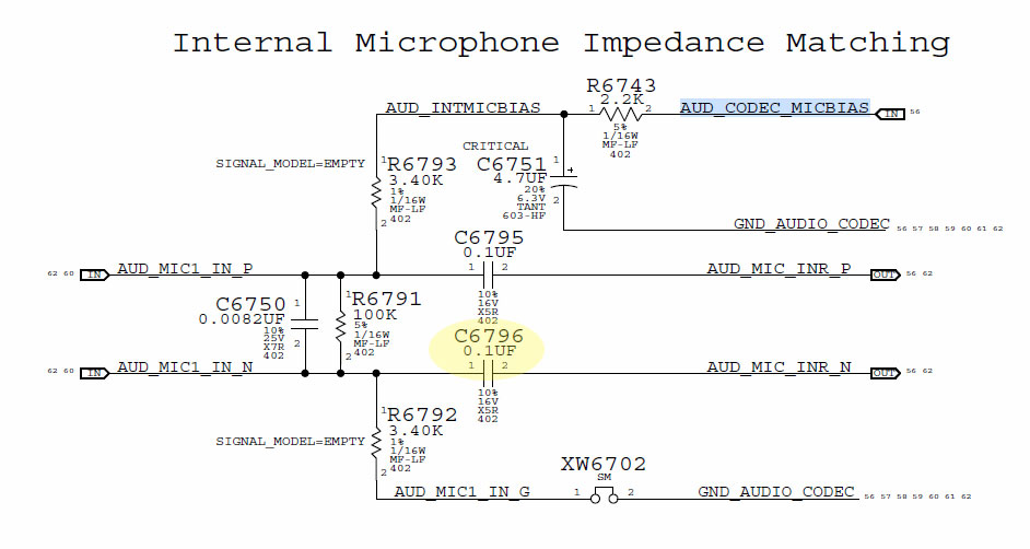

                    I was comparing with a similar board, same scheme for the headphones, there is a slight deviation on readings for one channel, and the capacitance of C6796 not offers any result on the meter, on the other board there is a reading of 205nf, I know the readings on board are not just the component ones, but this capacitor offers none, could be suspicious?
                    With meter on diode mode the readings are OK for it; 1,961 on P1 and 0,75 on P2.
                    Omhs reading not, on the functional board, P1 shows 3,304K and P2 4,464 MOhms, on the failed P1 3.31k (about same) but P2 3,94Mohms.
                    This deviation on readings occur also in other capacitors and resistors, but this one, is the only one that not give a capacitance value.
                    I plan to remove it to see what happens on readings.

                      Removed 4 capacitors, C6750, C6751, C6795, C6796 and the readings off the board are ok, failure not here, totally lost now.

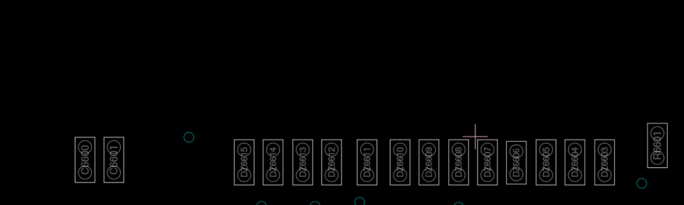

                        I was thinking if there is a problem at the remote audio connector J6600,
                        The schematic shows some combination of capacitors and varistors, but on brd file are all varistors.

                            The varistors are actually ESD diodes to maintain the voltage on that rail remains below the threshold of each diode.
