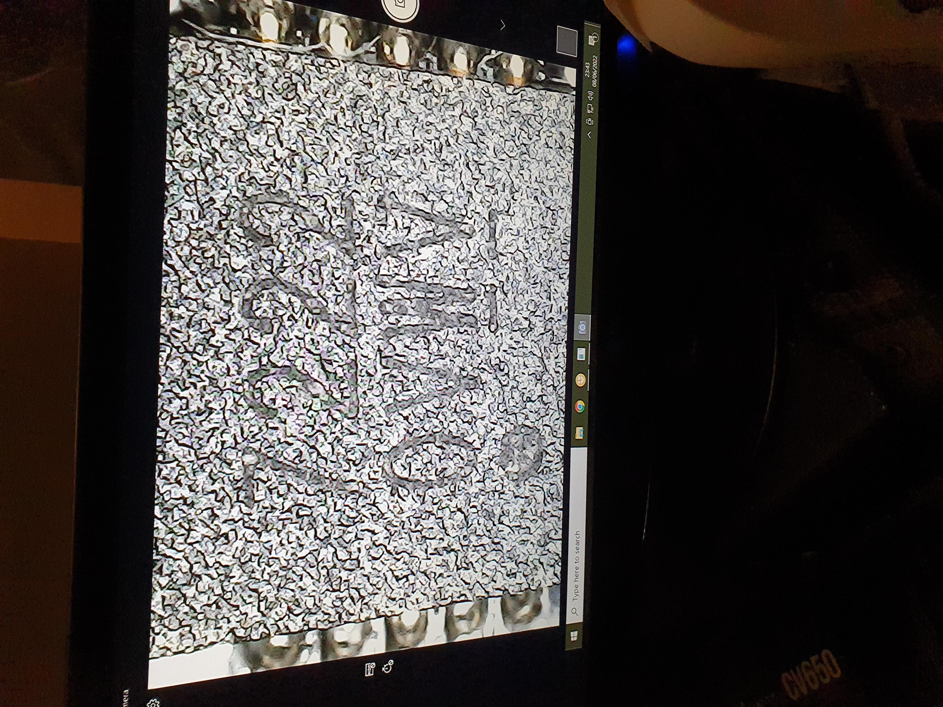

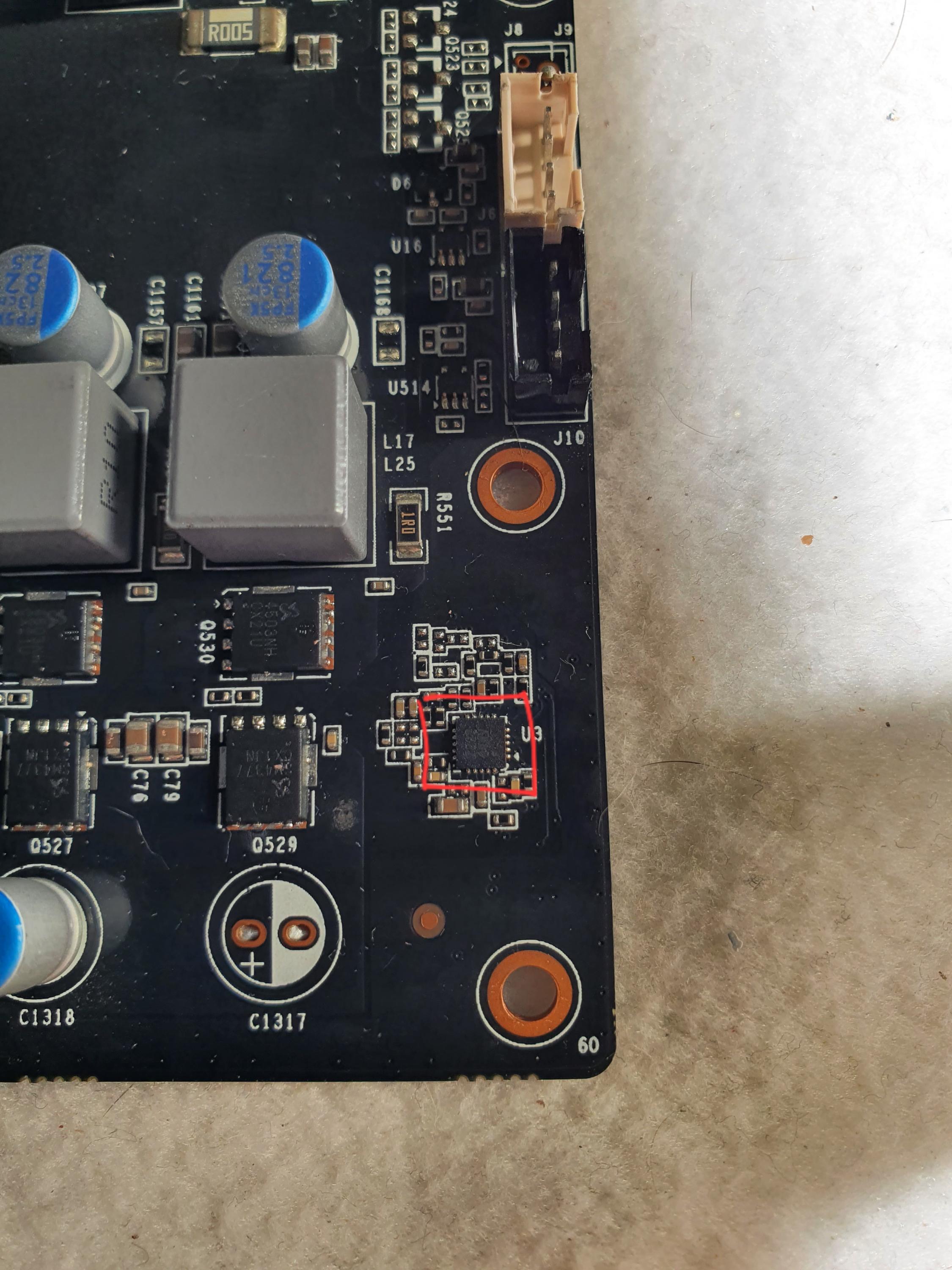

    Hey guys looking for a little help on an IC chip that gets extremely hot, i think its a buck converter but want to be sure to get the right part.
    The identifiers on the chip are:
    7222
    0VWV
    I have been unable to find pcb images of the model the 2060 (2060 Dual the Palit 1660 super has a similar 20 pin chip NCP81278 the board layout in that area is very similar)
    Thanks for looking in on the thread!

    The 7222 is a GS7222TQ-R
