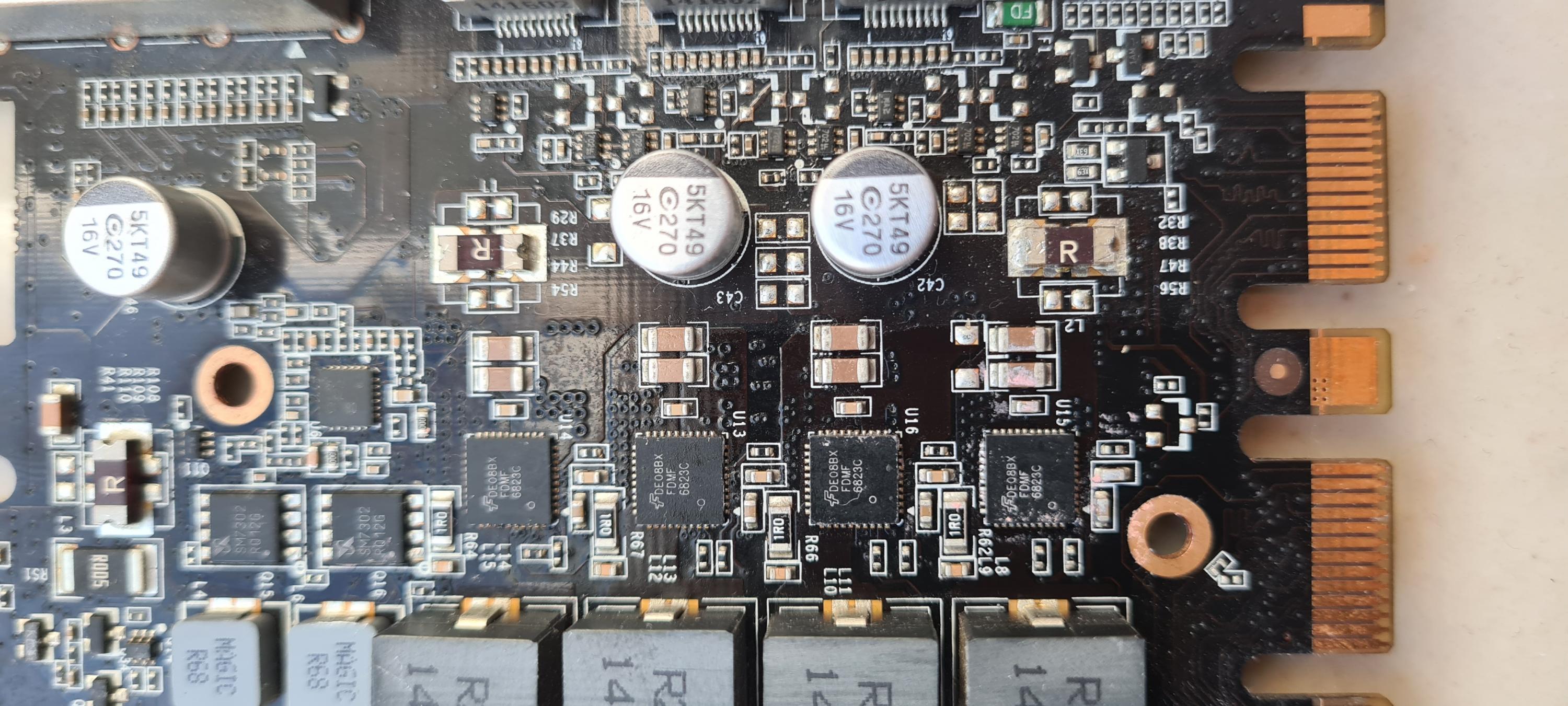

    Forum members . I have a Palit GTX970. Two fuses marked R are blown. I want to replace them but I don't know which ones to order.They were damaged when connecting the card with the computer turned on
    I'm learning, so forgive me. Maybe someone has a Palit gtx970 diagram
    Thank you in advance.

    AF2-8.00V125TM 2410 1808 8A 125V SMD fuse Fast Acting Surface Mount Fuses Marking R

        fuse dont blow themselfs. measure and i bet u find some short on other side
