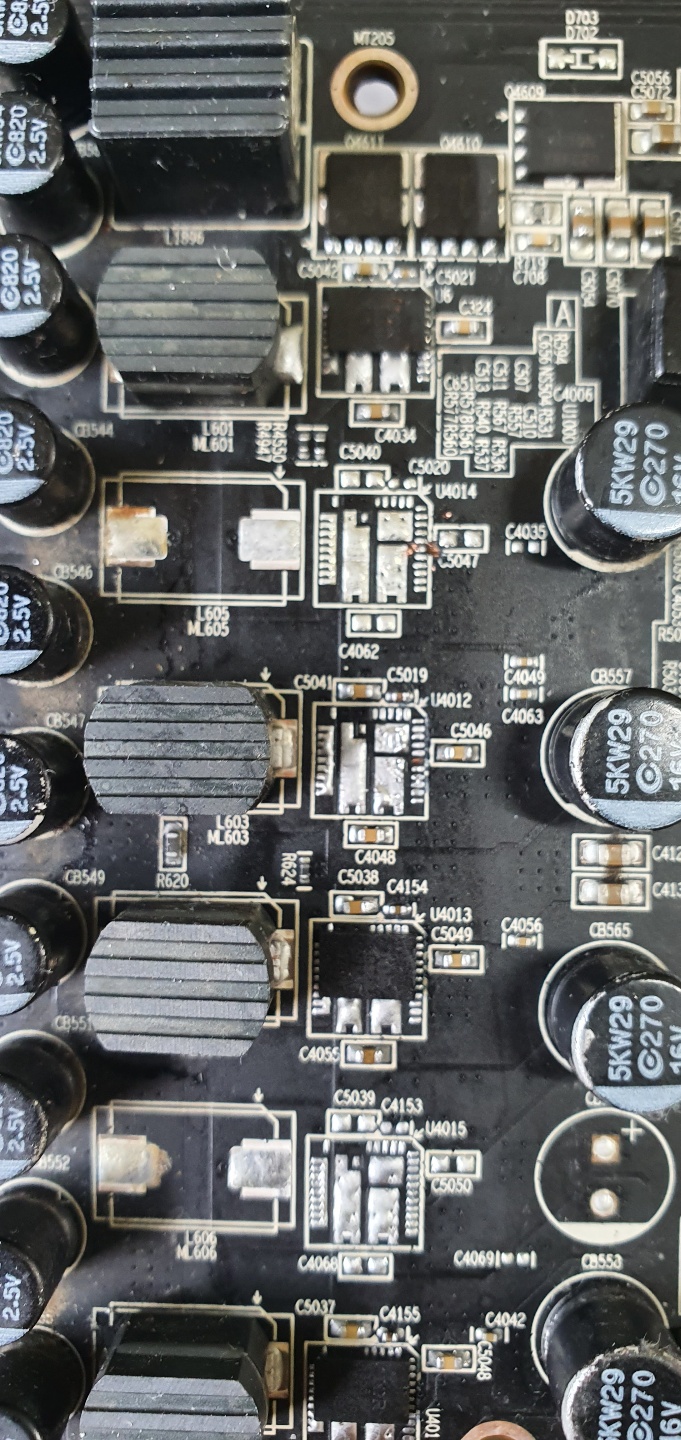

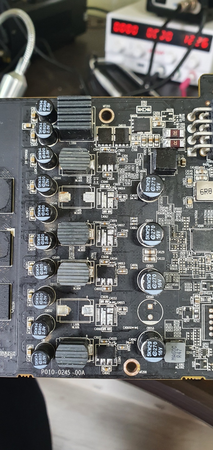

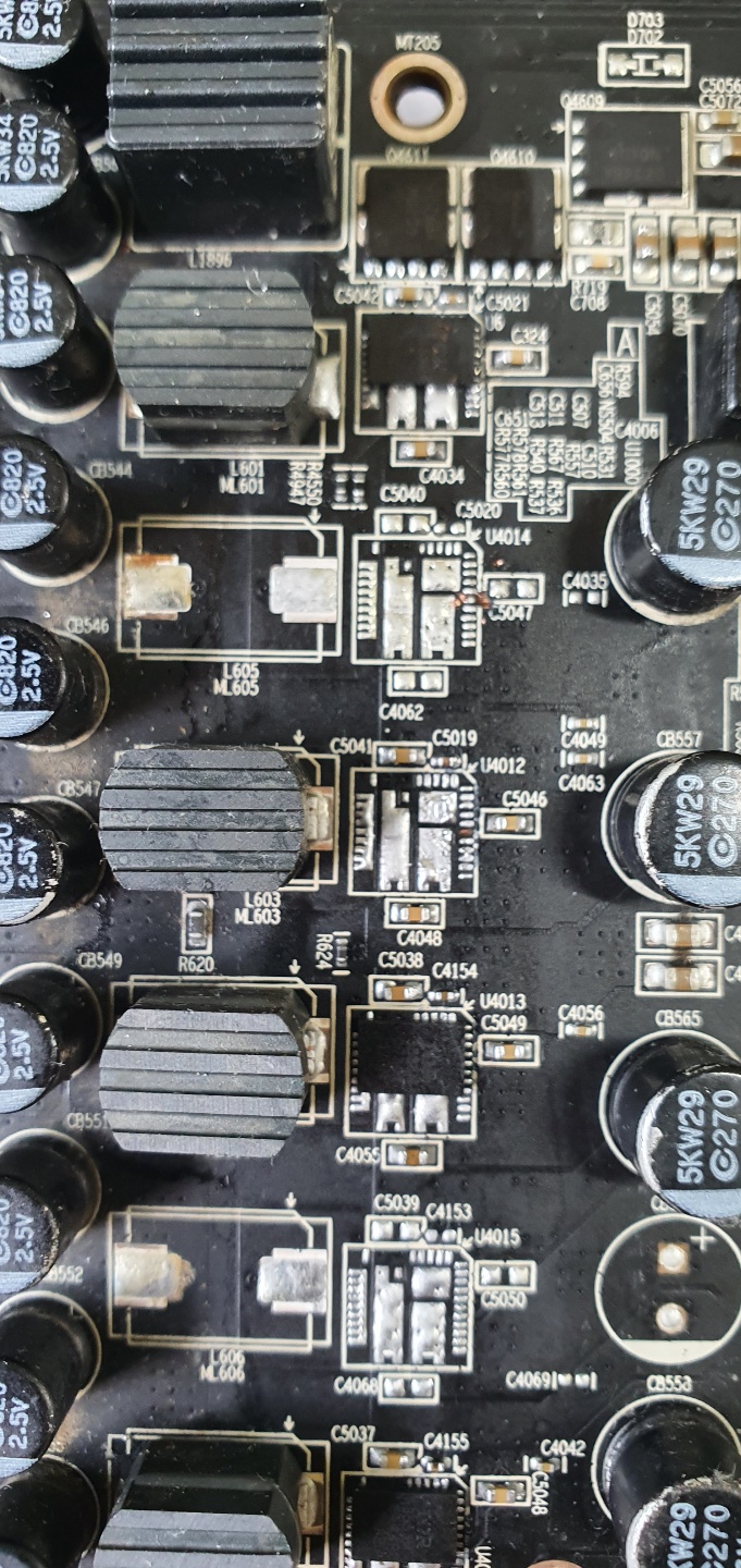

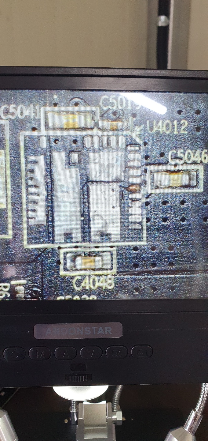

Help me Sapphire rx470
05-04-2022, 02:59 AM
Sapphire rx470 4g
There was a problem during repair.
The pattern has been blown away

05-07-2022, 05:24 AM
Re: Help me Sapphire rx470
What's your question?
By "pattern" you mean pad?

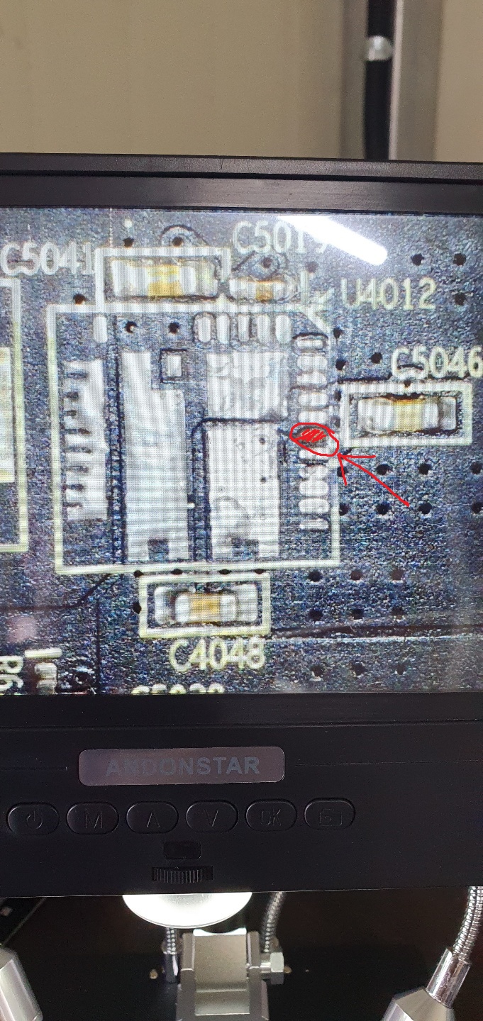

05-08-2022, 02:47 AM
Originally posted by
didi79
View Post
Do not bury the marked part with lead. Electrical signals do not appear to flow either.

05-08-2022, 04:02 AM
If you find the datasheet for that powerstage, you will be able to tell if that pad is necessary

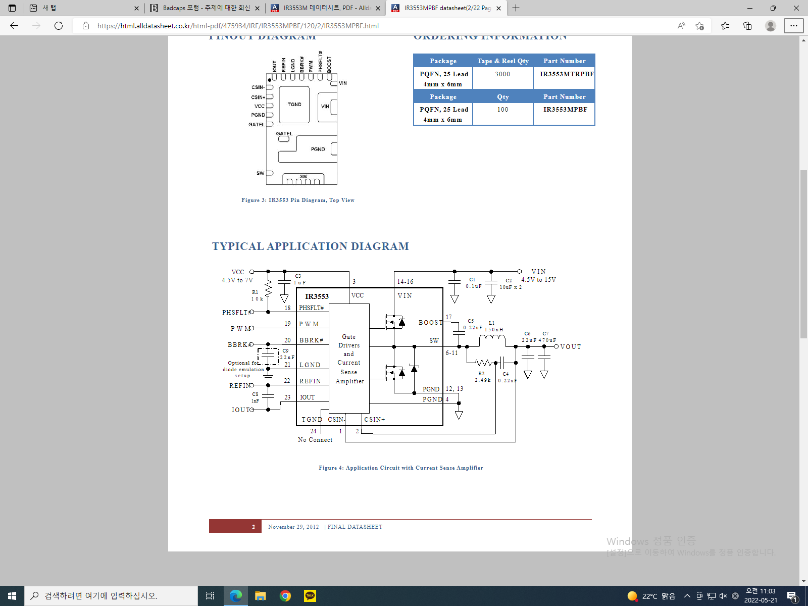

05-20-2022, 08:06 PM
didi79
View Post
This is ic.

05-21-2022, 03:12 AM
LEE SEUNGYONG
View Post
This is ic.
PWM pin is necessary. You should be able to eliminate to what pin on the PWM controller it goes. If you can recreate the pad, you can connect it. Not easy, but doable.
