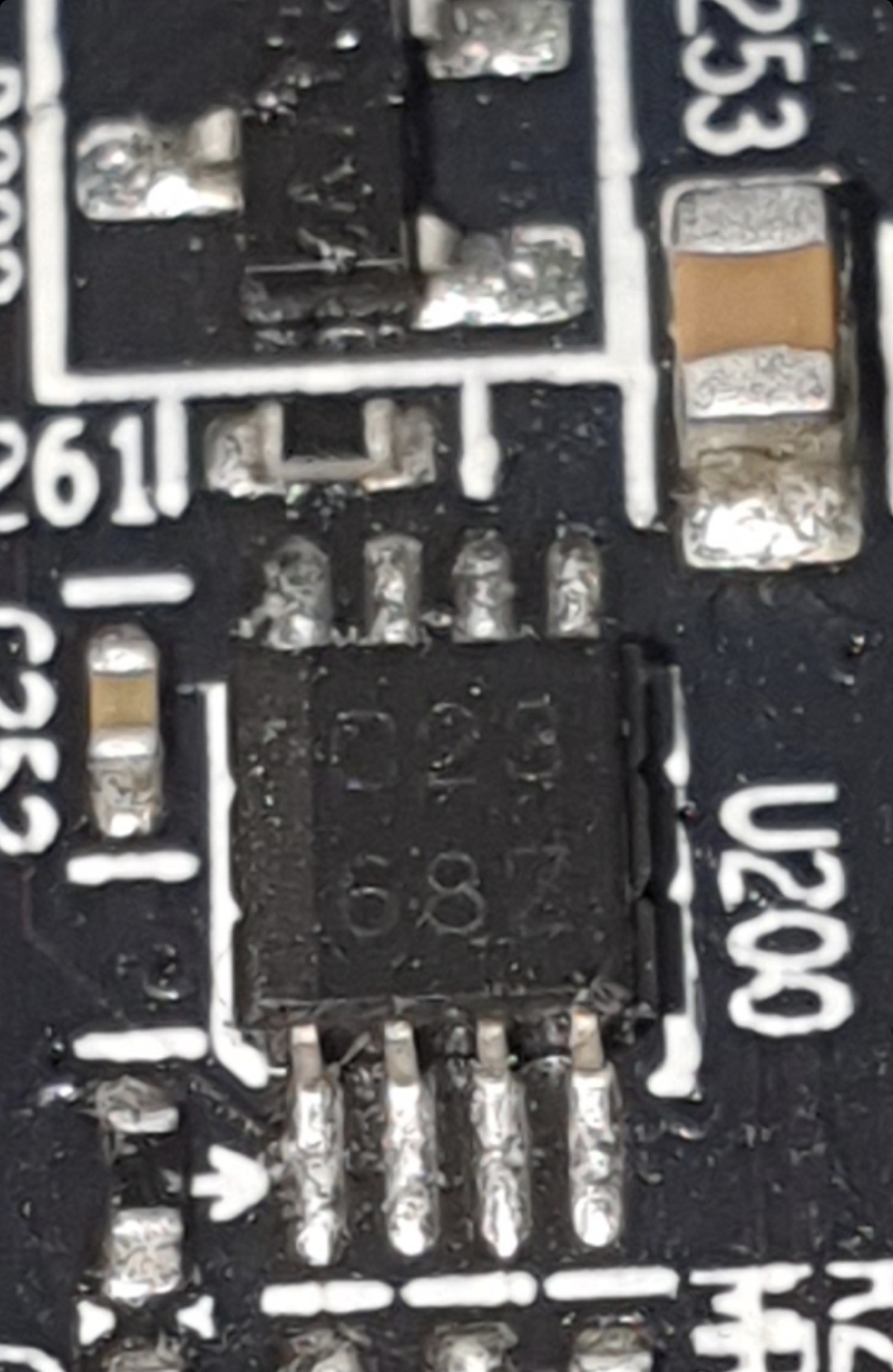

    Can someone tell what part us this?
    C2368Z write on it

      Found, it's SN74LVC1G123DCT

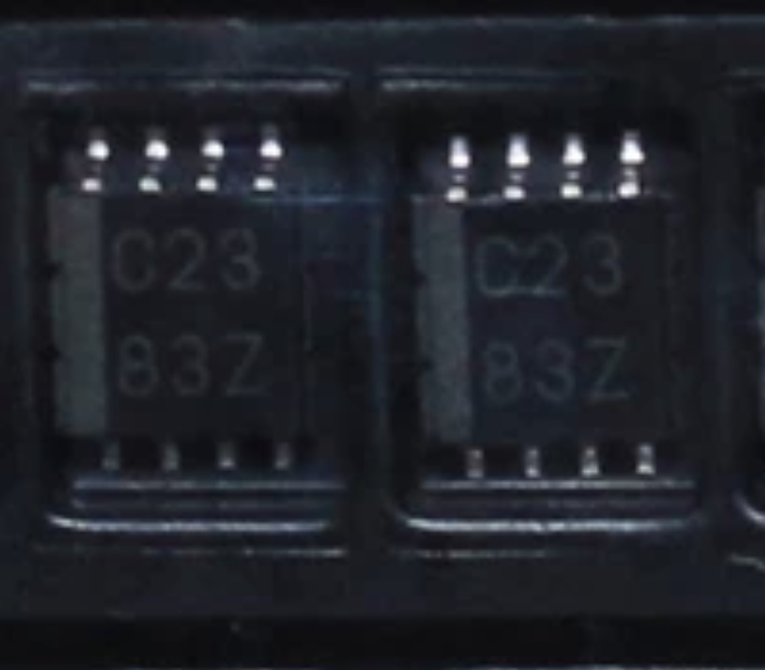

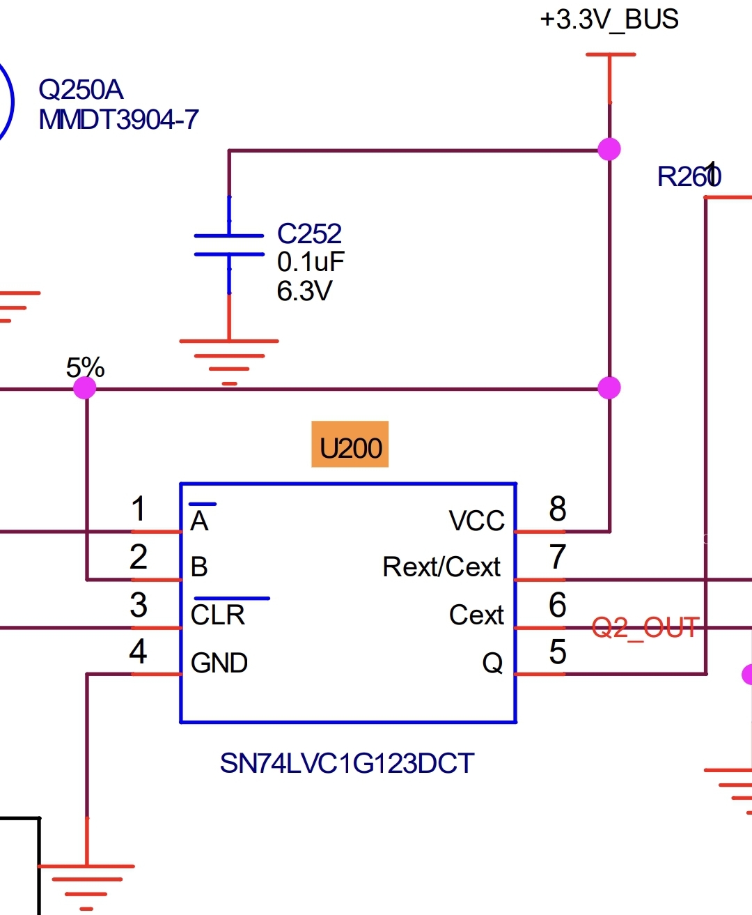

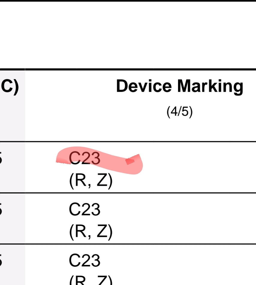

          First I found some sch here on forum rx580,rx470... and by luck when searched u200 part (sch not as mine pcb) but found part SN74LVC1G123DCT, searching this part on aliexpress found part and image on ic C2383Z( mine was C2368Z),then found texas instrument pdf and found that only C23 is marking
          See all image that I was talking
          Cool isn't it?

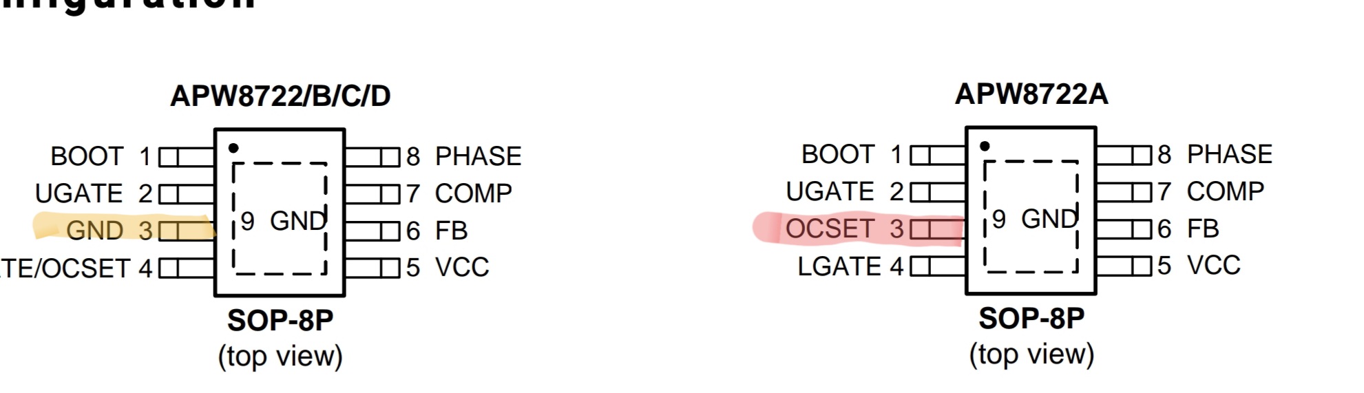

                Re: Sapphire rx470
                As I see datasheet
                they work at diferent static frequency
                APW8722 and APW8722B works at 300kHz
                APW8722A and D works at 600khz.
                My ori is with "A" china seller wrote all numbers but not lives option to choose
                Other seller has option to check with A or without
                Can be this problem why not works to me?

                  Hmm, on my ori ic wrote apw8772a,china is without "a"on the end,but when see datasheet pin3 in my card not connected to gnd,and by datasheet is with extension "a"
                  See image

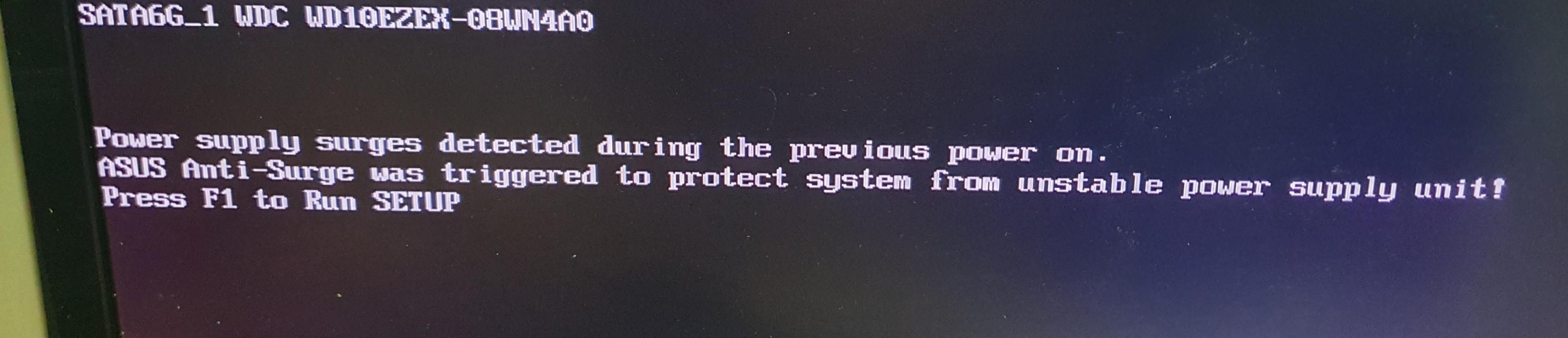

                    Re: Sapphire rx470
                    I found good apw, card detected rx470 but when I try furmark, pc goes off and get message from image.
                    After second try card dead,ir3553 that I change dead again. Just to ask,card has 5x IR3553M, I used 4x because one is damaged pins on board. Can be reason less power to gpu to crash? Actually I used only 4 phases
