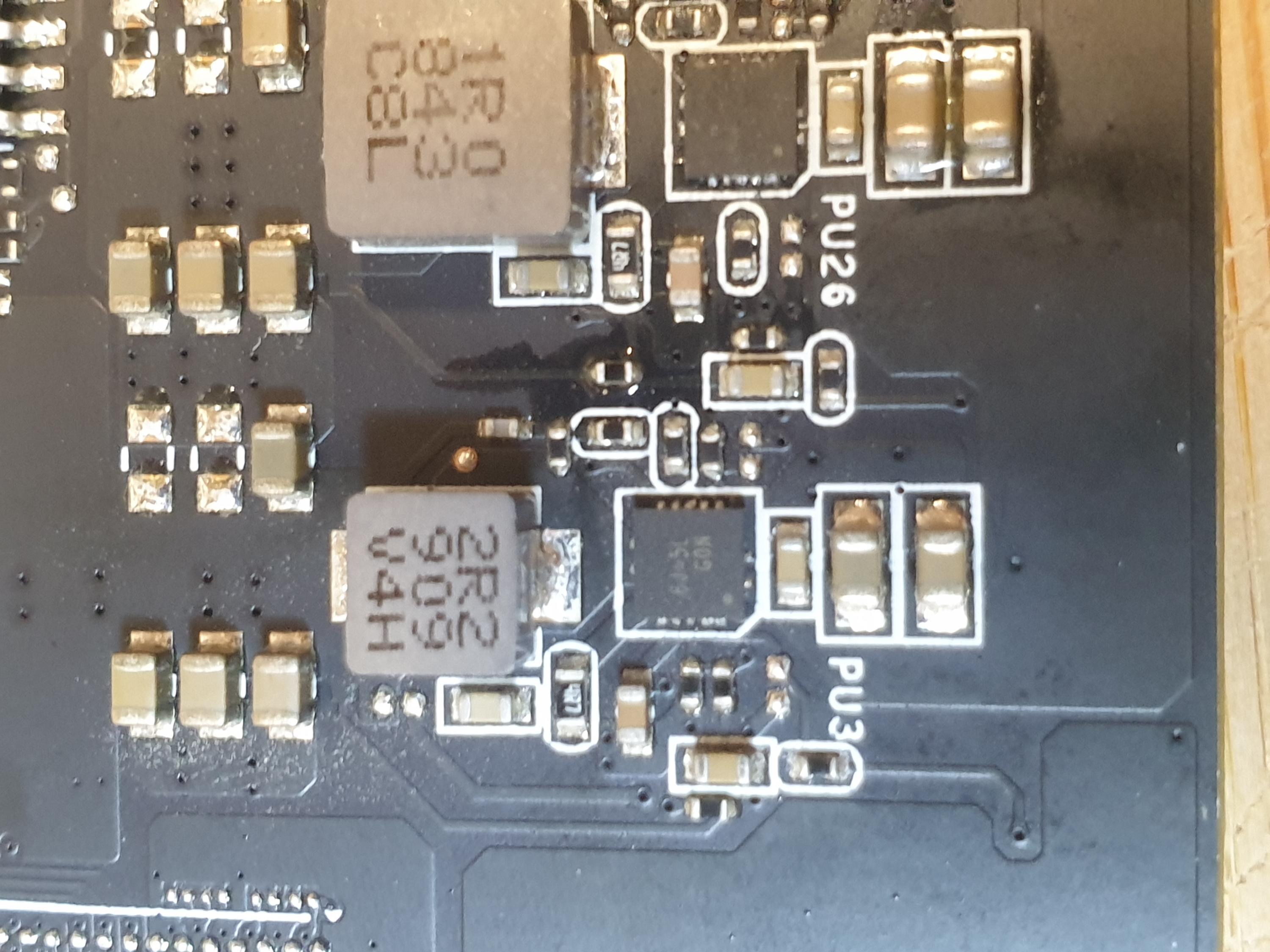

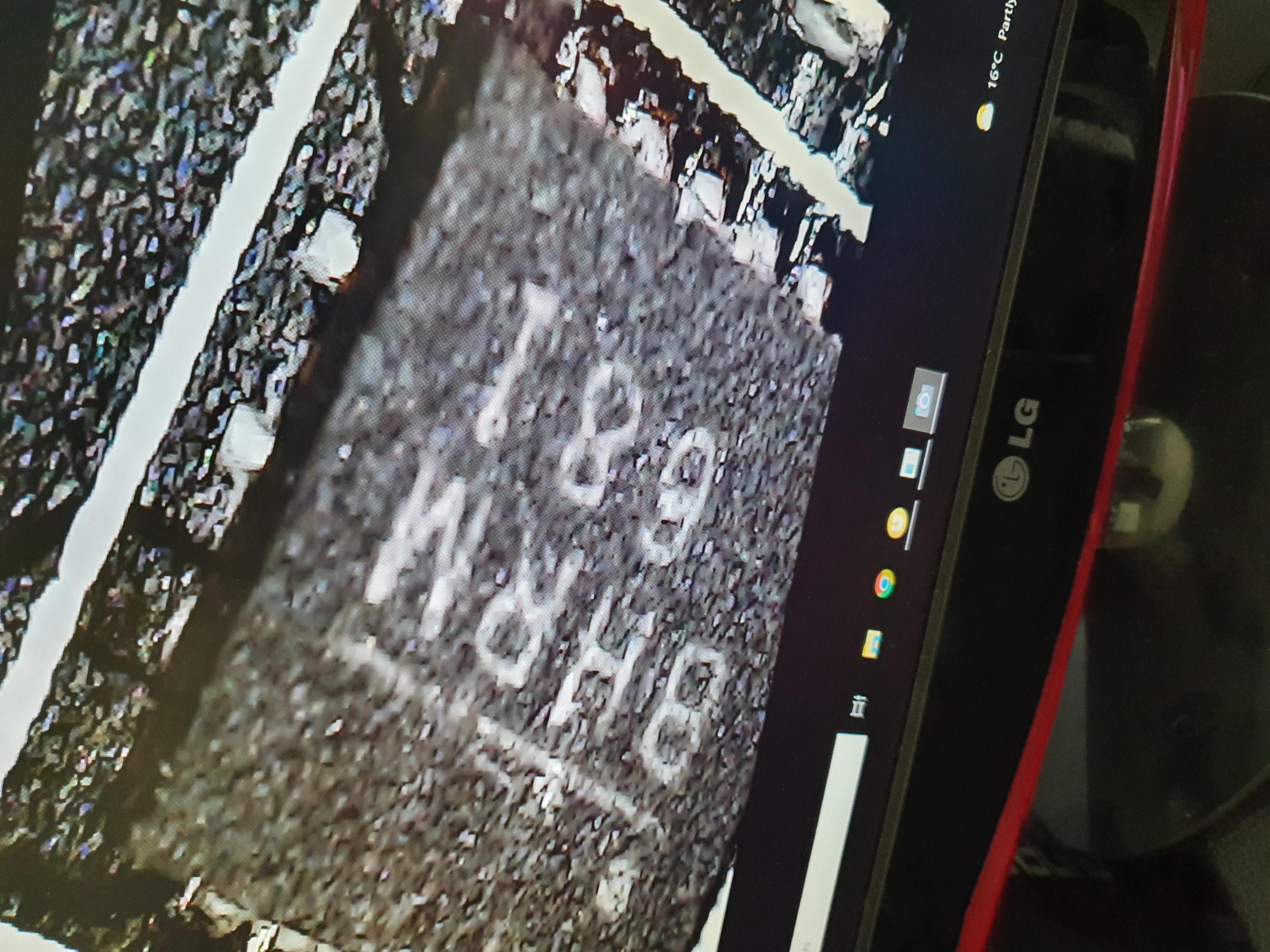

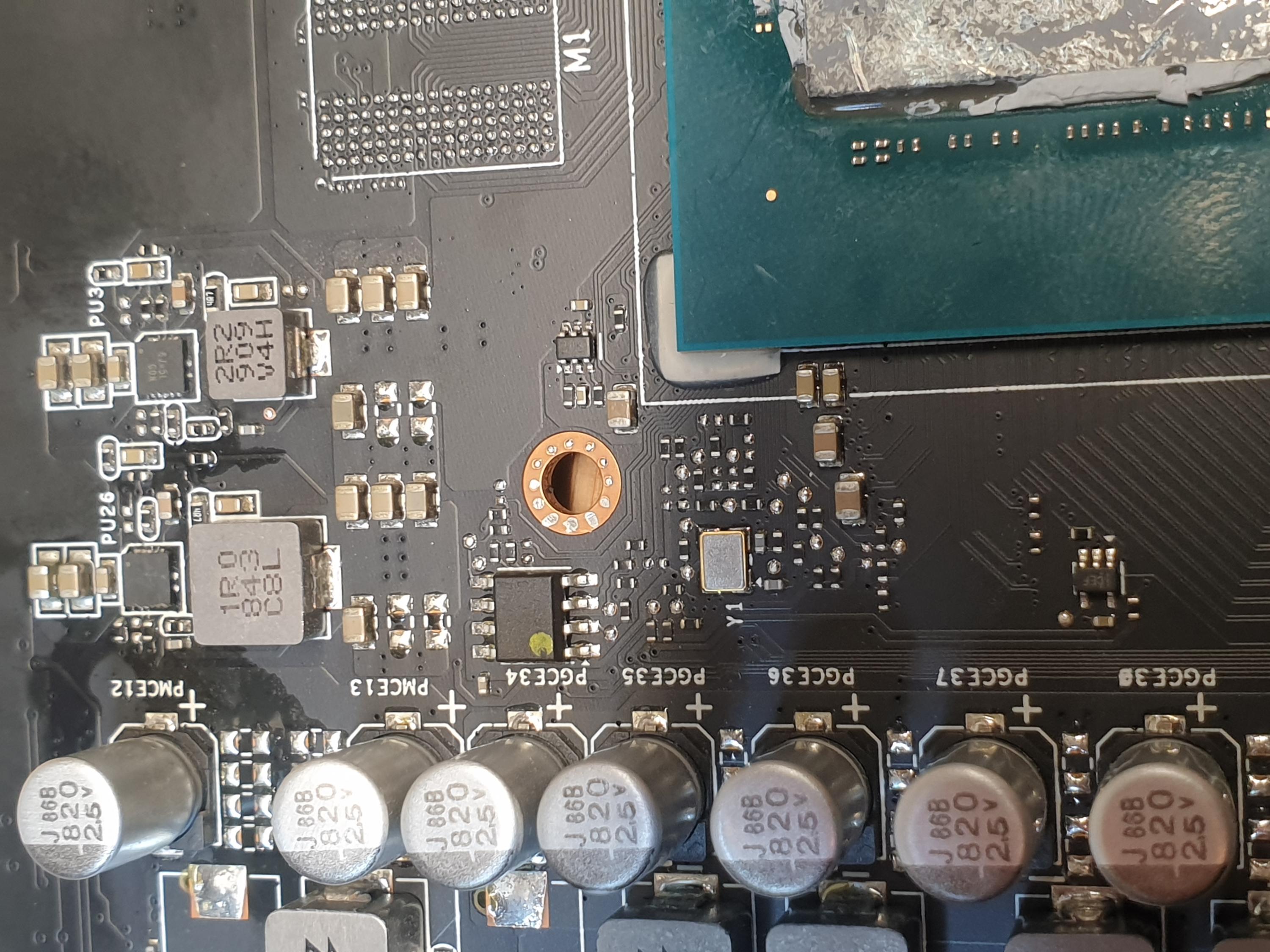

Hi guys i am trying to identify component on an Asus GTX 1660 , component is for pex_vdd pcb name PU26 looks like marking on chip is 6J=5L G0N surface mount
asus GTX1660 super component
Re: asus GTX1660 super component
It could be an RT6220AGQUF
Datasheet https://cdn.badcaps-static.com/pdfs/...6edab631c6.pdf
Parts with an = as part of the marking code are usually richtek IC`s https://www.badcaps.net/forum/showpo...84&postcount=2 -
