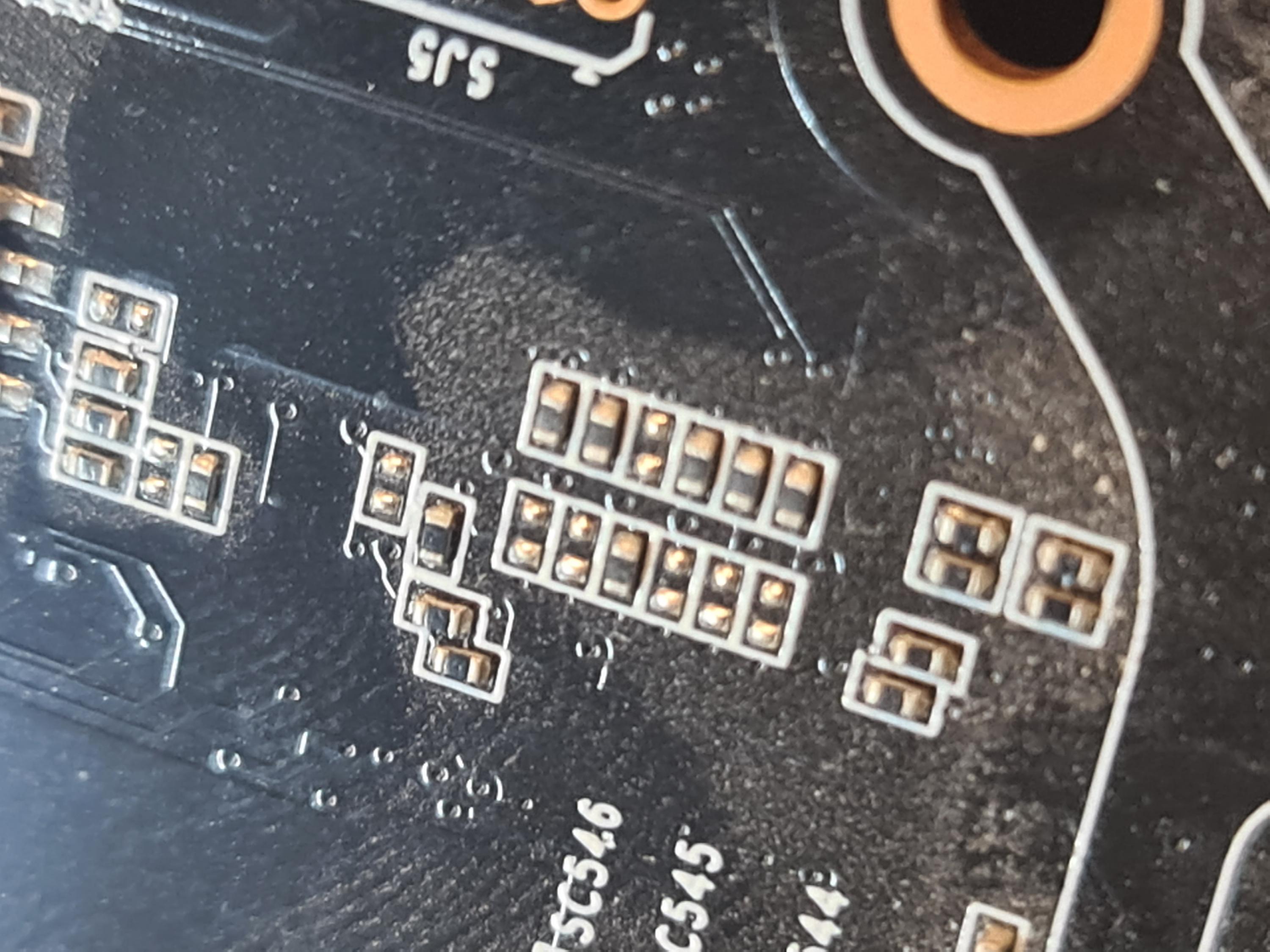

    Hello. Im sorry to not be able to help you but i was just about to post a new question when i saw this thread!
    I have a similar card gainward 1080 jetstream - i think these are identical.
    Now my problem is that it is missing a couple capacitors around the c memory banks which have to be replaced.
    You would not happen to have the tool to measure these? Also i believe these have to be desoldered before measuring.
    image 1

      Image 1 - 1uf 0402 size
      Image 2 - I think is also 1uf 0402 (based on different board, but also 1080)
