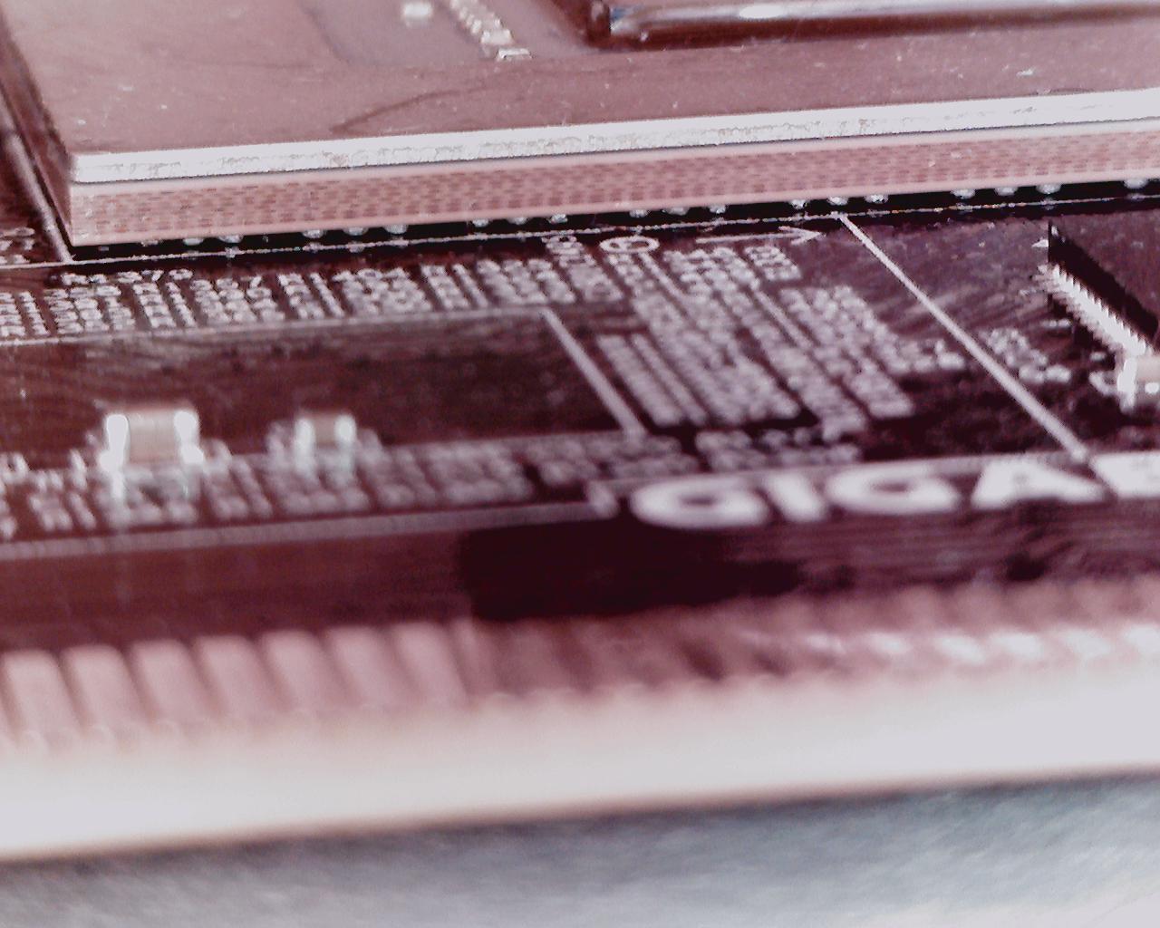

            Ok, powered down and moved the cooler about a bit. Powered up again and no image.
            Reflow needed
            • benwaterson
              • Aug 2008
              • 202
              • United Kingdom
              #46
              Re: Gigabyte Aorus 1080ti - card not initialising #2
              Right then.
              Did a ghetto style reflow on the gpu. Fashioned a stand out of a sturdy box with a hole cut in the top, hot air below preheating the card to 100c. Used some NC-559 flux around the edges of the chip (copy I believe from Amazon, not had any issue with it).
              Tried to follow a reflow profile as close as possible, let the board soak at 100c then used hot air on the top (no nozzzle attached) to bring the chip up to 220c (Quick 861DW set to 380c / 70 air)
              Let it set there for 120secs (moving the heat around, but actually focussing more on the bottom edge of the chip as this is where the lines from the bios come in).
              The upped the temperature and the air speed to bring the chip to 250c for 90 seconds.
              All the flux got sucked under the chip and evaporated, very little clean up to do.
              Let the card cool and popped in the test bench, fired up first go with a picture.
              Need to run some more tests, powering up and down and moving thw card around. Will report back, but looks ok so far and the card hasn't been killed.

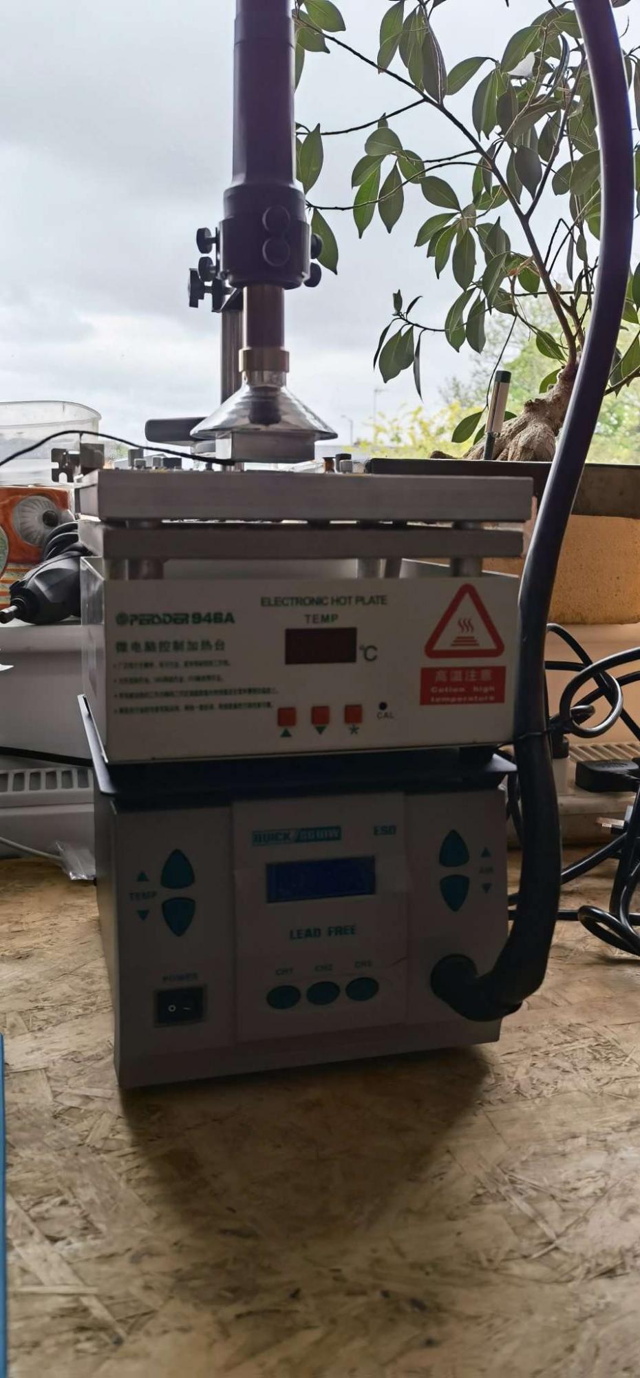

                  In the meantime I have been cobbling together a BGA reflow station using:
                  800w heat plate
                  Quick 861DW with a modified 45x45mm BGA nozzle
                  Stand to accommodate the gun from above.
                  Spent about £60 so far
                  Would like to introduce a PC410 PID thermal controller (https://www.aliexpress.com/item/Digi...2f352e0eAfvX5R) , but don't want to butcher the heat gun.
                  Might get an IR head from aliexpress and use that in the future.

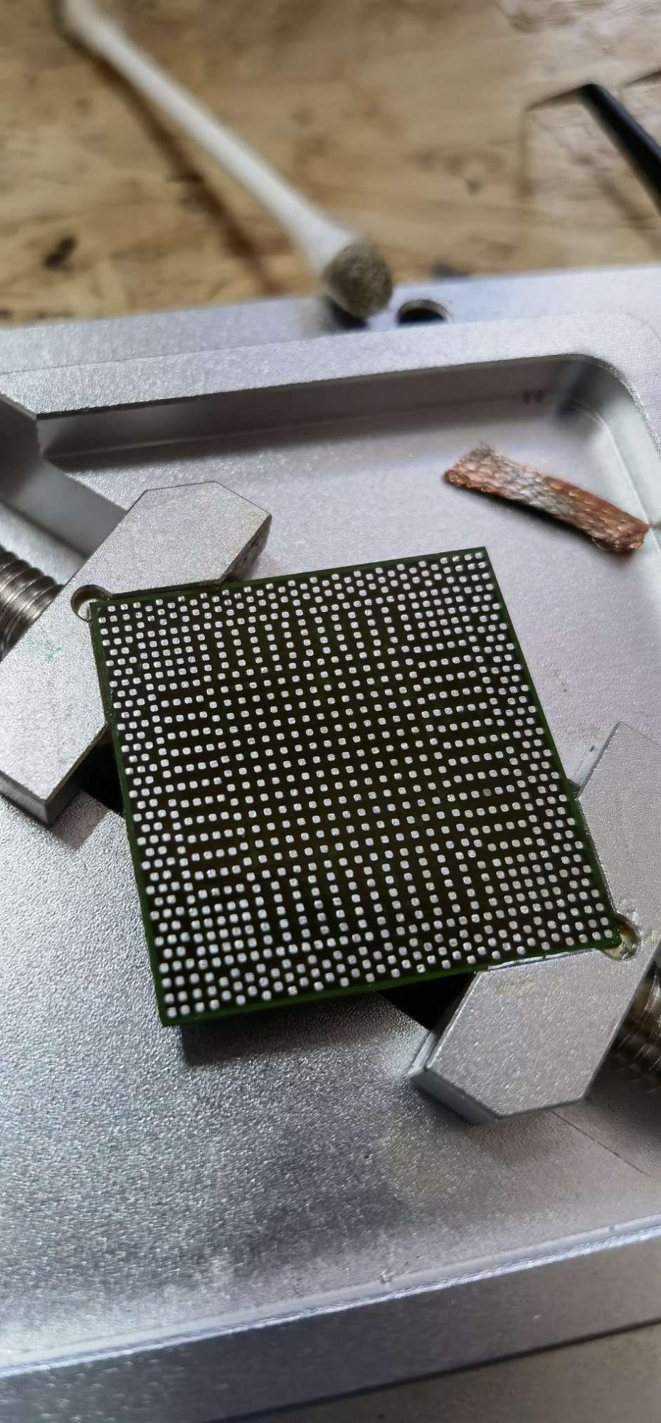

                      Moved back onto the 1080ti - used same method to remove F1 ram bank (without BGA nozzle, just straight out of the gun). Came off really clean, all pads perfect on chip and board.
                      Reballed chip, put on too much flux - went to heat and all the balls moved - doing it again
                      • benwaterson
                        • Aug 2008
                        • 202
                        • United Kingdom
                        #51
                        Ok, chip reballed and reinstalled on board.
                        My "reflow station" made this a lot easier and more controlled. Have both hands free and having controlled heat top and bottom of board made it a much better experience.
                        Popped the card into the test bench (without heatsink) and powered on. Card worked straight away
                        Will reassemble and see if the issue has gone, hopefully won't have to try and either reflow or reball the gpu core (although I secretly want to try and see if its doable with this set up )

                                It's a Persder 946A i got 2nd hand from eBay for £45 + delivery - goes under different brand names. The newer models have a REX C100 PID controller, this is more basic (similar one here https://www.thanksbuyer.com/ansai-94...-station-42399).
                                The thermocouple is from the multimeter and I taped it directly under the chip on the other side of PCB - reasoning was that it would be close to the balls of the BGA but not being blasted with heat from the hot air so when the temperature read about 15c below the reflow temperature it was about right.
                                Bought this stand from Amazon (https://www.amazon.co.uk/gp/product/B094CXMKYQ) which works quite nicely to hold the hot air wand - I just needed to extend the pole at the back that the clamp is attached to and make it a bit taller to give more clearance over the hot plate.
                                Can get some better pics later.

                                    Would be set up a bit like the attached (BGA nozzle is not on straight as just did it quick to illustrate)

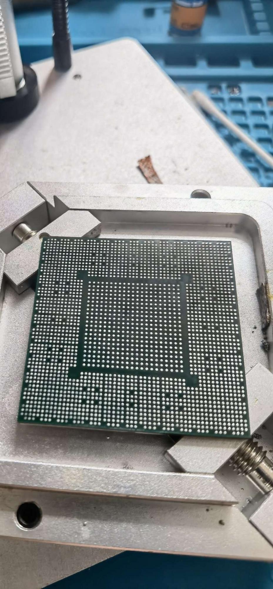

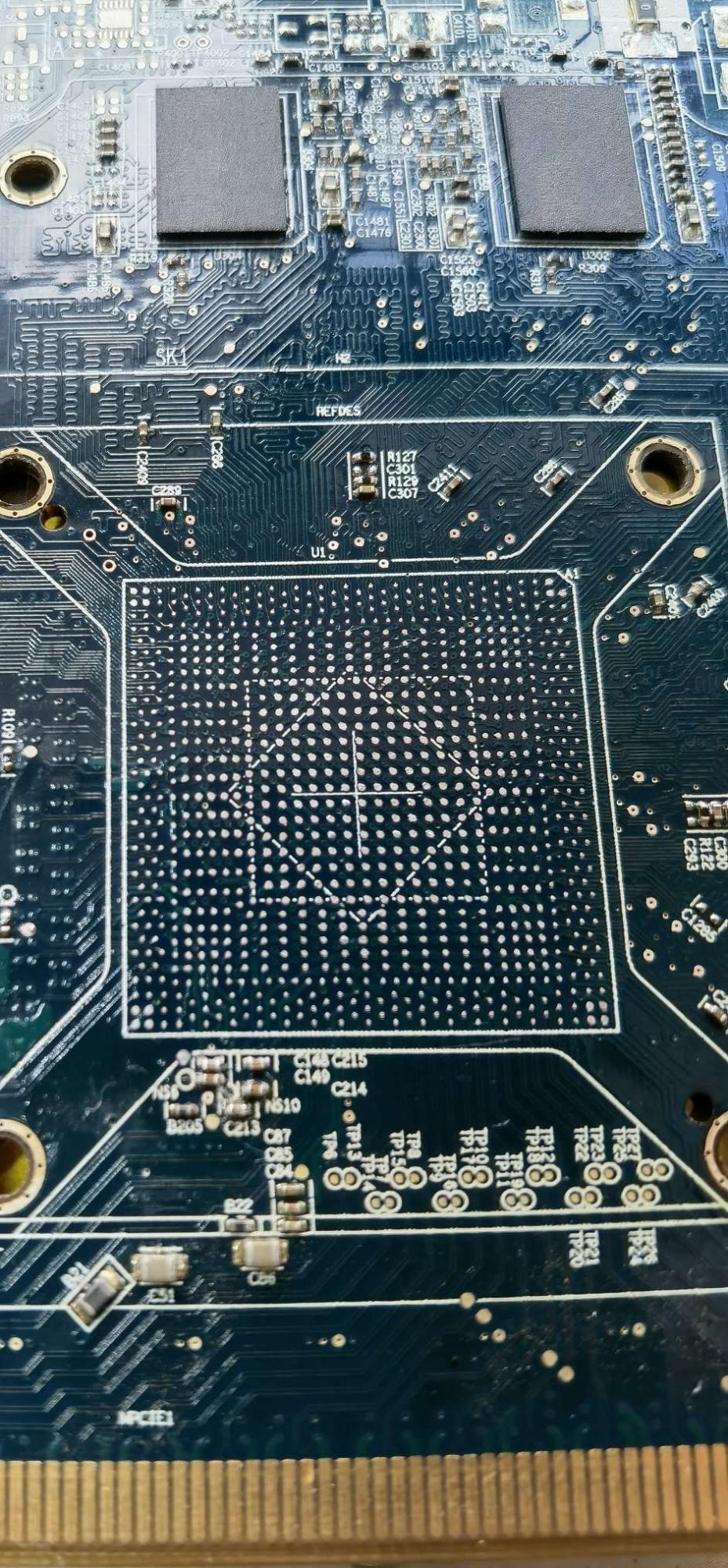

                                          In other news I thought I would see if the "reflow station" could remove a large BGA (ie the GP102 GPU core from card #1)
                                          Seems like it can and pretty cleanly too - had to up the bottom heater plate to 300c and used 385c / 90 air from the top) - chip came off fine.
                                          There is 1 suspect lifted pad on the chip - A52 which is just a ground pin, so guess that's ok.
                                          Still don't know if this chip works fully - any way to test resistances on the pads to determine?
