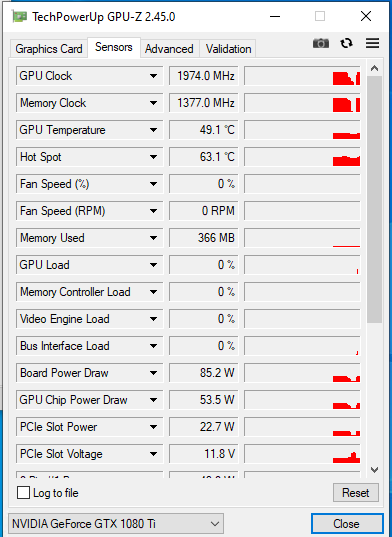

            Installed windows drivers fine, all details are fine in GPU-Z.
            Ran MSI Kombustor stress test for 30 mins with the artefact scanner on with no issues at all, card runs cool and gpu core and ram all run at rated speeds with no issue.
            Will run some Heaven benchmark later, but have no reason to believe there are any issues with the card now.

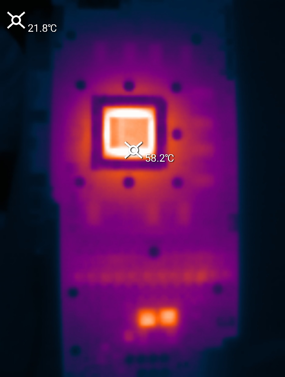

                          Thermal camera image.
                          Hot spots are GPU core (middle) and the chokes for the memory VRM (bottom).
                          Also, 1 of the caps there is hotter than the other.

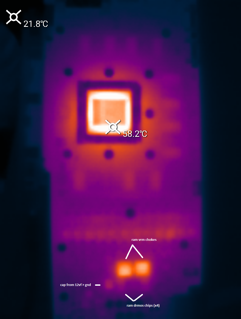

                            Re: Gigabyte Aorus 1080ti - card not initialising #2
                            Annotated the thermal image to label what I am referring to

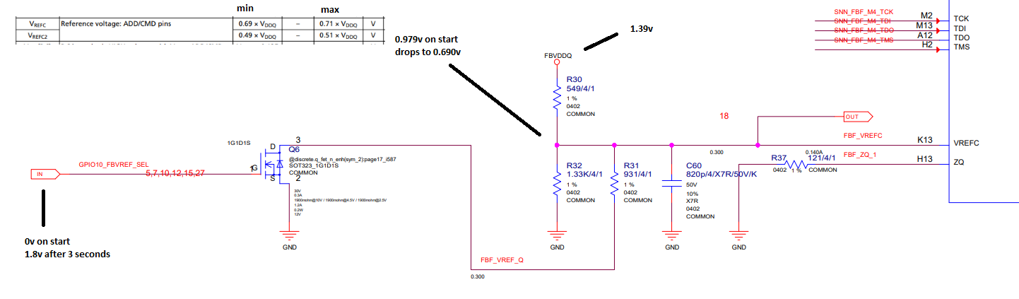

                              Been examining start-up voltage sequences, mainly the VREFC for the ram.
                              For the ram to report write errors on all chips, it must be a common issue that affects all of them (so not a specific chip).
                              This could either be:
                              1) Supply voltage issue to every chip
                              2) Missing initialisation signal / voltage
                              3) Issue in GPU core
                              I have checked the VREFC initialisation and notes are on the attached image. The signal (digital) from GPIO_10_FBVREF_SEL appears fine (this was not pulling high on other card). VMEM (FBVDDQ) seems ok, 18V_AON is fine....

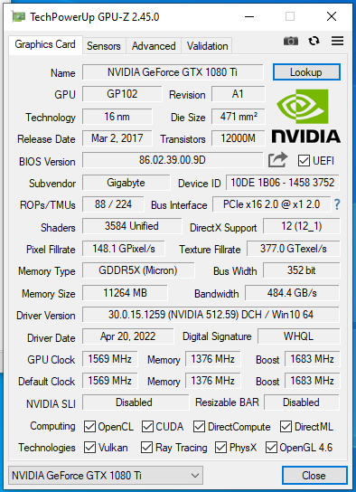

                                          1st boot, had picture but was in black and white and stretched (device manager said device is having problems)
                                          Flashed bios to latest from Gigabyte site - F3P, rebooted and now image is correct. Device manager fine.
                                          GPU-Z screens attached
