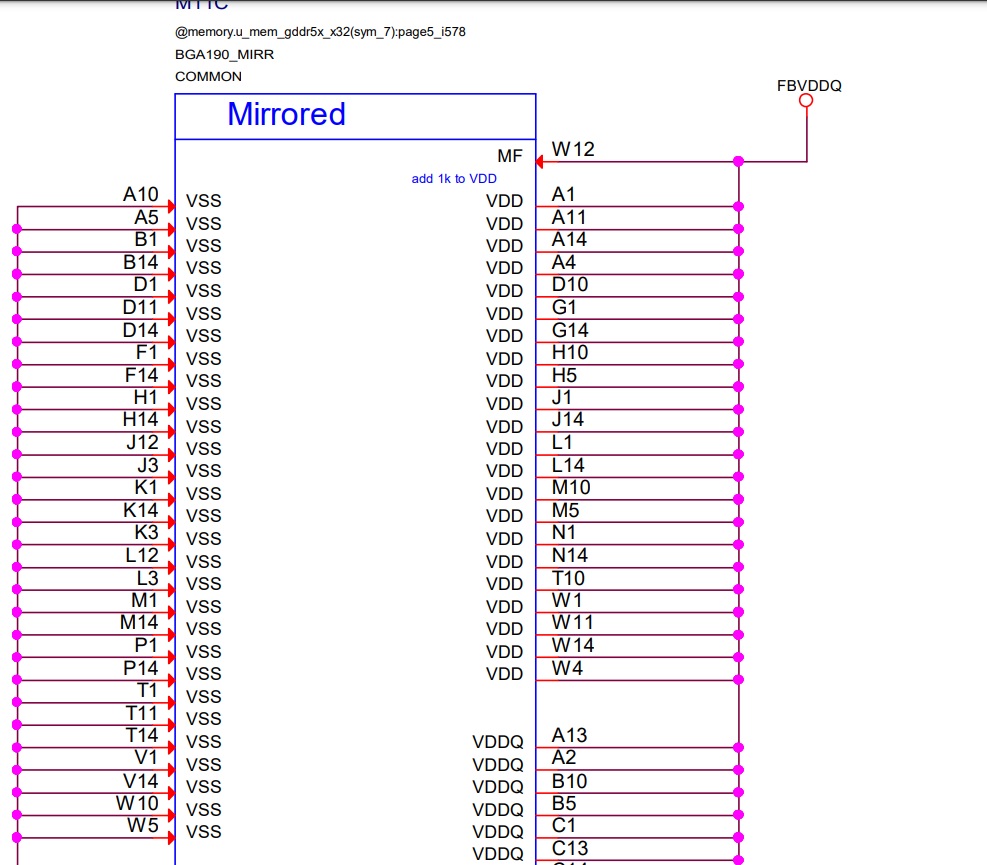

                      • benwaterson
                        • Aug 2008
                        • 202
                        • United Kingdom
                        Re: Gigabyte Aorus 1080ti - card not initialising #2
                        VDD = Power supply
                        VDDQ = I/O power supply
                        Attached schematic image shows they are tied to FBVDDQ
                        • zefrench
                          • Feb 2022
                          • 27
                          You seem to be on to something here
                          Copying from the other thread and adding the new info:
                          Two supposedly new GDDR5X Chips Micron code D9VRL date code 8MA77
                          The resistance of A1 to B1 measures:
                          20.6 K ohms
                          19.5 K ohms
                          The resistance of A2 to B2 measures:
                          50 ohms
                          47 ohms
                                20.6 K ohms
                                19.5 K ohms
                                50 ohms
                                47 ohms
                                Sounds inline with what the resistance should be on FBVDDQ, anything lower than 30ohms on A2 to B2 indicates bad chip - that rail is meant to be 30 to 60 ohms on Pascal cards
