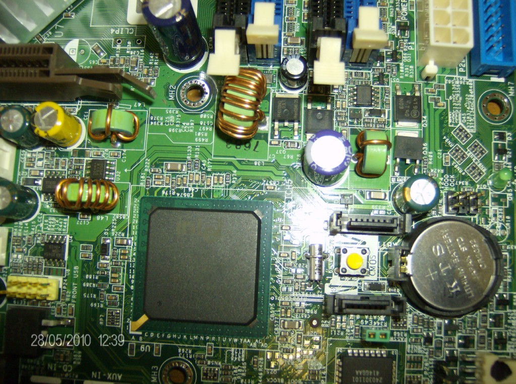

    Hello everyone, I got this board just today... it has the 5vsb led flashing (besides the backup battery). Ive never been able to fix this type of failures, so if someone has any idea, tip, suggestion Im up to it, I see some blown caps I will get done today
    Anything on this boards and failure is wel appreciated.

    replace the teapos and check the PSU (?)
    maybe a short on 5VSB? (PSU cycling on and off bc. of short circuit detection)

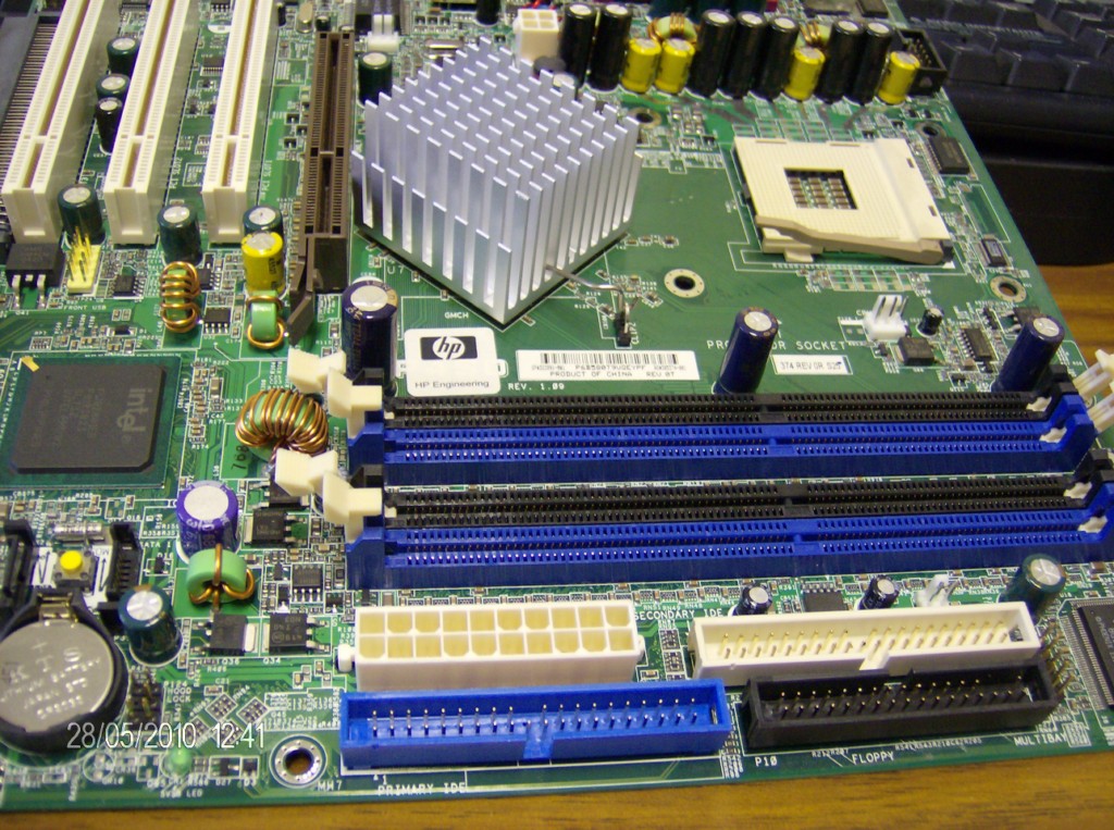

    edit: not good what i see on the 5th pic in the background

      i am recapping but i think i wont be done today, i get off ealier than usual-
      haha the background i hope u mean the datasheets on the wall :P
      those are dead boards I dont even check, theyve been mistreated and have missing parts, like processor's base/pins and such. I use em for cannibalism.
      The PSU is fine, i already checked for that.
      Thanks again for the reply.
