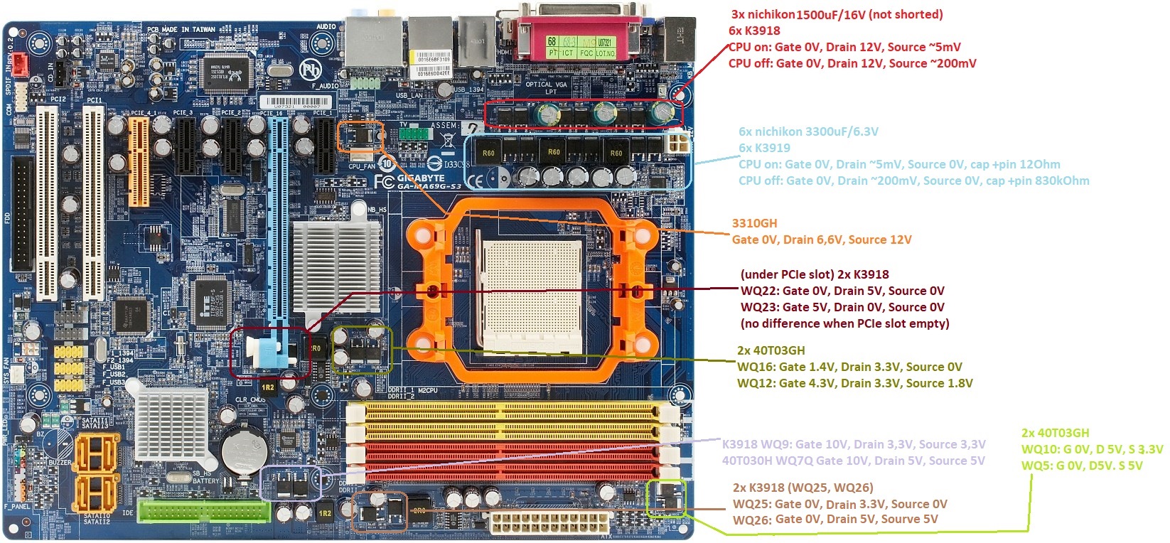

    To the point now. An AM2 motherboard was given to me that it was supposedly misflashed. The actual model is Gigabyte GA-MA69G-S3H. Having a CH341 programmer I managed to flash a copy of the latest bios on Gigabyte's site but when I tested it with the existing Athlon 64 x2 5200+ that had onboard didn't manage to get it to boot. It would power on (CPU fan spinning) and then would do nothing. The CPU, northbridge and southbridge remained dead cold.
    To troubleshoot I replaced the CPU with an 5600+ one and flashed another bios version still to no avail. I also replaced RAM modules and slots and tried both onboard and PCIe graphics card. On every attempt the output was the same. No post at all and no beeping.
    So I start measuring the mobo mosfets. What I came across is demonstrated in the pic.
    Does any of these measurements make sense to you? I hope so.
    I made a lot more but I will not write them down so not to confuse you further but I can make whatever measurement you tell me to since the mobo is on the bench.

    Some additional info. I didn't find any dead shorted capacitor but I have measured low resistance in the + pin of the electrolytic capacitors around the CPU (the 3300uF ones) and the SMD capacitors on the back of the CPU socket. (around 13 and 23Ohms with the CPU on).
    I also measured the SMD capacitors on top of northbridge and southbridge. None was dead shorted but a lot of them had 0V on both their sides.
    Is there any hope?

          Taking again a look at my measurements there seems to be no Vcore around the mobo. The only voltage near Vcore is on the WQ16 mosfet (40T03GH) below NorthBridge.
          Shouldn't have I measured Vcore on the 6 K3919 above socket? AN if so why there is no voltage there?

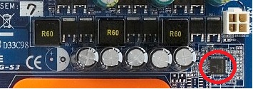

            I noticed that near the 6 K3919 mosfets there is a ISL6312 chip that is described as a "Four-Phase Buck PWM Controller with Integrated MOSFET Drivers for Intel VR10, VR11, and AMD Applications".
            Can this be the culprit for the absence of Vcore? Watching this video and of what I can understand, this can be the case.
            Any thoughts?

              The VCore voltage will be switched on by the EC (super I/O) after a certain stage in the boot process. The ISL CPU power should be enabled through the EN (pin36). Can you check the voltage at EN should be close to 1v after some point in the boot?
              Also the VID0-7 should set the digital selection of the voltage, you can try them also. For intel CPUs it should be pulled up by default and the processor during its operation should drive them as needed.
              Also check the voltage to the ISL chip (5V and 12V) and do extra care for probing the pins. I usually use a small sewing needle to get access to the contacts.
              Before the processor boots power should be present in:
              Super I/O, BIOS chip, RAM (DDR3: 1.5v, 0.75v, 3.3v), PCH (multiple rails) and depending on the design a few other things. Vcore is usually the last thing to power up.
              Also probe the voltage after seating the RAM and CPU, of course carefully.
