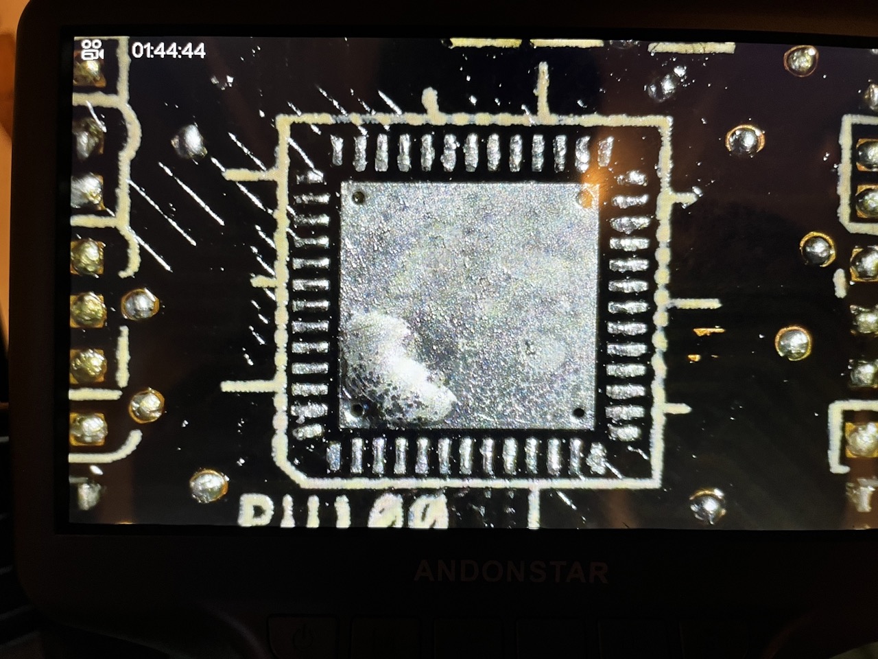

      Re: ASUS Expedition Radeon RX570. ASP 1106 pinout
      Thanks for the quick reply.
      This was also the information I found online.
      But what stumped me is this: According to the Realtek website here:
      https://www.richtek.com/Products/Vco...e/RT8894A.aspx
      RT8894A is a 56-pin device. But the controller on this card is a 52pin device.
Name:	IMG_0386 Large.jpeg
      Is my understanding somehow wrong?

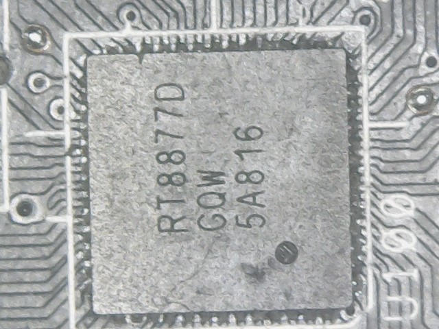

          one of the ASUS expedition 570 i have has RT8877D its a 52 pin, the other one has the same as you Digi+ EPU. ASP1106
