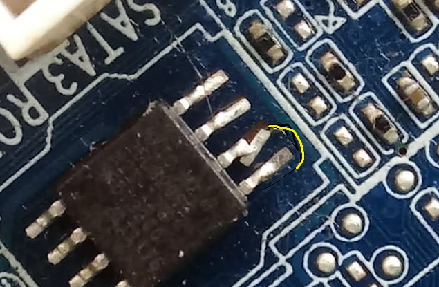

Help me broken bios track
    bios track number 6 has been broken

    The picture is too small.Post a good clear picture of the actual board with the damaged area ,and the motherboard model number .
      Motherboard h61h2 or 15-y90-011003 board model

        Scrape some of the solder mask away until you get down to the copper.You can see where the trace is going, just solder on a small wire
