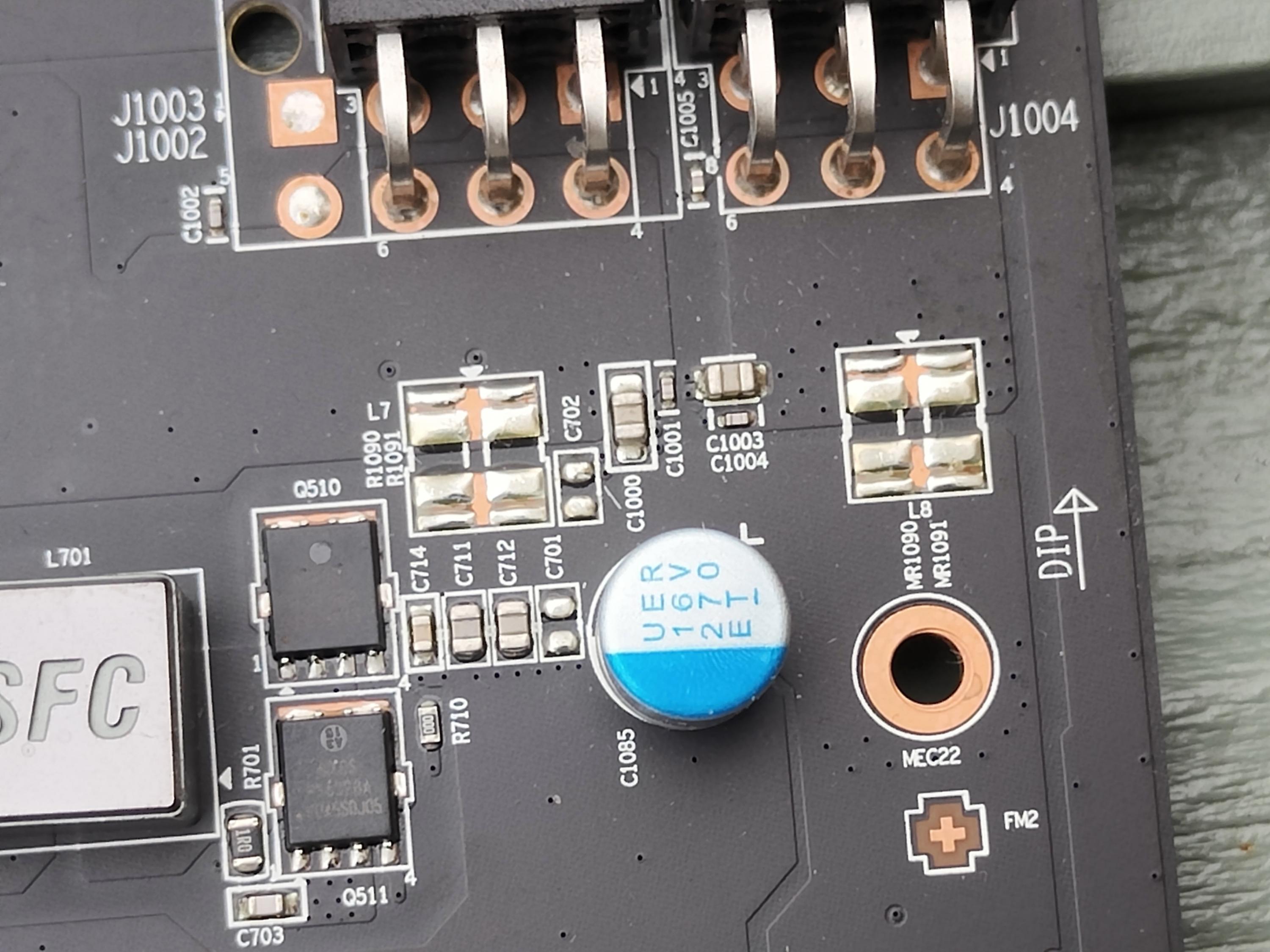

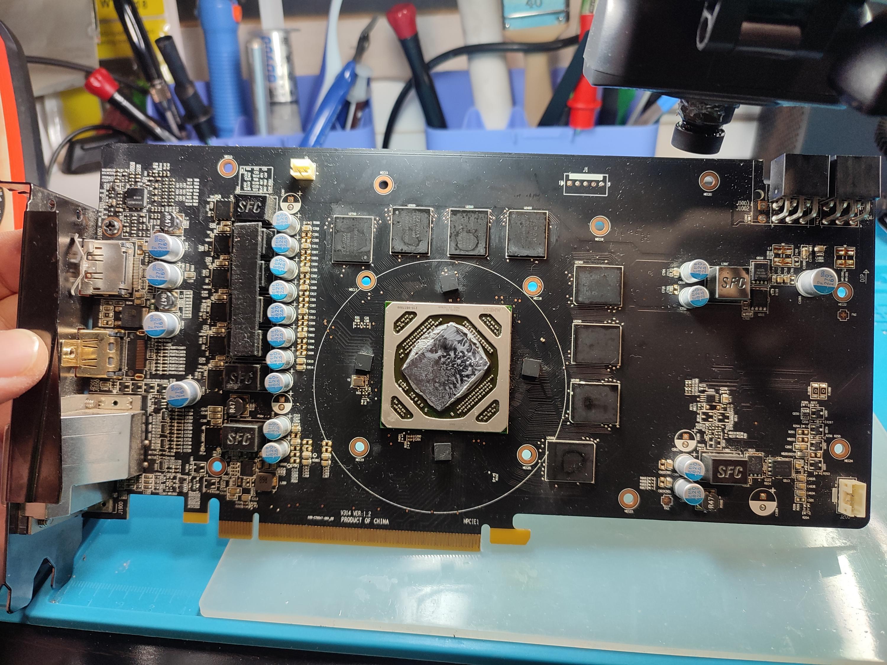

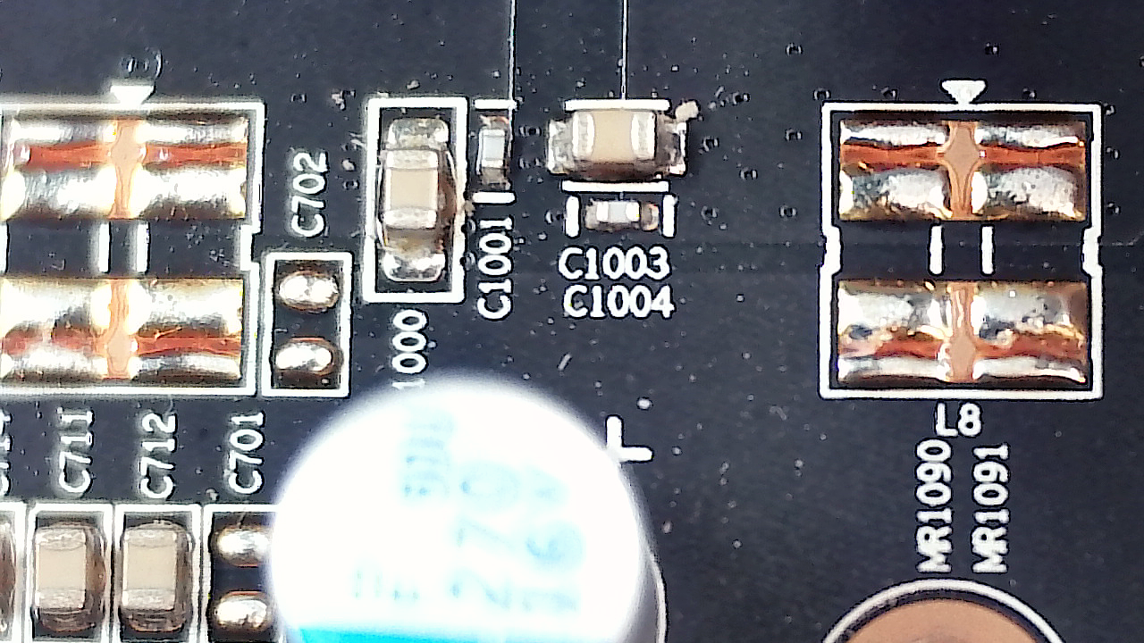

    MSI R9 380 4GB 12V resistors or fuses not populated???
    Hi, I have this card with the fuses, resistors or whatever they should be not populated from factory, maybe the seller scammed me or im comming crazy, but as I can see, there never where something there, have a look, what do you think?
    More fun comes when I saw a Dicky96 video with same card and he meassured the 6pin fuses (the ones im talking about) and he finds that they are open (but as far as I can see there is nothing there, just pads)
    Does anyone has same card??? schematics says they should be there.
    Link to LER video (very thanks for all your videos and info Dicky) See minute 8:00
    https://www.youtube.com/watch?v=ncsZsPdXnl8
    The card shows artifact green line but pc doesnt post beep

    Re: MSI R9 380 4GB 12V resistors or fuses not populated???
    Mine doesn't have them either, nor does it work, haha
      Thats the funny part, they seem not to be populated form factory, aux 12V goes to other places but not important, still testing it with tserver
