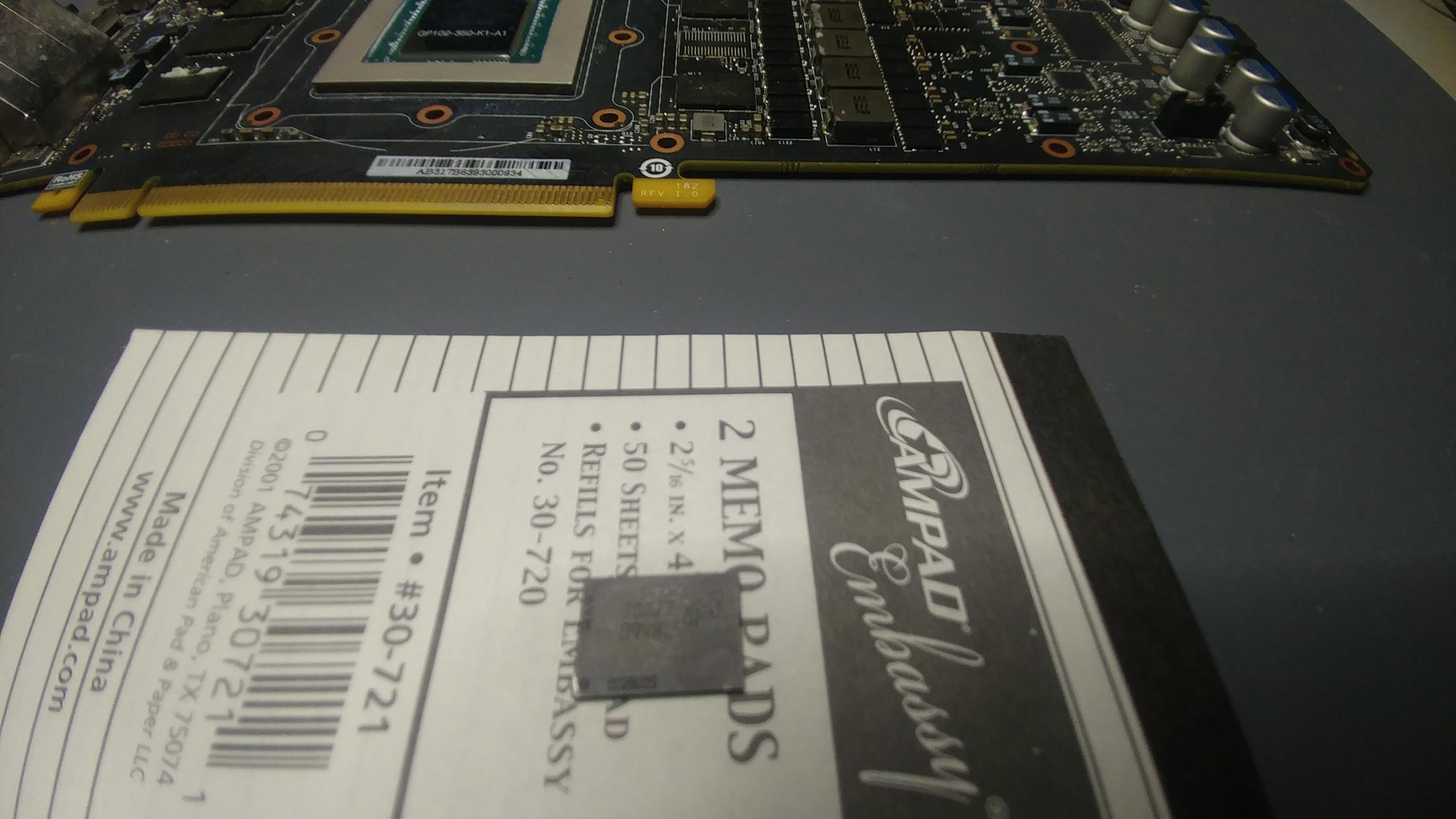

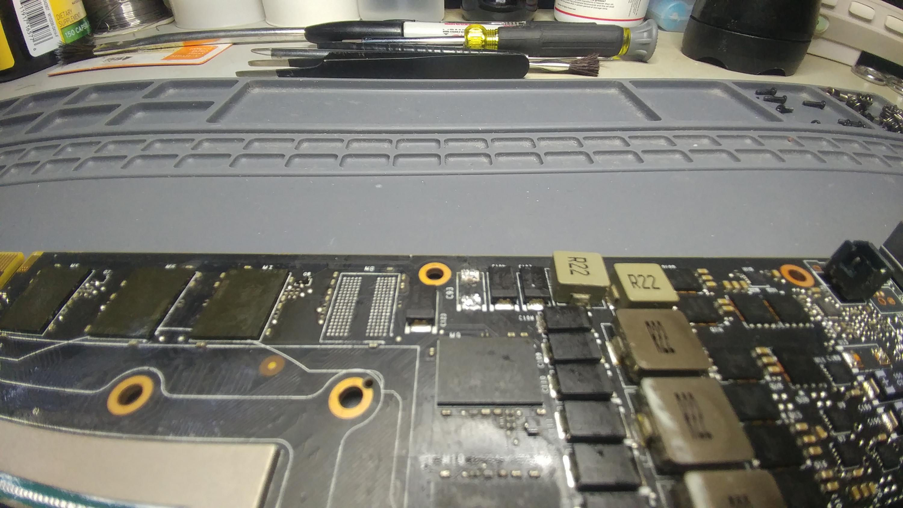

        Re: EVGA GTX 1080 TI Issues
        Ran MATS on the GPU,* It came back as a failed memory chip at Bank C1. I have removed the chip and I'm now in search of a new one. (part Number D9VRL) It's a Micron BGA 1Gb Nand Flash Memory. Will update after I find replacement part.* *
          To go sure not to waste money, you might reball the mem chip you have taken off, and resolder it, theoretically it can be also a noncontacting pad.
            I'll give it a go, since I'm not having any luck finding reputable supplier for the chip yet.
