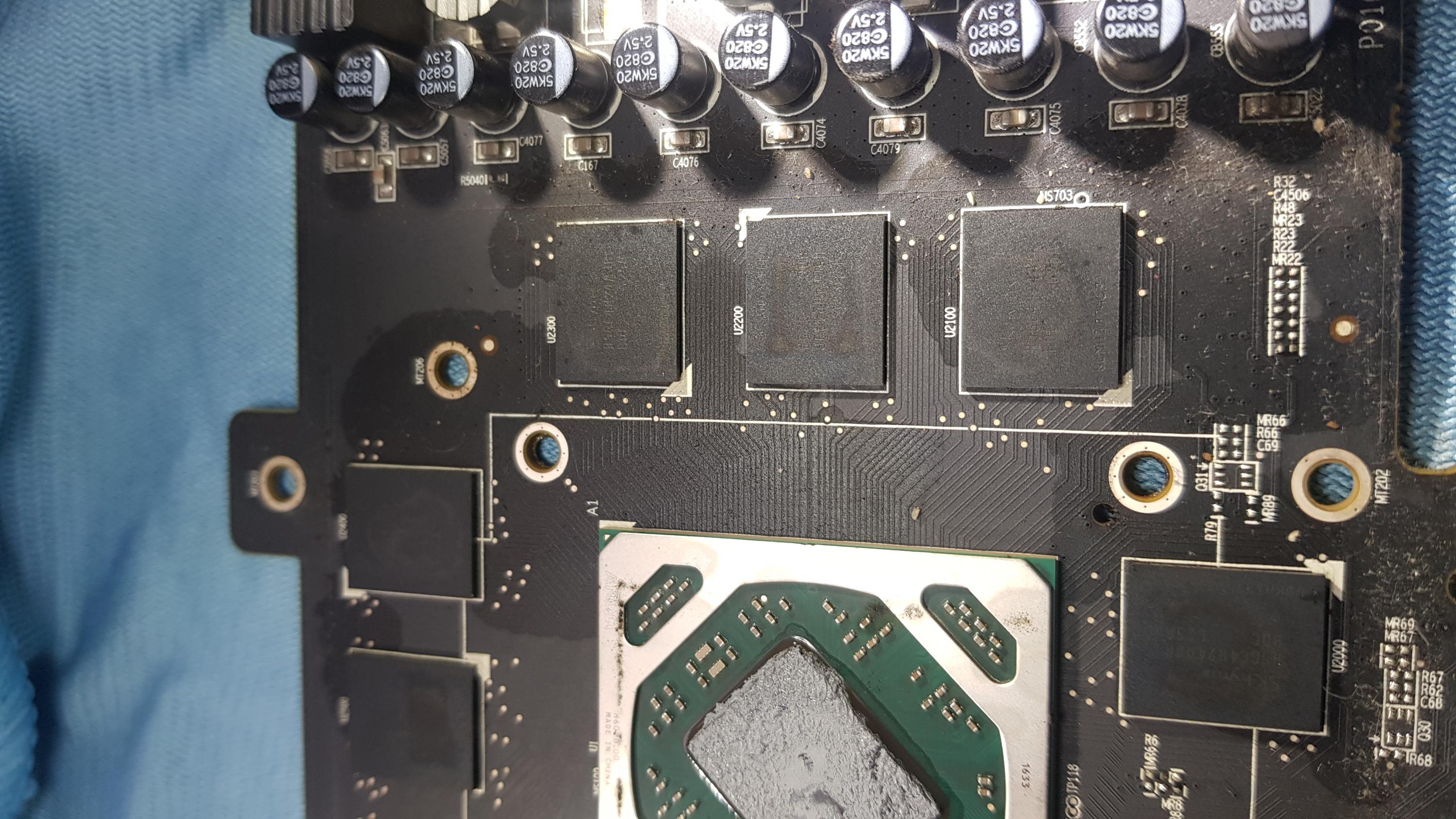

    Hello to all
    I got a RX 470 4Gb and of course I did my tests before powering it up 🙂 and I could notice some kind of liquid running under the memories .
    Big cleaning was necessary before anything else.
    What I could find and change
    2 Fuses 10 A at the input of the 12 Volts connectors
    1 capacitor for the row of 12 Volts HS
    No more short circuit on the 12 V or elsewhere

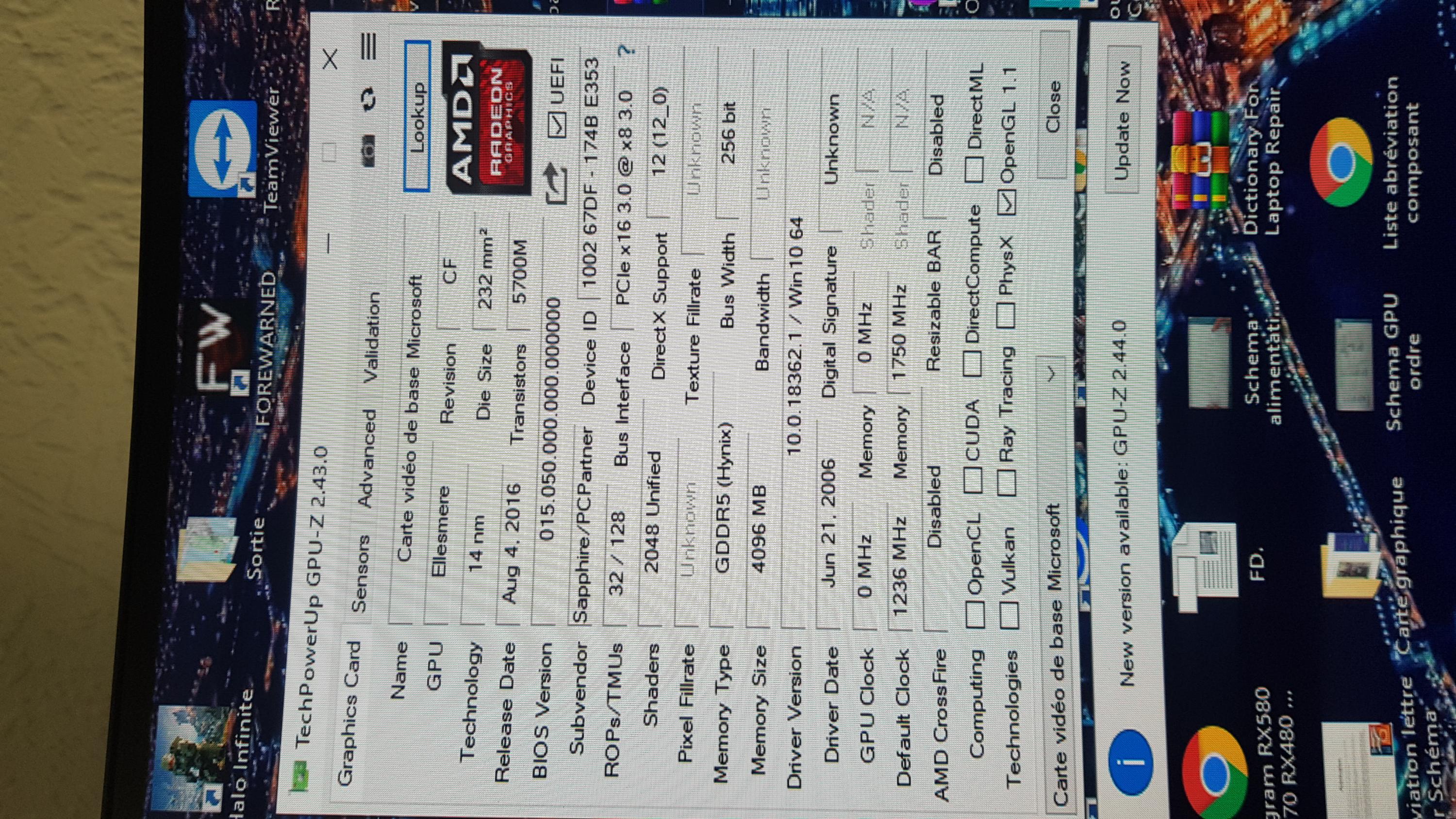

    So the card starts well but only in HDMI with a maximum resolution of 1024 or then choice 820 .Display port not functional
    CPU-Z software detects an AMD radeon with its 4 GB ram and its GPU
    But in pixel Filrate and texture Filrate = unknow and pci express in x8
    My card seems to detect the card but indicates that it is a microsoft base video card.
    The impression that the gpu does not dialogue as it should.

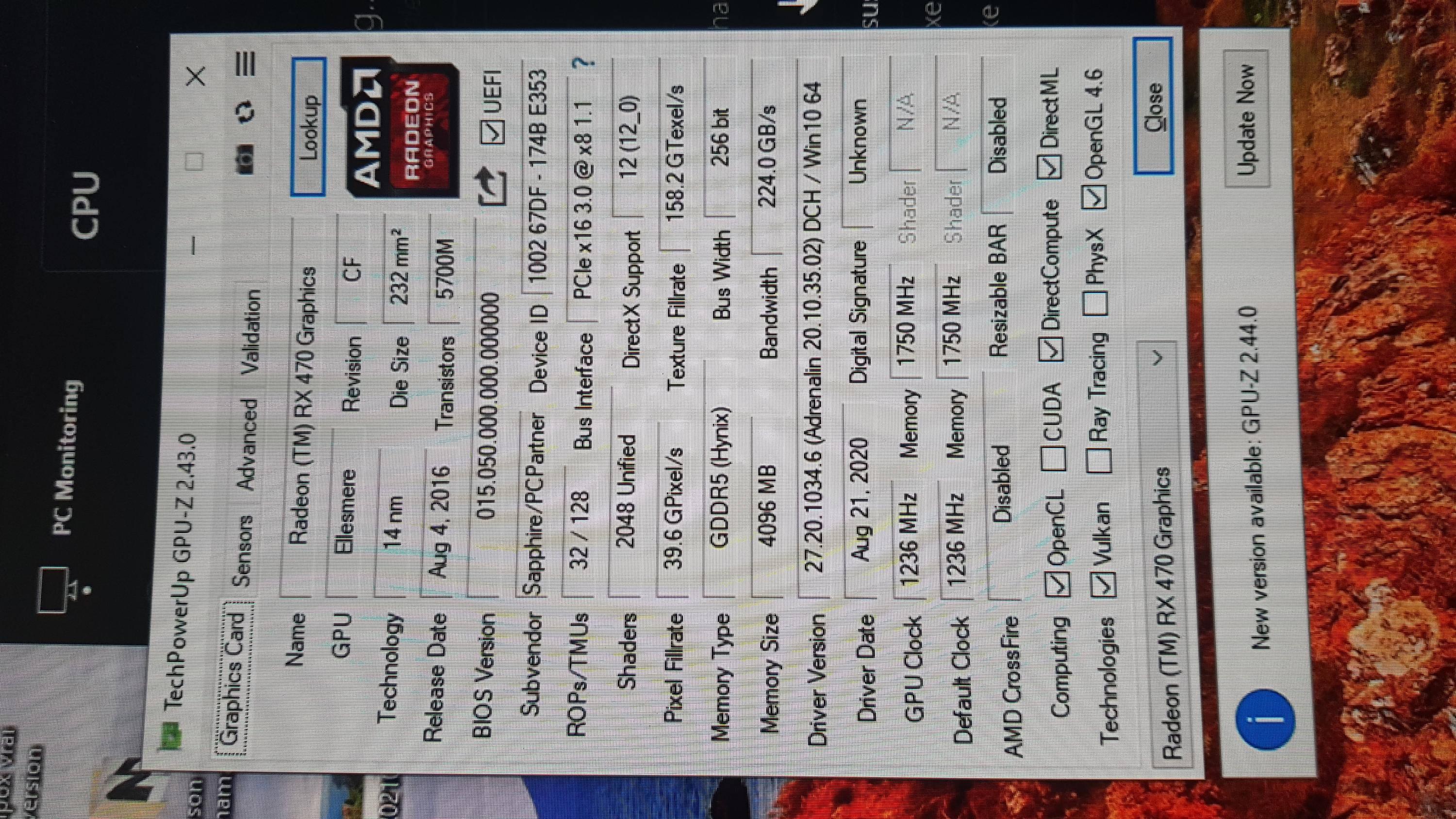

    Hello everyone
    I come back to you with new and evolution. Then another problem comes =S definitely bad luck's fault.
    So after reprogramming the bios with the programmer and with the latest version 015.050.000 ect.. which is on the site https://www.techpowerup.com/ and I disabled the card in device manager then clicked on installation.
    The card is detected again and the resolution is 1920x1080 again ok cool
    Except that for a moment the ventilation stops after 2 min then the pc freezes at some point. And the same with restarting windows.
    After deactivating the card in the device manager, the card resumes its ventilation and the computer no longer crashes.
    And once installed again it crashes the system, forced to disable the graphics card.And as you can see in BUS Interface there is PCI Express 16 3.0 @ X8.1.1 and should be Express 16 3.0 @ 3.0 normally
    So here I am lost
    Do you think I should revert to the old version of the BIOS or do you have a power problem somewhere?
    Any ideas?

      Test the card under load, AMD cards (contrary to NVidia) fall back normally to PCIe x1 when no load present, nethertheless x8 is strange. Bios could be the reason, try to find more bioses, maybe on the vendor site are some. If you find an update .exe file, no Bios file, you can try to extract the Bios from the .exe file with 7-zip or Winrar (Yes, it can be done) and program it directly on the card with CH341 programmer (be careful, some of them must be modded as they destroy 1.8V chips due to too high supply voltage by design, instructions can be found in the net). I recently extracted so all bioses for an Asus GTX1070 card.

          Re: RX470 4GB - maximum resolution of 1024 or 820
          Rectification and success solved it seems for this card =D
          For information, I flashed with another BIOS version via the AMDFLASH software and uninstalled NVIDIA drivers that were supposed to cause trouble.
          I'm not sure if it's a good idea to use a different version of the BIOS, but I'm sure it's a good idea to use a different version of the BIOS.
          The card goes up to no more than 53 degrees
          Thanks a lot if this helps some people =)
