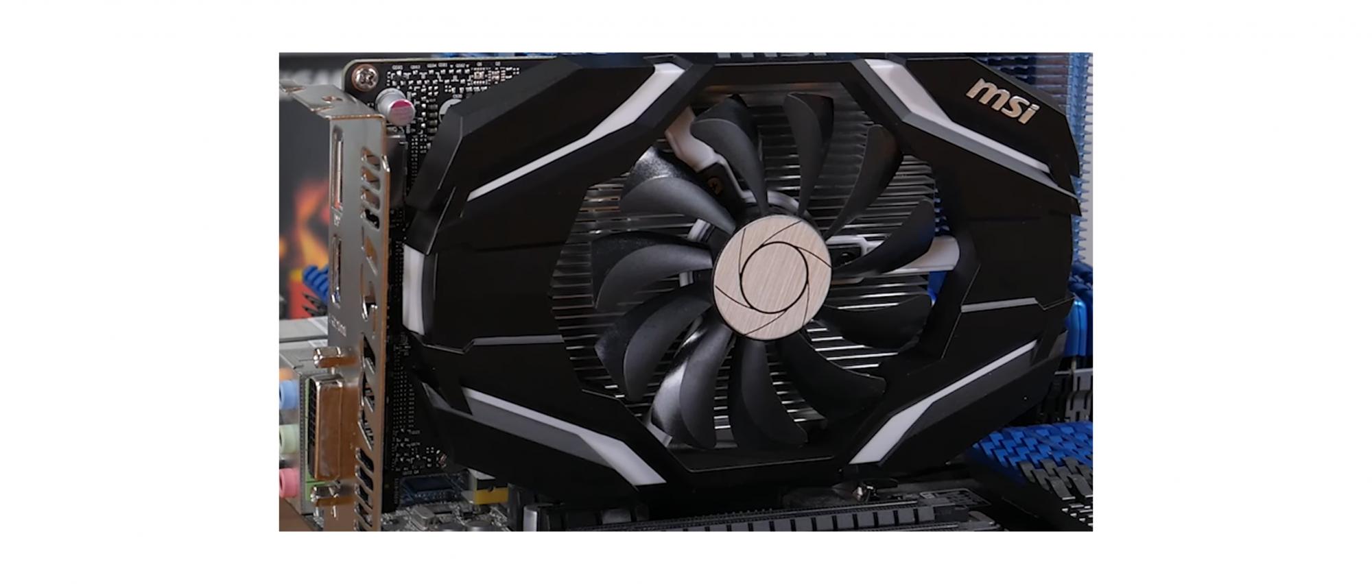

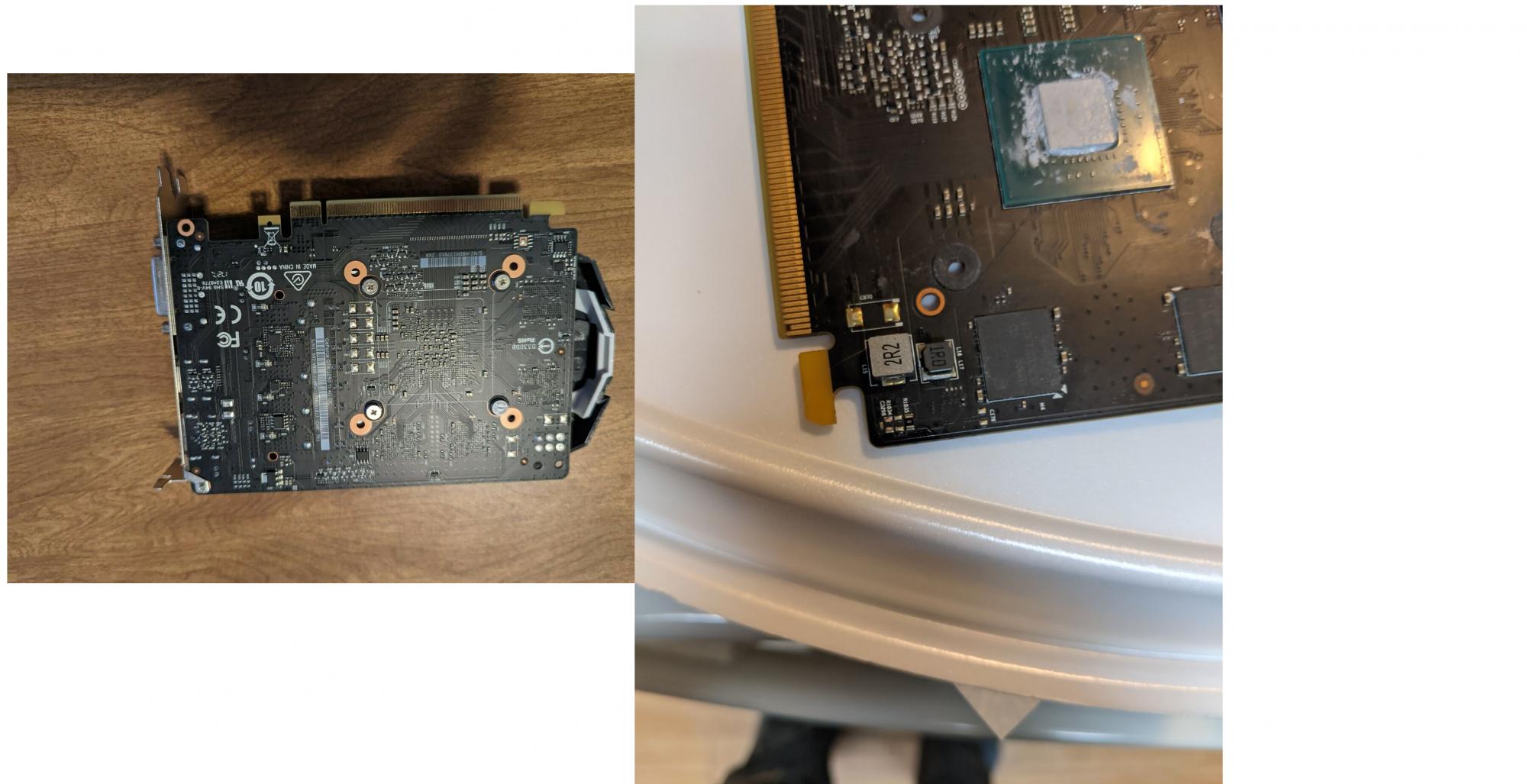

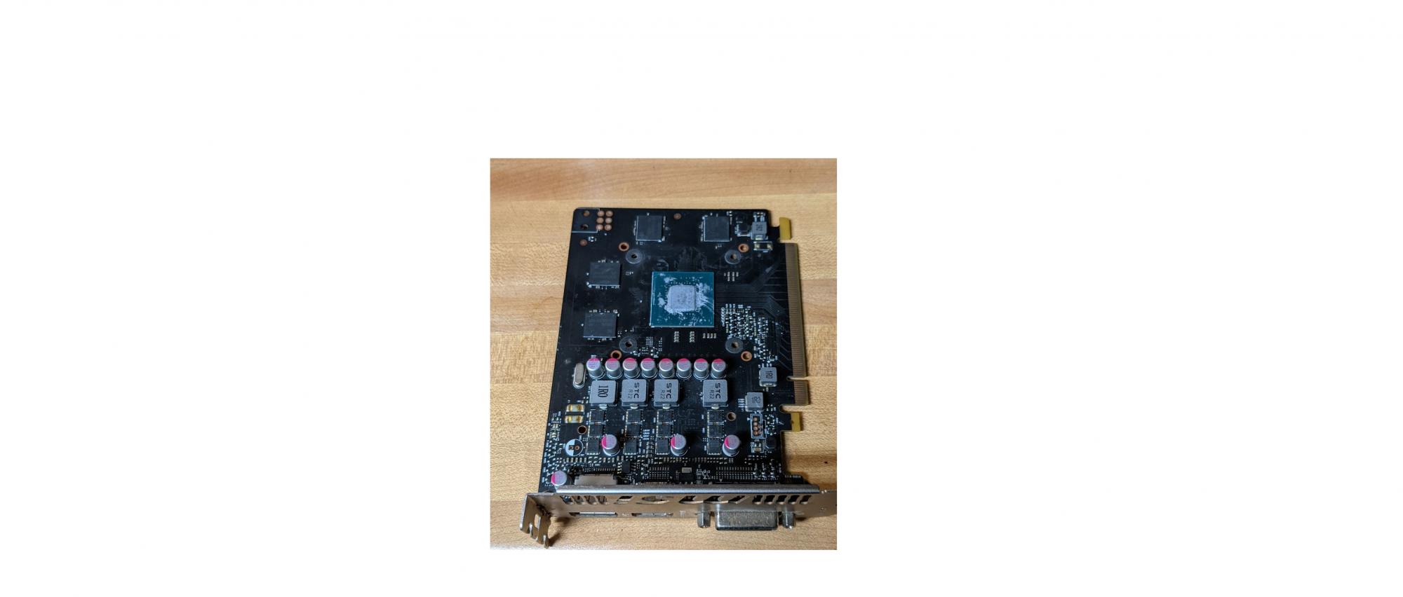

I have an MSI 1050 Ti 4GB OC Edition, that I am trying to repair.
Here is my situation:
I am rather new GPU repair and have no idea how to proceed in this situation.
Does anybody have ideas? How could I diagnose this card further?
- On the card all voltages seem to be present. I could not detect any issues.
- When the card is installed booting with integrated graphics is no problem.
- The card is detected correctly by GPU-Z
- I can read and write BIOS without any problems.
- I have already tried several BIOS versions but this did not change anything.
- Installing Nvidia drivers when the card is installed in the system crashes Windows
