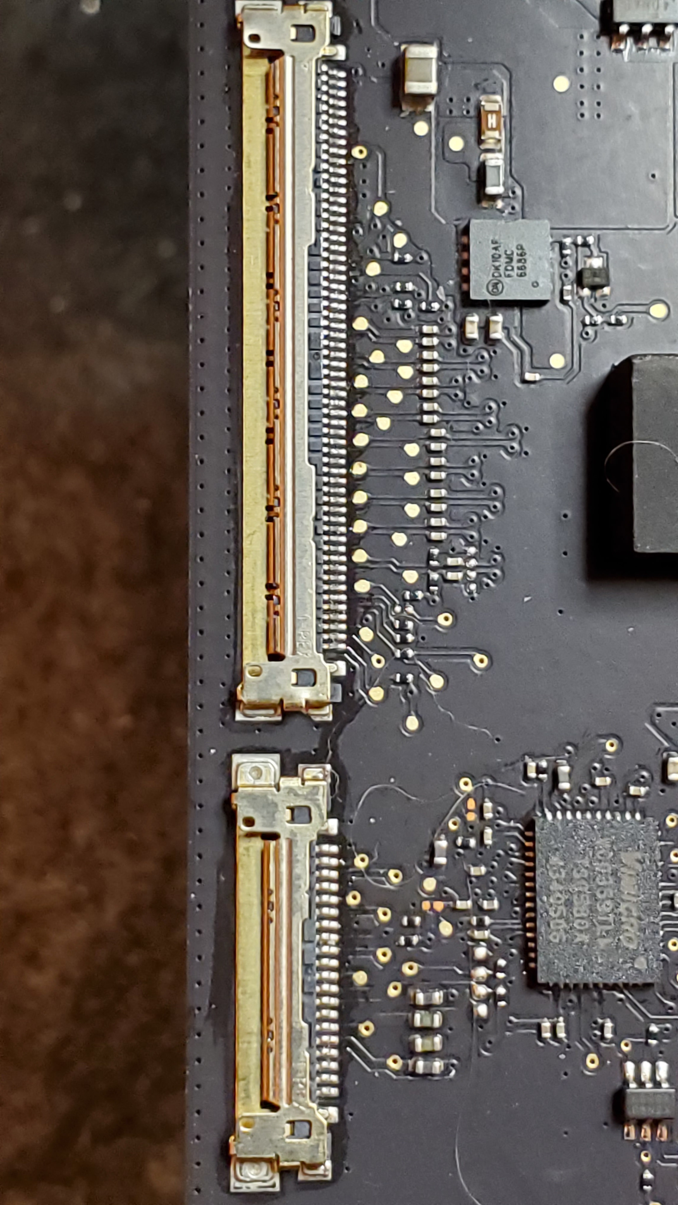

    does anyone happen to have a mainboard 820-01237-A on the table and can make me a very sharp photo of the area LVDS display connector. There are about 3 parts missing underneath the LVDS connector. the customer tore it off when trying to connect the display. He slipped and has torn off components. Thank you

    Perhaps you can post a clear pic of the region of the board that is missing these parts?
    May be you have EMI filters or DC block caps that are missing.

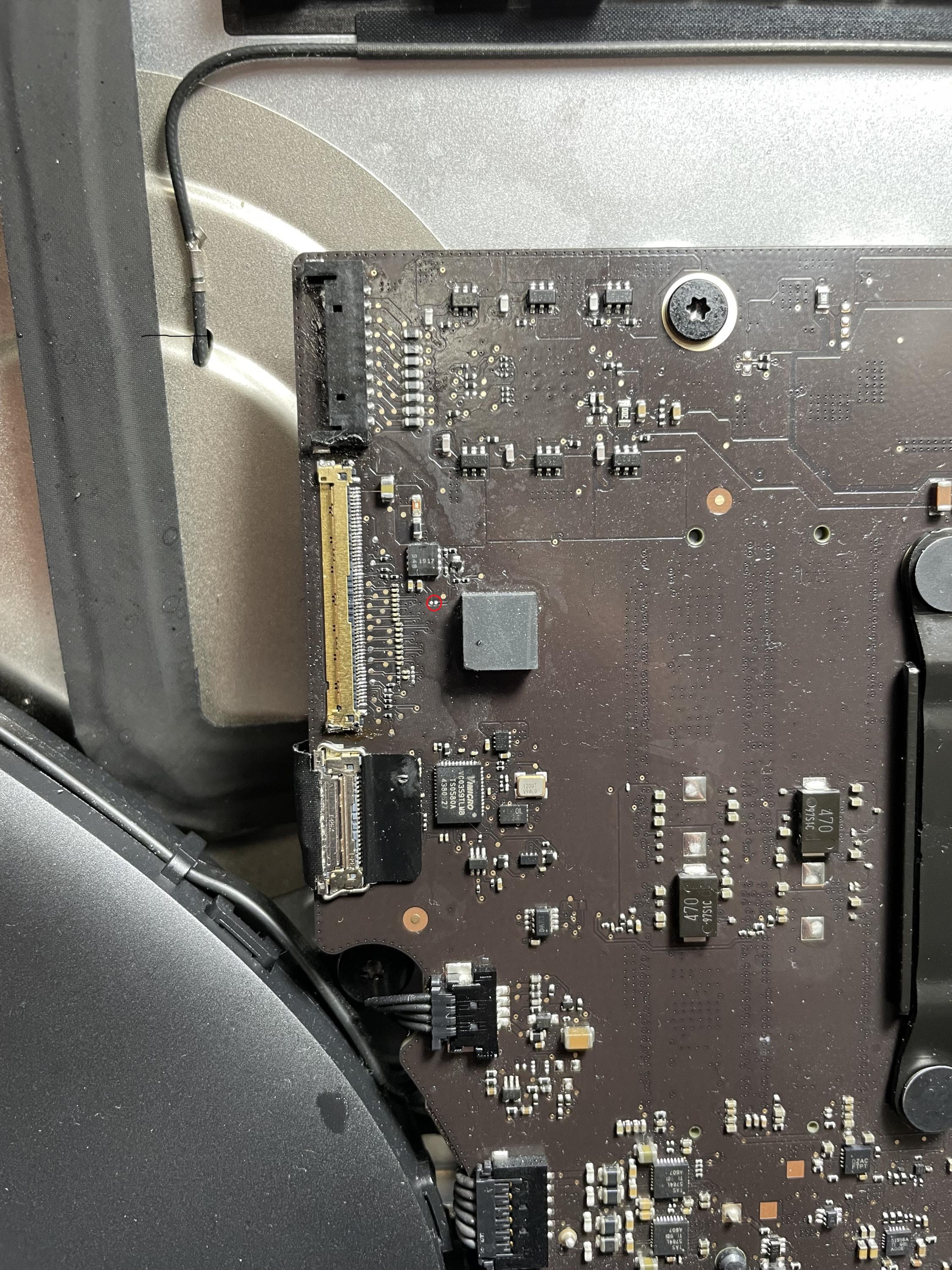

      I am of the opinion that a component is still missing in the red circle. but what kind of component?

        This is a capacitor measured as 52nF.
