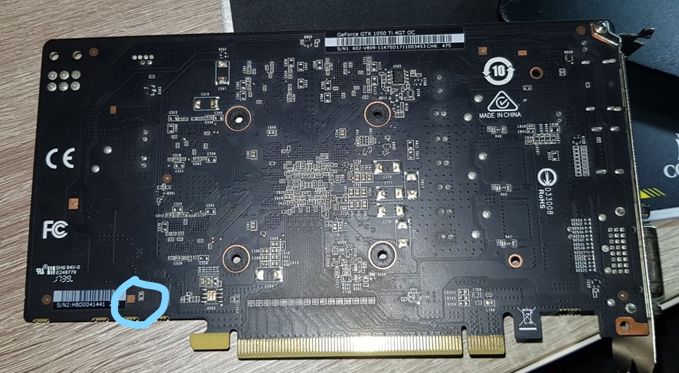

    Hello everyone and happy to post a message, I have an MSI GTX 1050 ti 4gt oc and at any time the card gives me a black screen and then nothing.
    Even when trying to install windows for example at startup, the card started to make a black screen.

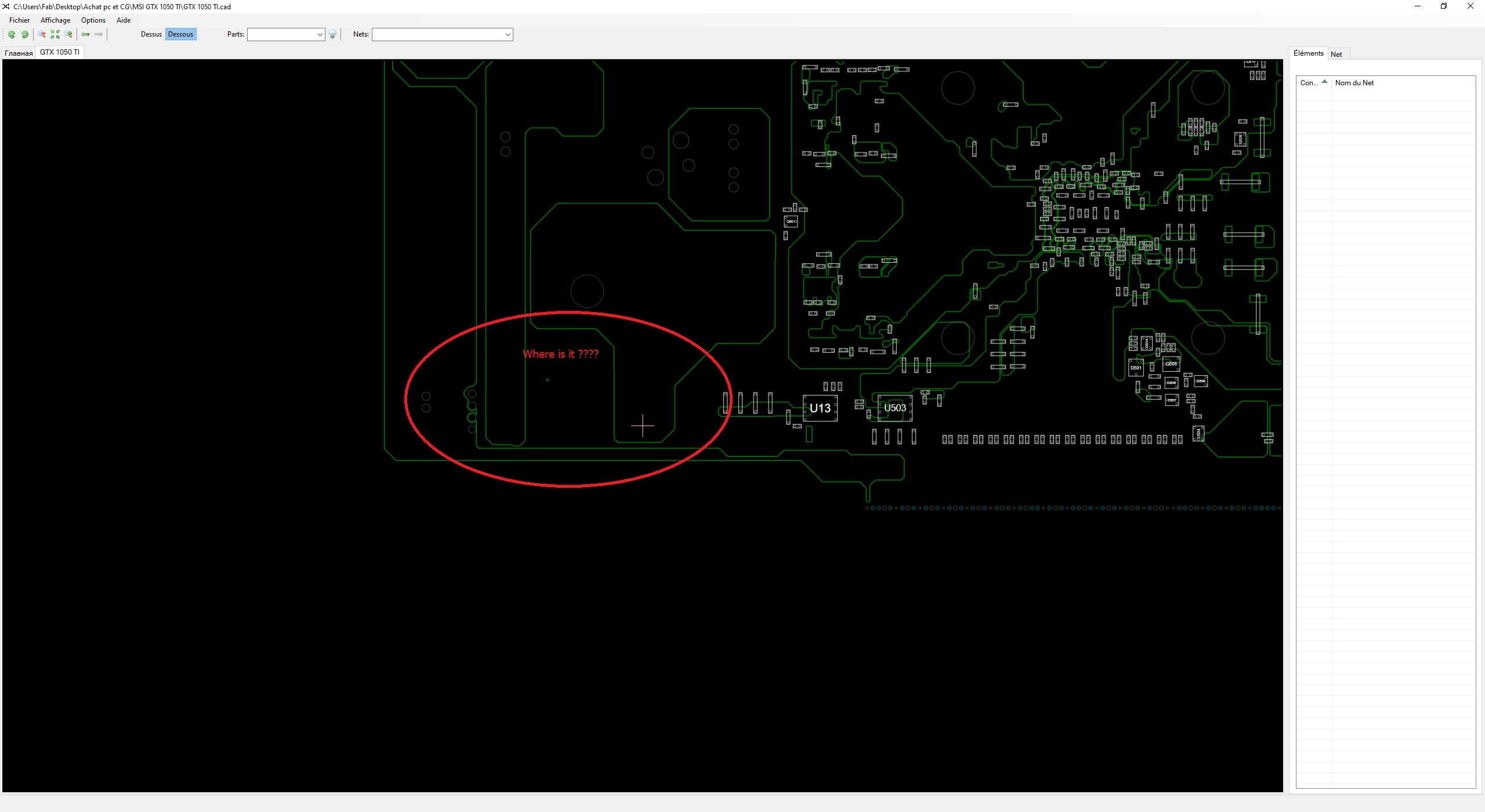

    I have not yet tried to take measurements but I have observed a missing capacitor which is impossible to find on the boarview and seems nonexistent for this one or diagram.
    In addition, my thermal camera shows an overheating of 40 degrees at this location.

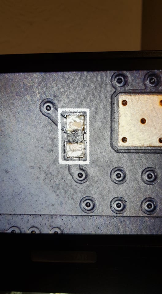

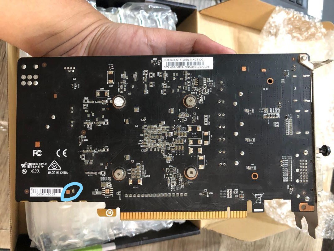

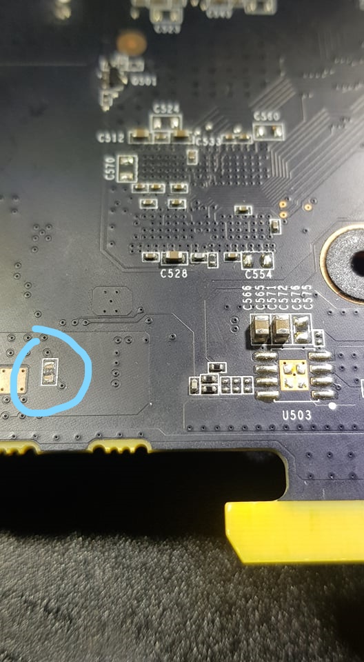

    I show you a photo named (InkedGTX 1050 GOOD_LI) which proves that it is very likely a capacitor.
    And other photos of the missing component.
    How to find the right value? I take the opportunity to put the complete diagram.
    What should I measure off in this case?
    Many thanks in advance.:le sourire::réjouir:

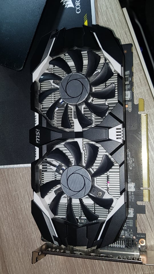

    I forgot to show the graphics card ^

      Hi, the boardview isnt allways exact, it depends on the model and revision, but with a schematics its all you need for fixing them.
      look for the schematics and post them here so we can have info.
      Look for more missing parts arround that zone

        hey thank you for your return response. Indeed I agree with you. I only found a boardview that matches the msi gtx 1050 ti simply and not the GTX 1050 4gt OC and no schematic yet. It seems that the manufacturer does not provide it. After an inspection this is the only component removed and I have not tested which rail it is on. Small question can I try a capacitor with a value for example 2.2 uF or 470 pf. Looks like it's size 603 or 402. Or am I waiting to find a diagram?

          Hi, first check if this is definitely a cap, easy way is to search for pictures of same type of card in the net. If it's cap, fire up the card and measure the voltage on the pad's, most probably this will be a power filtering cap. Just put there a cap with the highest capacity you can find, eg 10-20uF with the next higher standard voltage. However one missing power filtering cap cannot cause the failure you write about. So probbaly this is not the cause. Look for a other missing components, if one is missing there might be more, especially when you don't know the history of the card. Check U503, looks like desoldered, also strange is there are no SP-Caps on the backside at all, only places for (these ca 4 times 10mm black cases, ca 2 mm thick).

            1) According to the real photos on internal it is well a capacitor dimensions 805 and at the level of measurements there is 1.8 Volts what seems to be on the line 1V8.
            2) U503 is original desoldered and without component normally.
            3) For information I did as you specified and added a 10uF capacitor (the only one I have) and the graphics card displays a picture well for more than an hour for the moment without it cutting the picture by a black screen very quickly.
            Should I add a 22uF as a precaution in your experience?
            4)The GPU-Z software displays all the properties of the graphics card well compared to starting with nothing.
            HMDI and DP port work flawlessly as well as in game over an hour.
            To conclude I think that this small capacitor seemed to disturb a very important line.
            My friend will be happy to get it back
