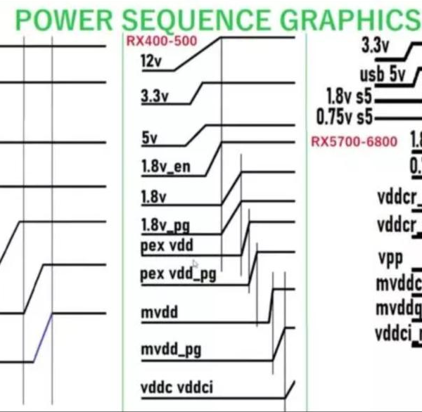

    Hi guys
    Does anyone have a chart (pdf. whatever) that shows the power sequence for all the common series of AMD and Nvidea GPUs? Or maybe a chart for each manufacturer?
    Something like this I have for RX400-500 series (see attached). This looks to be a segment from a document that possibly had all the different GPU families
    I put this in this forum section as it is not s schematic request though it is kinda related
    TIA
    Rich

          Re: Looking for a GPU power sequence chart
          It's here - this is why I wanted it actually
          https://www.youtube.com/watch?v=SmVdl8kew_4
          How to repair a GPU that does not detect
          Watch Chapter 6 - it describes it in detail
          and also 1:37:36 for the chart
