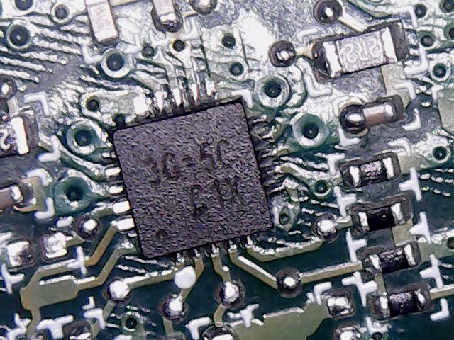

    Hi friends. I've been trying for several weeks to find any reference regarding this IC. It corresponds to the motherboard of an HP all in one 20-c400 (Prost195). That IC is damaged (how you can see in the attached photo) and I need to replace it. But on the internet there are no schematics or further reference to it. Does anyone know him? Which IC could I replace it with?

    The picture isn`t very clear but looks like its marked 3G= ,its a richtek RT6575AGQW

      Thank you very much for answering . And yes, the chip at the top says "3G = 5C". I have a question regarding that "5C" (I apologize but I am too new to this) does it only refer to the "date code" or date of manufacture? true? If I buy a "3G = 2B", shouldn't there be any difference?

        The last 2 characters make no difference,its just the date code.

          Infinite thanks!!! Seriously, you have helped me a lot. Thanks for taking the time to reply and read my post !!! You're the best!
