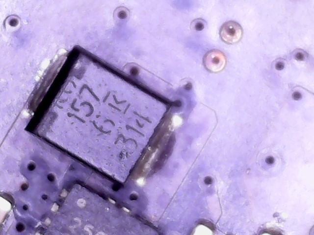

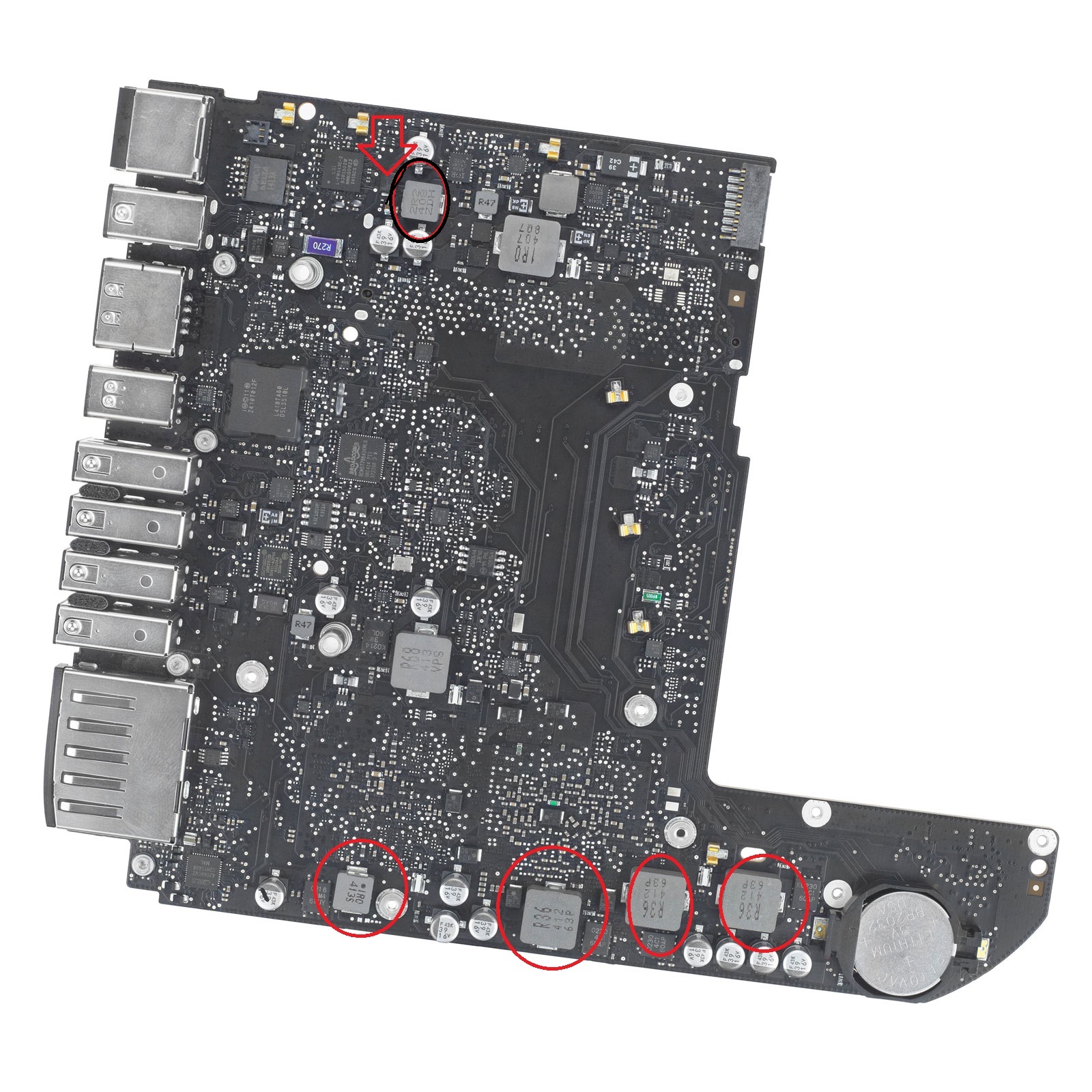

      thanks for the advice, I have a low resistance on the black coil, generated by this component, I do not know if it is a diode, I am attaching a photo of the faulty component,
      the red circles are low bga power supply resistances, they are correct

        ok, it's a capacitor, datasheet placed for those who need it,
        I'll post the results of the repair

          1) with the power OFF, what is the resistance reading on this coil to ground ?
          2) with the power ON, what is the voltage reading on this coil to ground ?
          It is possible for a rail to have a low resistance to ground if the rail is a low voltage supply such as 1v0 or 1v05, etc.
          Just the same, if there is a bad cap on the rail, you can face a very low resistance to ground so please post the value you are reading on this coil. If the voltage reading is not normal then this rail is defective and could be linked to:
          a) bad cap - certainly you can try to remove this cap and then check the resistance to ground - if the resistance is higher then this cap is bad and needs to be replaced
          b) coil not soldered / solder cracks over time due to heavy currents through this rail - you can reflow with flux and hot air to resolder each such connection
          c) local mosfet is defective ( the square looking device with IR = international rectifier is the mosfet )
          Assuming there was no liquid damage to the logic board.

            thanks for the advice, the capacitor was defective, the machine was repaired

                    Thanks for the tips and photos (reset1986) - helped me quickly find the shorted cap on my 2012 MacBook mini.

                      I had a 0.22ohm resistor between this coil and the ground I desoldered this capacitor and miracle the Mac starts
                      thanks for the information
