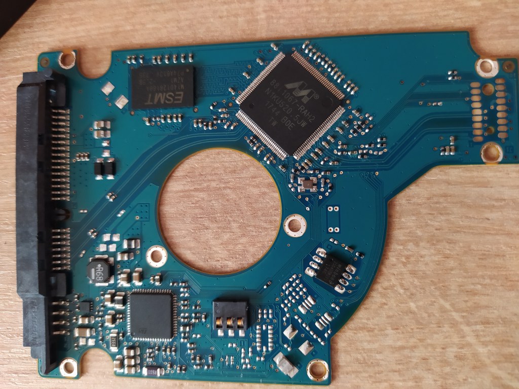

    I have this model HDD.Hdd connect to via usb 3.0 hdd tool,power on spinning drive and hit the head power off.

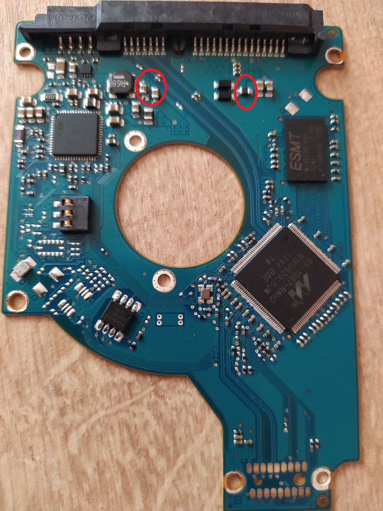

    I removed the hdd's motherboard,test the capacitors,resistors etc.
    in the red circle capacitor short circuit but I removed both of capacitor on motherboard everythink normal.
    I not find the board schematic.I need to helps.
    I have similar to three HDDs.

    Does it spin up, go click click (heads moving) then power off?

      yes yes exactly

        The drive has failed. If the data on it doesn't matter, destroy the platters (warning: glass platters!) and dispose of the remains in any way you see fit. Otherwise, reinstall the controller PCB and send it to a data recovery company. (ACS, DriveSavers, Gillware, etc)

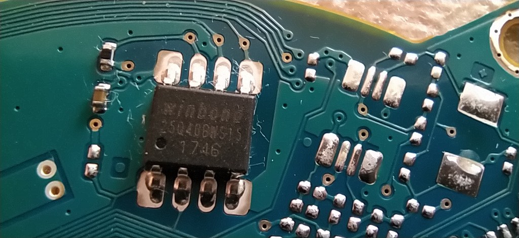

          I have a 2Tb seagate that has the same problem. I read a forum post somewhere, where someone had exactly this, and he bought a replacement controller board - they are easily available on aliexpress or ebay. The next step is to desolder the BIOS chip from the original controller board and fit it to the new board. Finally fit the new board.
          In his case he claims it then worked
          I tried exactly the same (mine was an identical model HDD) and in my case it made absolutely no difference - spin up - seek -seek - power down.
          So you could consider that 50/50 and maybe give it a go but from my own experience I wouldn't hold my breath.

              If the HDD spins up and clicks (head seek) but cannot initialize properly afterwards, then it's probably a failed head on the headstack or buffer amp on the headstack assy. So in that case, you could try to swap the headstack with another one from the same model HDD... but that's really only worth doing if you have valuable data on the HDD or just if trying to learn to do data recovery from a failed HDD.
              Otherwise, just as a repair to get a working HDD, it really isn't worthwhile.
