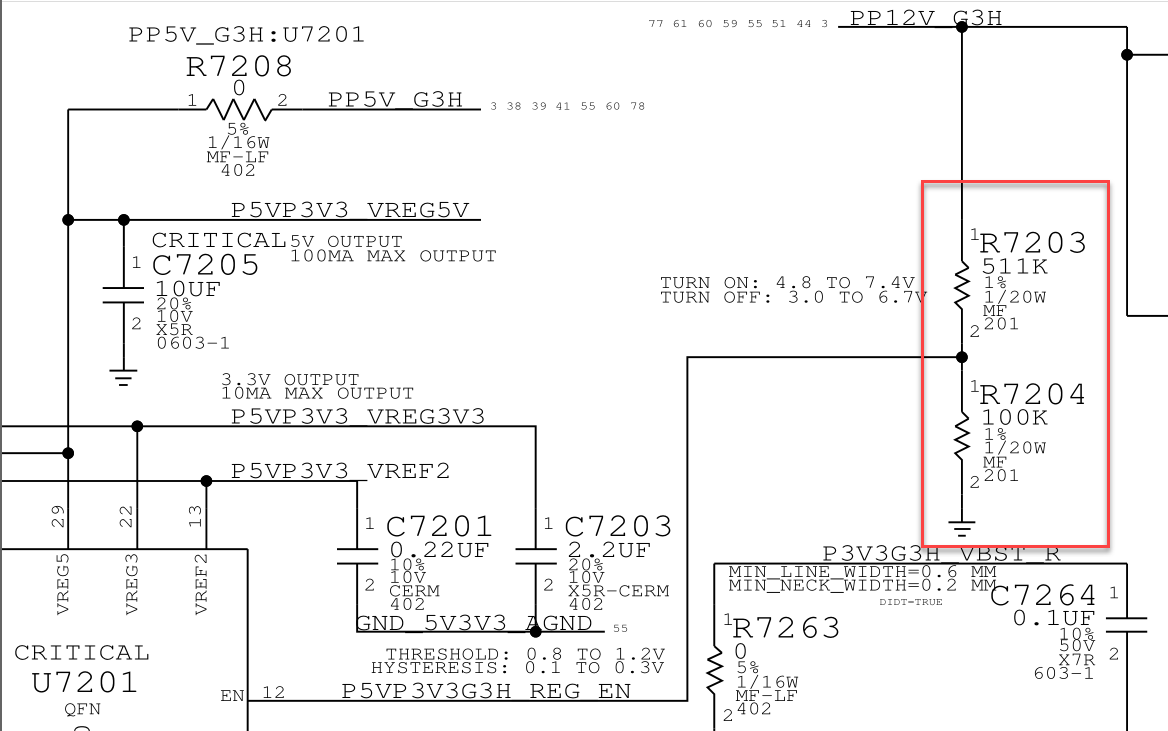

    Re: Apple Mac Mini A1347 Late 2014 completely dead no power
    Ok.

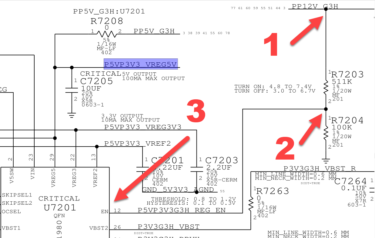

    1) Resistance to ground is high enough so you do not have a short on the 5 volt LDO rail. However, it is not turning ON.
    2) The ENABLE for this rail appears to be pin #12 of U7201. It is based on a resistor voltage divider. Once the power DCIN is docked, the resistors produce a safe lower voltage that is fed onto pin # 12 to ENABLE this always on 5 volt LDO rail.
    See and post the attached voltage readings.

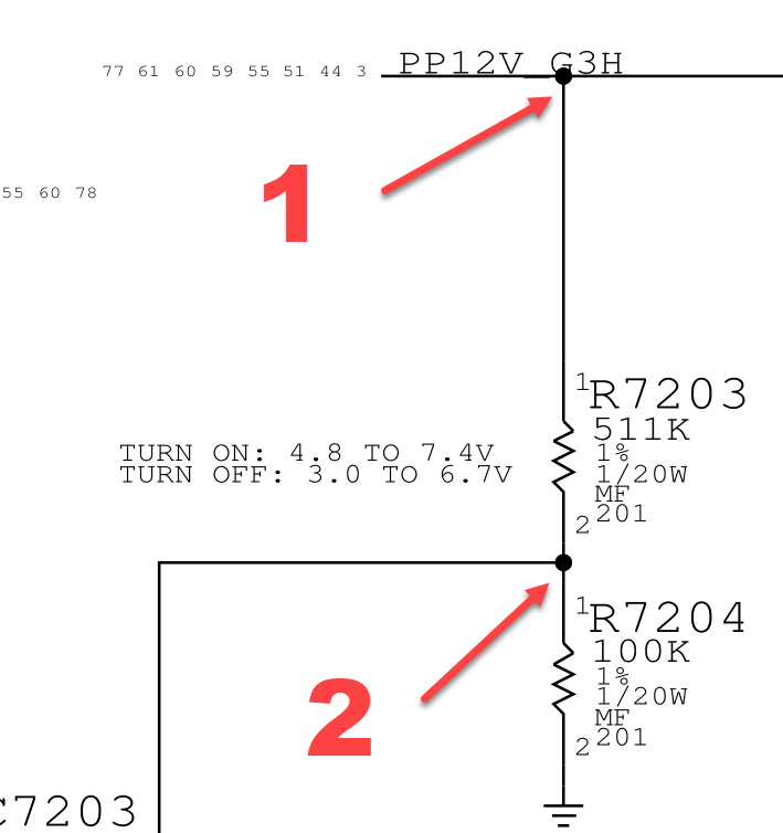

    According to the schematic, location # 2 & pin 12 of the U7201 should be:
    TURN ON: 4.8 TO 7.4V
    TURN OFF: 3.0 TO 6.7V

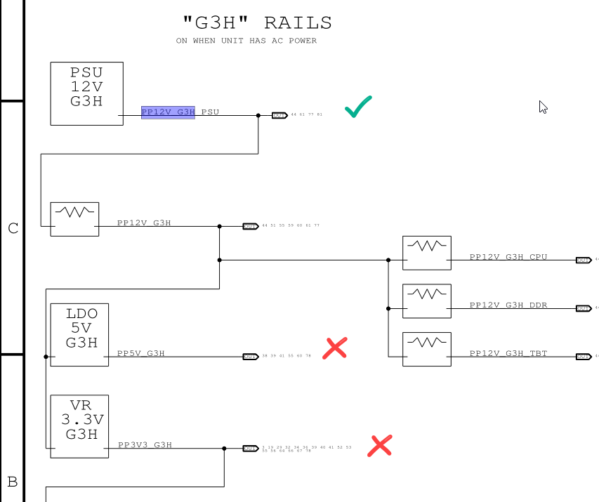

    3) If the 5 volt rail is ENABLED via pin #12 and still not turning ON @ pin # 29 of U7201 then U7201 MUST be replaced. Mobilesentrix does not carry this part which is a shame but see it available for sure on Aliexpress and other USA sites.
    If you cannot source it quickly, I believe we have some of these in our building but will have to confirm. 99% that we do. Let us know if you do need this part from us. Can figure out a fair cost. I think we have a good company discount with Canpar shipping across Canada.
    You will need hot air tools to replace this QFN that has a metal belly which acts like a massive heatsink. The surrounding parts should be masked with kapton tape then apply flux to this IC. Before you do any of this, take a clear picture of this area so that the QFN part can be applied back exactly as before with pin #1 in the proper orientation. Once the flux is onboard it can get crazy to locate pin #1

      So I measured the R7204 and it's reading 6.8k ohm instead of 100k ohm. I also measured the R7203 and it reads 88.8k ohm instead of 511K ohm. Will the massive drop i voltage cause the issue am having with the mini not turning on?
        Can you post the voltages at the same 3 locations? Then we will know for sure.

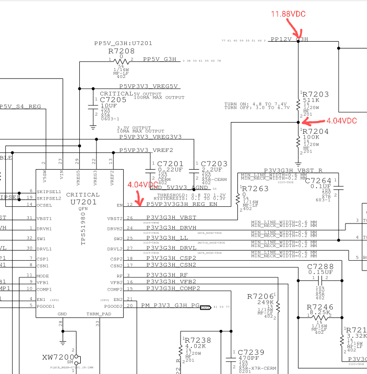

          Hi, I have the voltages attached

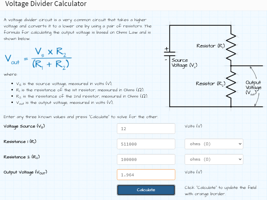

                    2) On the resistors,
                    511k 0201 1% precision
                    https://www.arrow.com/en/products/nr...nic-components
                    100k 0201 1% precision
                    https://www.arrow.com/en/products/rc...ctro-mechanics
                    3) Glad to hear that your resistor values match the original schematics

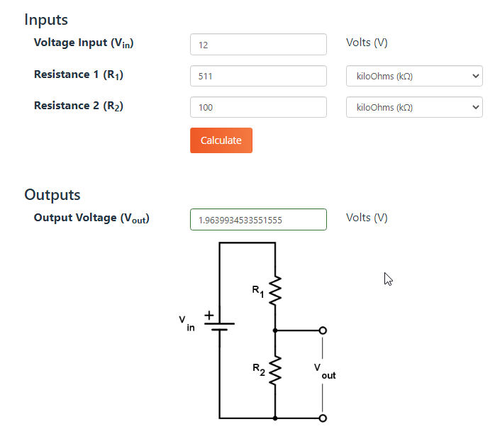

                    4) Strange that you had ~4V on pin 12. This may allow us to conclude that U7201 is damaged.
                    Based on the online resistor voltage divider calculators, you should have about 1.96V => 2v0.
                    https://www.allaboutcircuits.com/too...er-calculator/
                    If we assume this device's core is powered from 3v3, then ~2v0 is considered a logic HIGH which means the VREG5 (pin 29) rail should turn ON. Personally do not have access to the datasheet for U7201 but @ ~4V0 on pin 12 can be dangerous for a chip with 3v3 powered GPIO pins.

                      Hey Mon2,
                      I wrestle with the U7201 device and I was able to remove it and solder on the new chip and below are my findings:
                      on U7201 (TPS51980) pins
                      PIN 12 EN = 1.92 VDC
                      PIN 4 EN1 = 0 VDC
                      PIN 5 PGOOD1 = 0VDC
                      PIN 1 DRVH1 = 0VDC
                      PIN 20 PGOOD2 = 0 VDC
                      PIN 3 RF = 0VDC
                      PIN 23 VIN = 11.88VDC
                      PIN 2 V5SW = 0VDC
                      PIN 29 VREG5 = 5.00VDC
                      Pin 31 = 4.99VDC
                      Pin 22 = 3.29vdc
                      Pin 13 = 1.98vdc
                      Pin 14 = 4.99VDC
                      Pin 15 = 1.98vdc
                      Thanks in advance

                        1) voltage readings @ 1 and 2 of the attached locations ? According to the calculator, this looks to be correct if the input voltage is around 12V.
