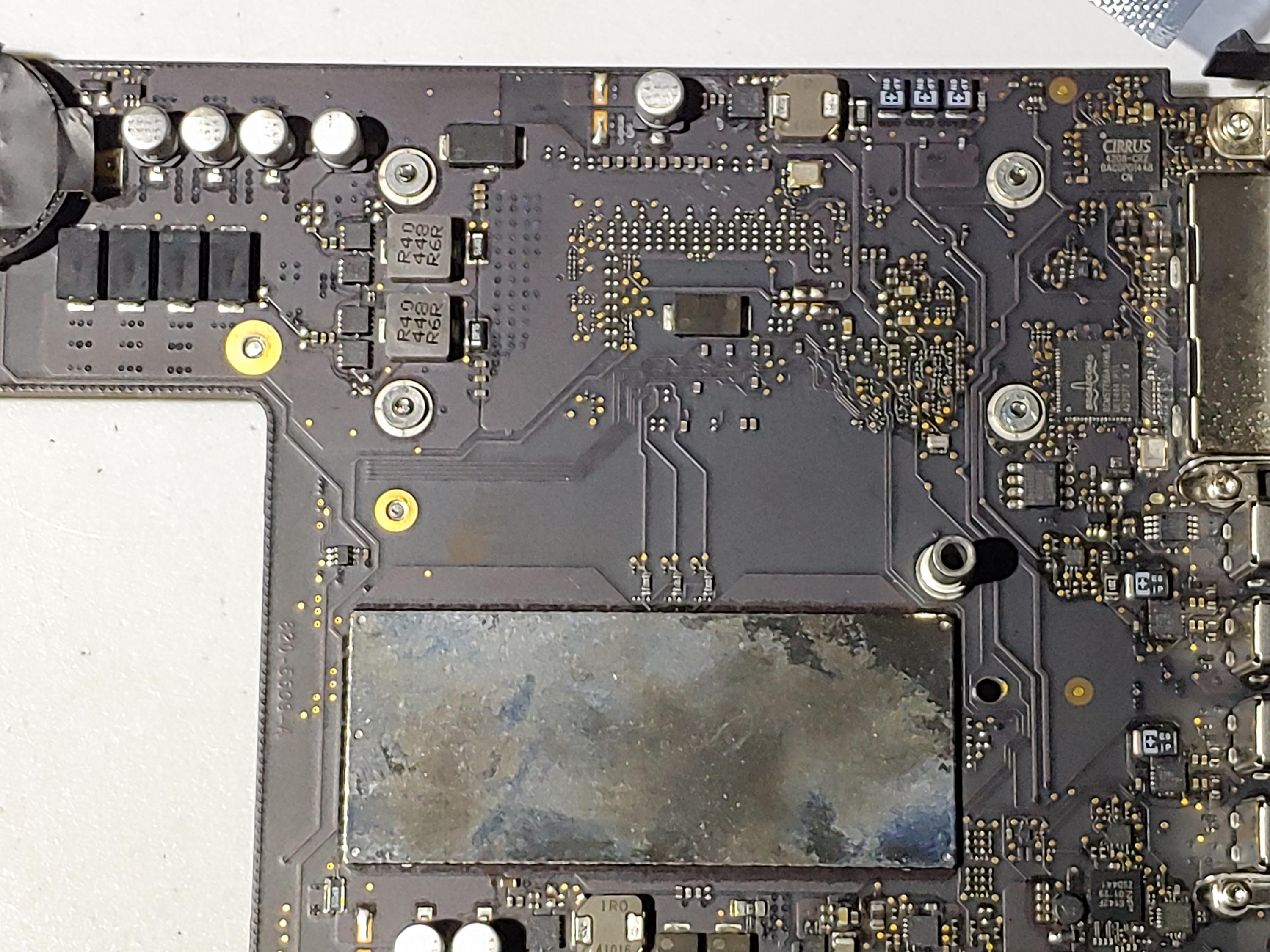

            Re: Apple Mac Mini A1347 Late 2014 completely dead no power

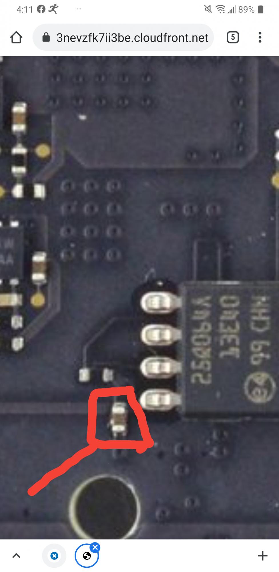

            Thanks for replying. I put the mac mini board 820-5509-A and noticed that there is a component missing. I have a picture below about. I need help Identifying that missing component.
            Also can i know where the power IC is located.

              #46
              That looks like the spi flash rom in the 8 pin soic package. Search for the datasheet but suspecting that the pin 8 is the Vcc power rail at +3v3. So this will imply that the missing part is a non critical bulk or despite capacitor.

                  Also, the 8 chip is a 25Q64 IC and is available from assorted vendors. Pin 8 (with the missing cap) is the power rail for this device and is +3v3. This is not the reason for this system to be not working. As a general practice, digital designers should place local despike and/or bulk capacitors to smoothen out (filter out) any transients of energy that could harm the local device. However, as noted, missing this cap is not really the show stopper here for your system.

                    #49

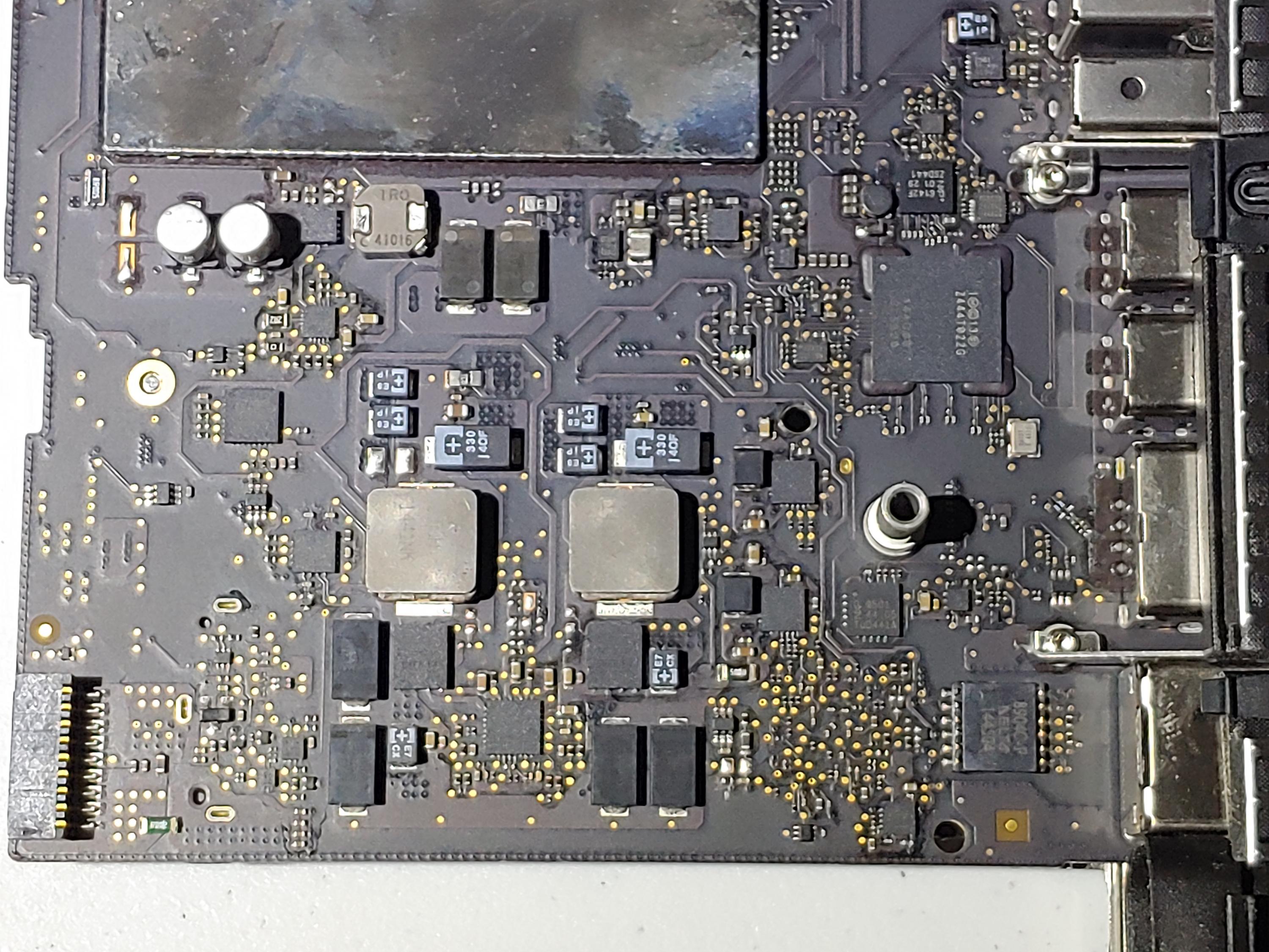

                    I have attached a zoom in picture of where the power gets in the motherboard.
                    Thanks for helping

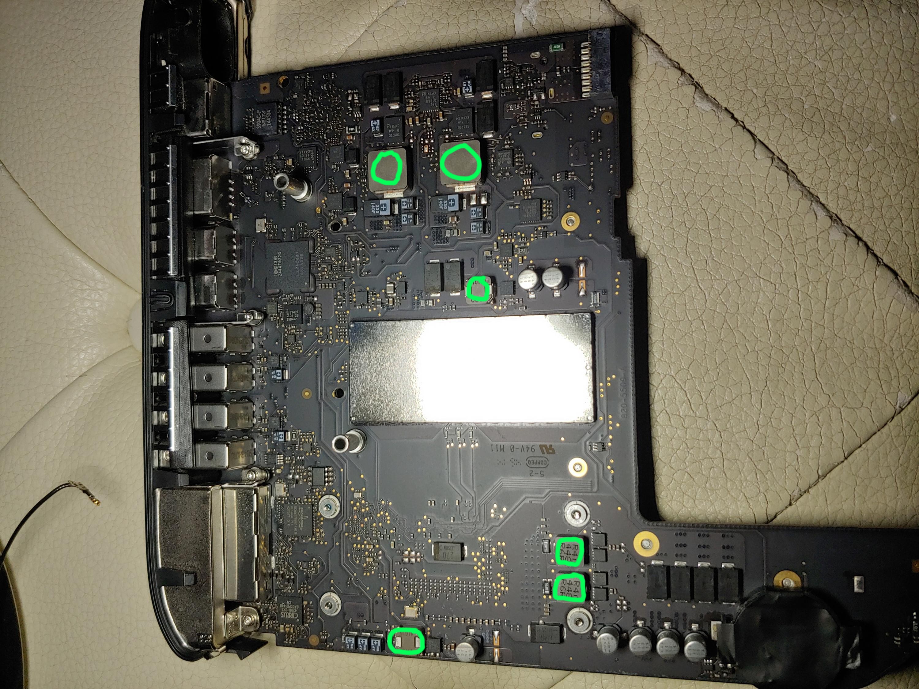

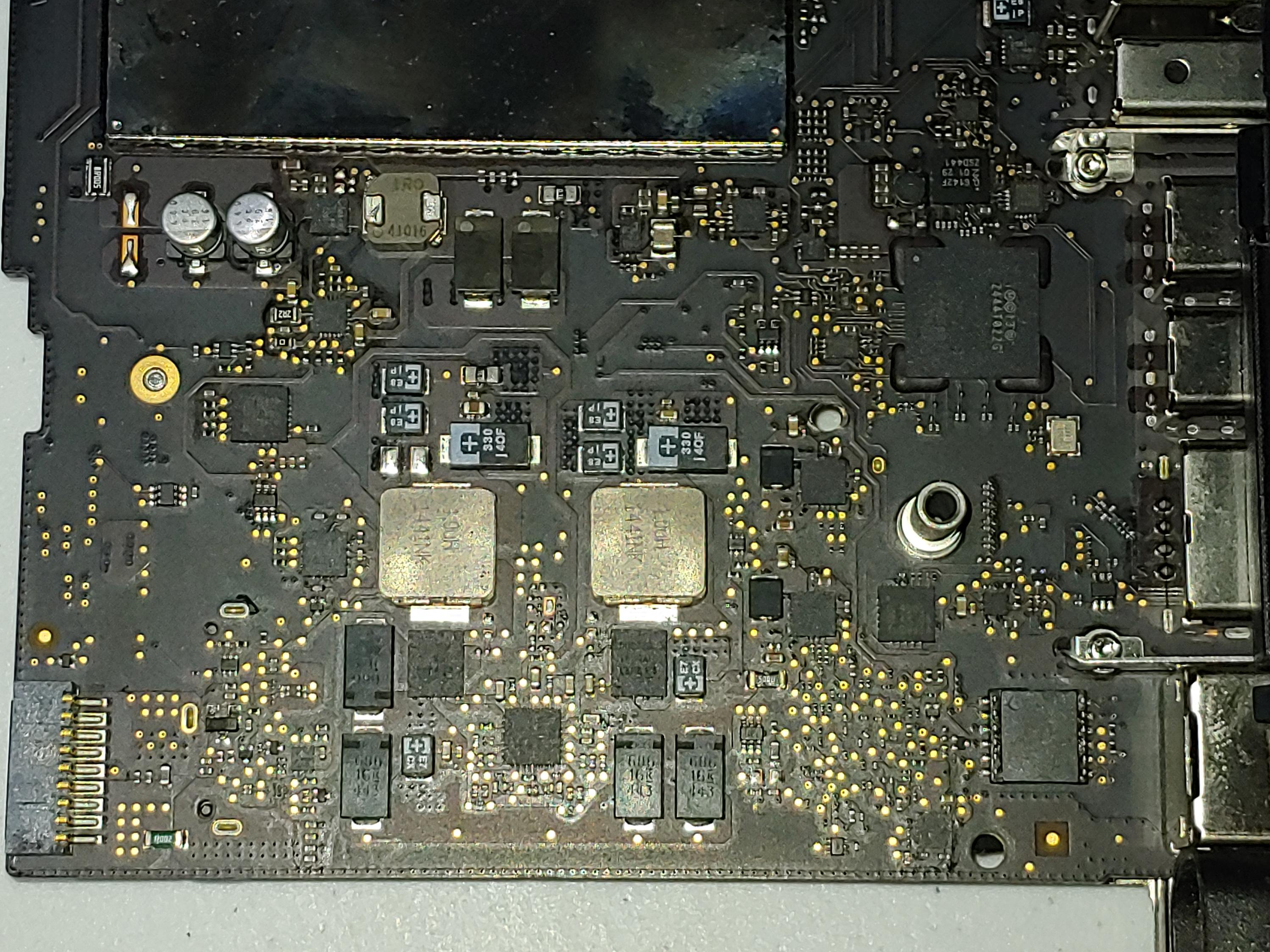

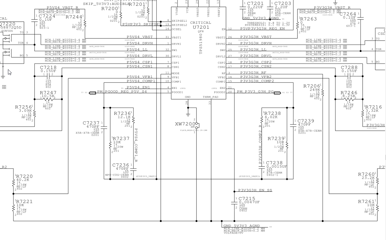

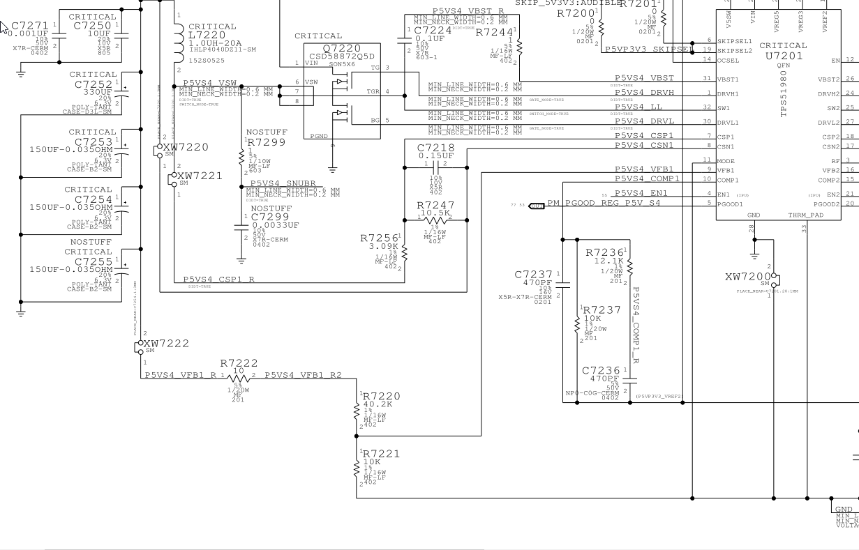

                      Can anyone here help me out with the Mac mini. Now I made the issue worst. I am reading 0 volts on all the primary and secondary side of the inductors as shown in the picture. I am getting 11.88vdc all the way to the input of the power IC 58872d but the output side that goes to the inductor is measuring 0volts. I tried to verify each component for a short and does not seem to find any. Without the schematic, am in the dark. Am hoping someone with more knowledge with apple logic can chime in.

                        #51

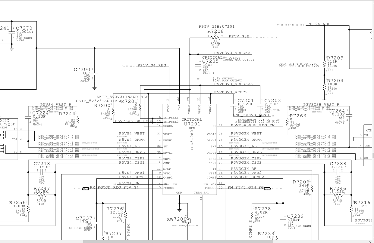

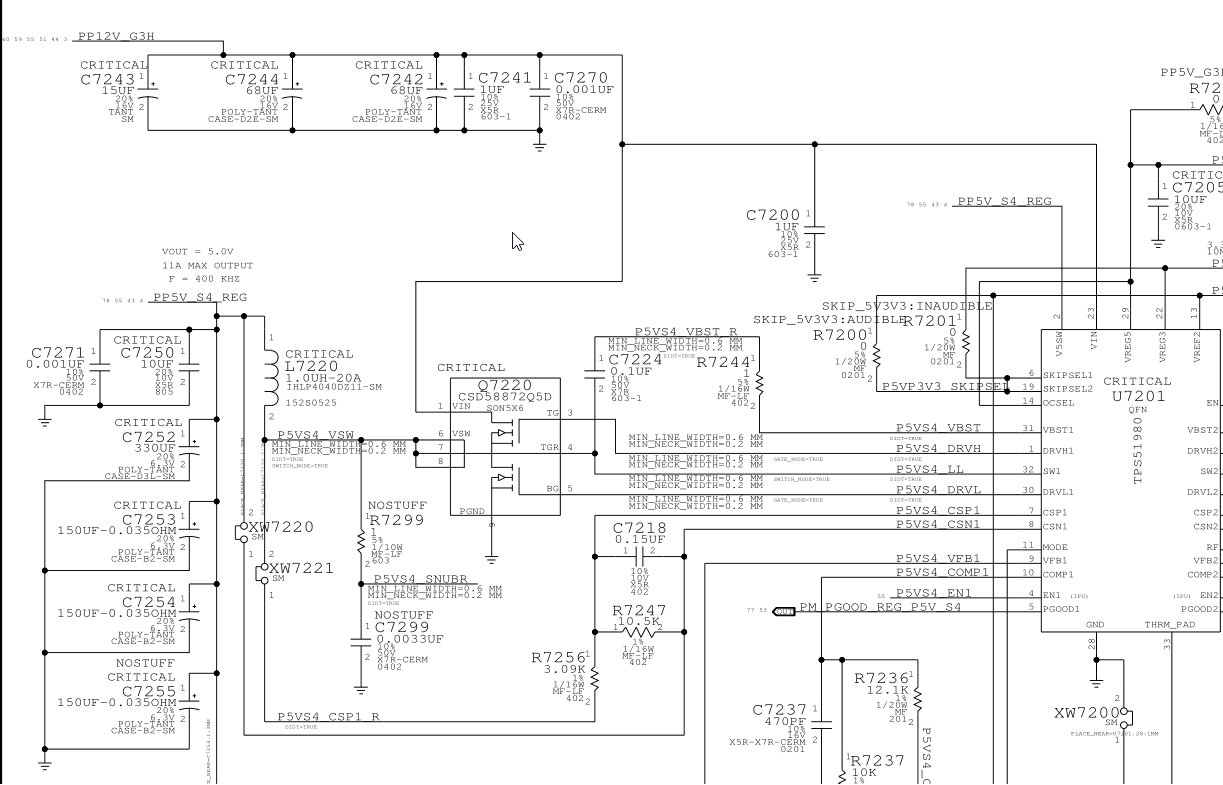

                        see attached (820-5509)

                                ok. thanks for the schematic. i will use it to try and solve the issue.

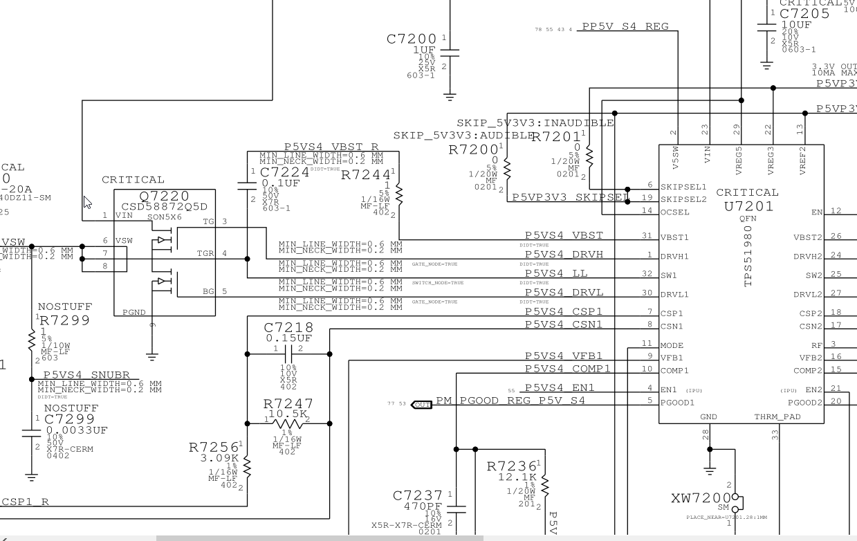

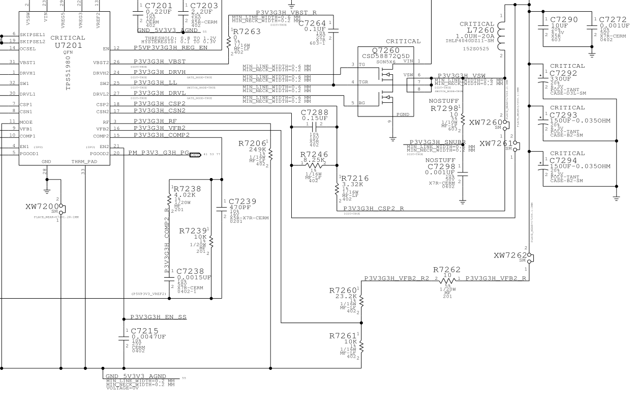

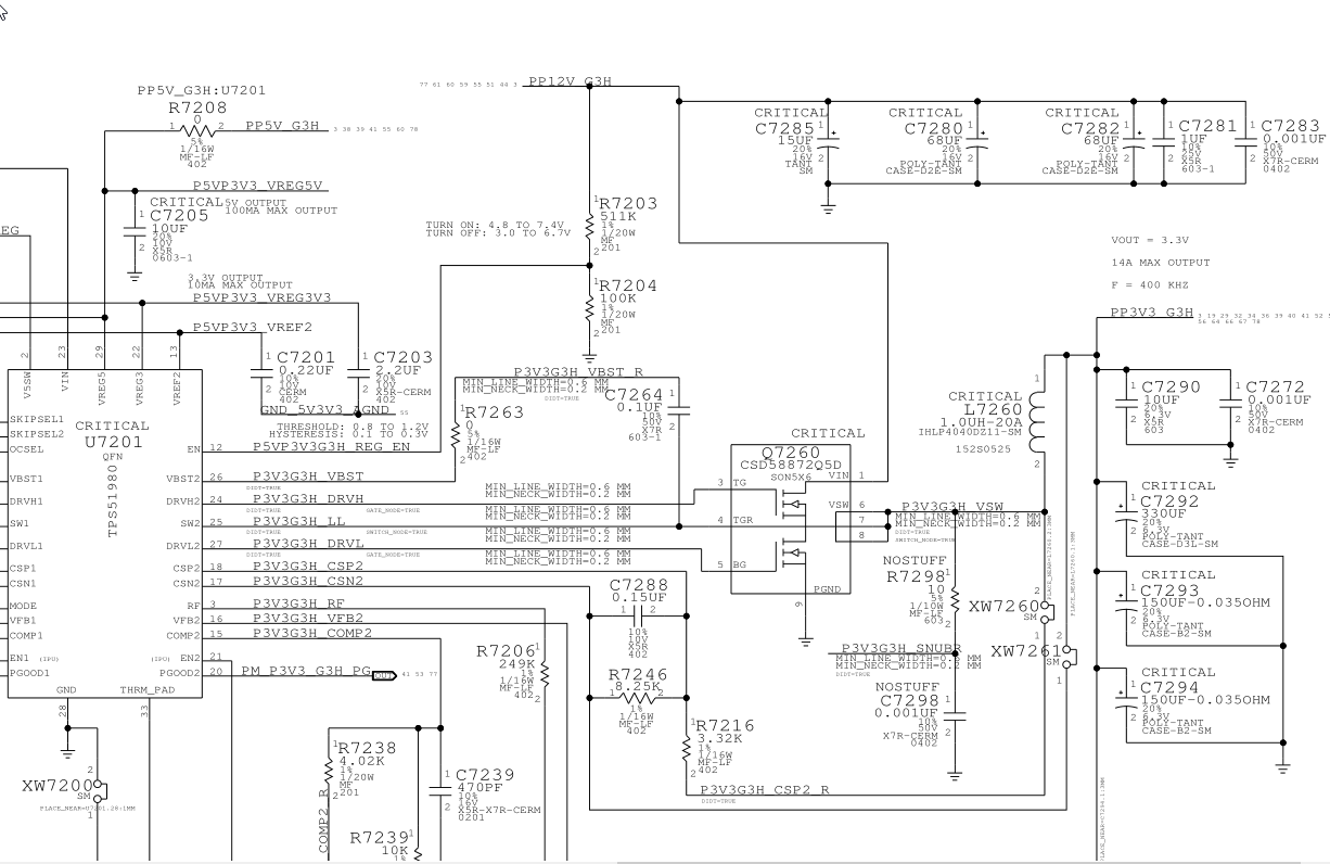

                                    so far i have the following voltages on U7201 (TPS51980)
                                    PIN 12 EN = 4.00 VDC
                                    PIN 4 EN1 = 0 VDC
                                    PIN 5 PGOOD1 = 0VDC
                                    PIN 1 DRVH1 = 0VDC
                                    PIN EN2 = 1.136VDC
                                    PIN 20 PGOOD2 = 0 VDC
                                    PIN 3 RF = 0VDC
                                    PIN 23 VIN = 11.88VDC
                                    PIN 2 V5SW = 0VDC
                                    PIN 29 VREG5 = 1.158VDC
                                    I need some help. thanks in advance
                                    • mon2
                                      • Dec 2019
                                      • 14657
                                      #58
                                      The EN1 and EN2 voltages are too low to enable these power supply rails.
                                      VREG5 is a fixed LDO and should output +5v0.
                                      Power down and check the resistance to ground on the VREG5 rail. What is the value?
                                      Is this regulator getting warm ?
                                      This part may have to be replaced. It is a simple part to source. Will review the schematic again tomorrow. I think mobilesentrix.ca in Toronto has these devices. They have some crazy parts in their inventory. The owner has a good pulse on the market needs and listens to customer feedback.

                                          #60
                                          The VREG5 resistance to ground is showing .660M ohm. i measured the pin 29 on TPS51980 to ground.
