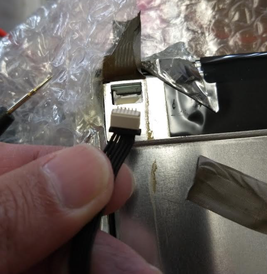

      From memory, there are silver taped up black cables on the backside of the display screen. One cable to the LEFT and another on the RIGHT backside of the display. Each is used to power the internal LED strips (LEFT and RIGHT side and at the bottom of the display).
      What we have seen is that when customers attempt to do their own upgrades, they rest these rather sensitive areas against a hard surface and destroy the mating harness. That is, the male & female connectors separate and therefore there is no more backlight. The source backlight cable may be ok but this mating cable harness does not transfer the voltage to the display.
      On this note, carefully (stay away from the open backside of the open frame power supply - it can be LETHAL!!). To the LEFT of this dangerous power supply is the backlight power supply. At the BOTTOM of this large black circuit board will be the BACKLIGHT cable harness cables. This is from memory. Check the voltages on this cable harness region. What are the values here?

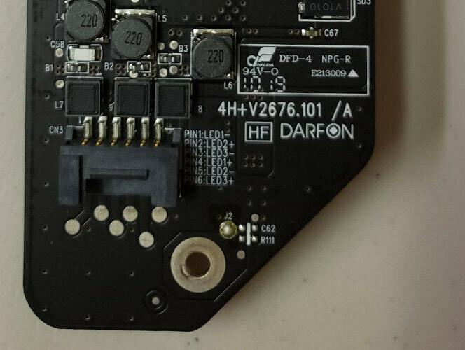

      See attached picture.

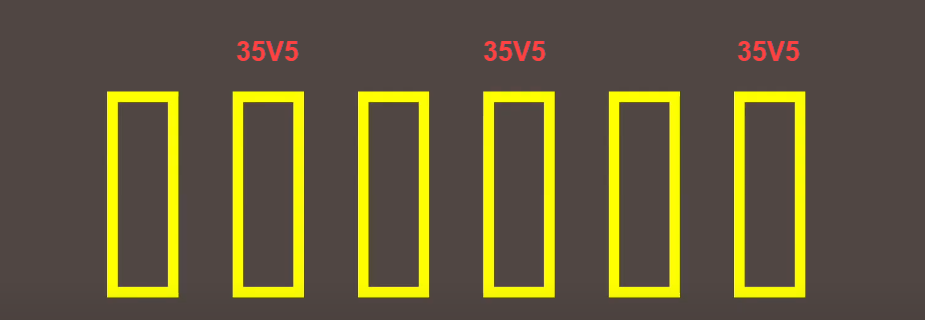

      You can in voltage mode of your meter with black on 'LED-' and red probe on 'LED+'.
      Or black probe on GROUND on this board and red probe on 'LED+'
      What value(s) do you see here?

        Re: iMac 27in A1311, mid 2011 - no image or backlight

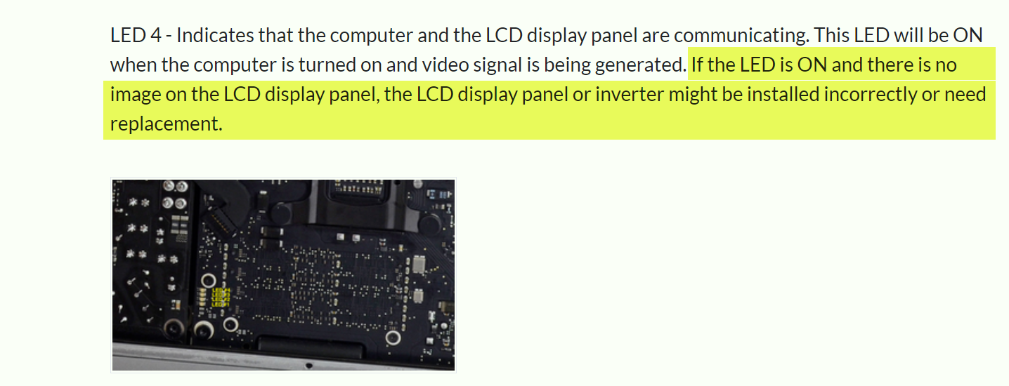

        I understand these are two separate issues.
        My LED driver board is different, please see attached. The output is 12V (same as the input).
        The LVCD cable and the connections are fine so I would suspect the TCON board or the LCD panel itself. Would it be ok to temporary replace the tantalum caps by electrolytic ones?

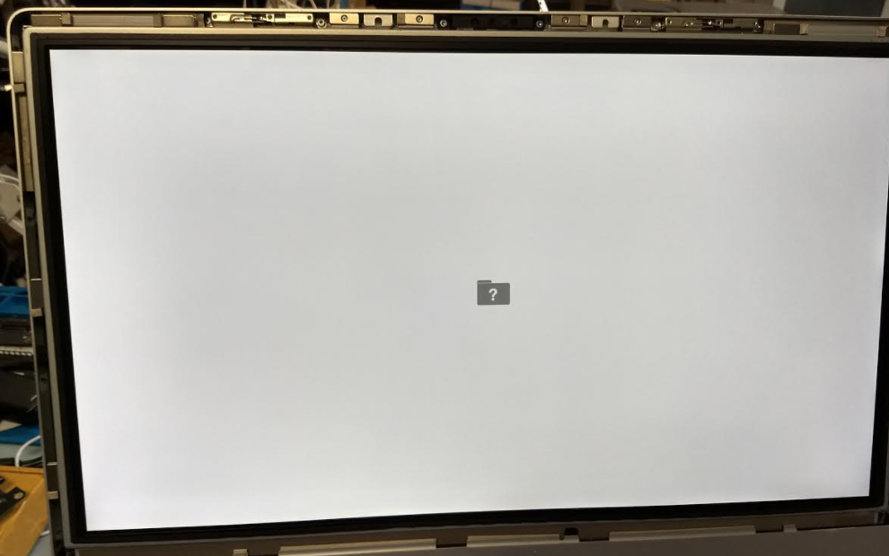

          OMG - this is very eerie. Have exactly the SAME issue with a local client. Trying to debug as we type. Same, LED out is @ 11v8 on the bottom side of the backlight connector.
          • mon2
            • Dec 2019
            • 14410
            We have a defective i-pex 30 pin lvds connector. Have a new one on order for this repair. Will update this thread tomorrow.

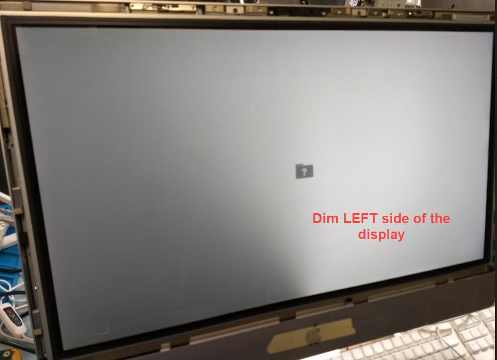

              hi. just got our iMAC display working. Was not fun. Will document in a new thread but check the following:
              1) be 100% sure that the LVDS 30 pin ipex connector is not shorting and that each pin is soldered ok. Given that you have 4 LEDs ON for the POST, I think we can agree that your LVDS cable is ok but check anyways.
              2) be sure that the LVDS cable is not pinched from the logic board to the backside of the LCD panel itself. Would help if you can test another cable but again, if 4 LEDs are ON, I think you are ok here.
              3) Confirm that the SYNC cable and connector to / from the display are mated ok. We found that one of the 4 pins on the SYNC cable was not seated properly which kept the screen DARK!! Got scared, calmed down and reviewed the cables and found this error. After correct seating, all was ok for the backlight.

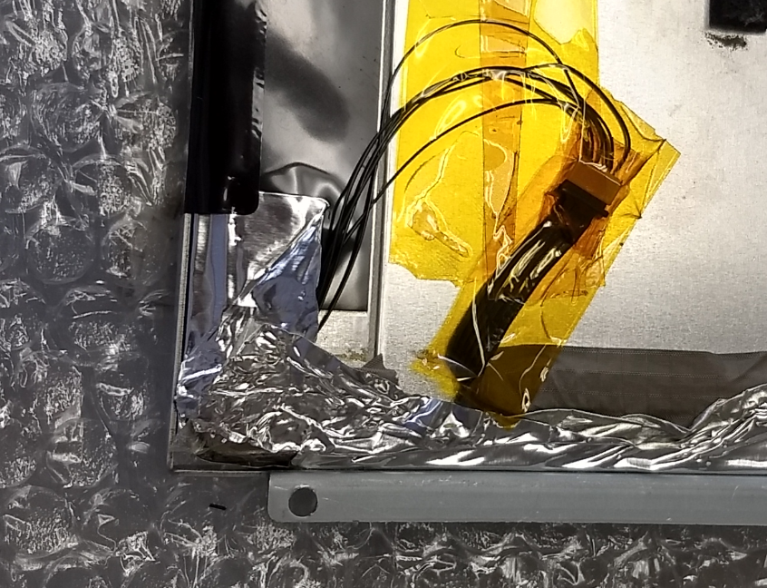

              4) This LCD panel had a dark LEFT side. Inspection revealed that the SMD connector for the backlight was broken off due to a physical bump of handling the LCD panel by this DIY customer.
              See attached.

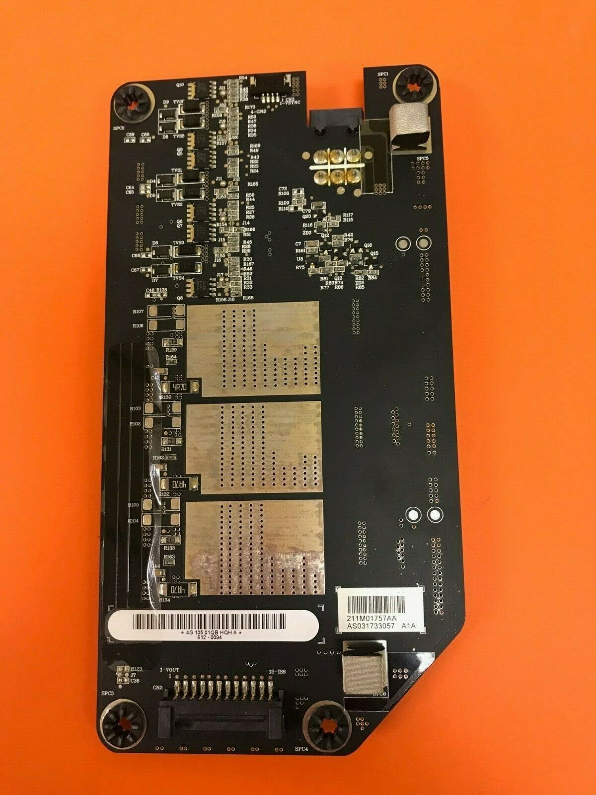

                  See attached.
                  Interesting in that:
                  1) when the display was dark, the voltages at the same test points were @ 12v0 (approximate)
                  2) when display is ON, voltage readings are at +35v5.
                  Q: Is there a possibility that your backlight cable in the same bottom corners (as per our repair today) are broken? This is a very common issue.
                  Here is a full video on this issue and repair - we did the same as Solution # 1. It was not too difficult to break open the white plastic parts (carefully!) with sharp blue shears we purchased from chinaphonefix in Shenzhen for $2 or so. Then we had the room to solder on the 6 wires for the repair using wire-wrap wire.
                  https://www.youtube.com/watch?v=LM3zW35BC20
                  Suggest next for you to carefully remove the aluminum foil tape on the backside of the display that leads to the bottom cluster of black wires. There is another similar cluster on the other side of the display.
                  Just remove carefully so you can apply it back in the same way. These metal foil tapes are for EMI shielding for possible noise.
                  Once you have this open, the black and white mating SMD connector will be visible. Try to wiggle this connector - does it move at all? If yes, then this cluster of backlight LEDs will not light up. Repeat for the other side of the display. The SMD connector should not move if it is soldered onto the LED strip properly. See the video for full details.
                  If these connectors are still solid and do not move around, then I believe the issue is the T-con board on the display itself. As noted earlier on this forum, not impossible to fix. We just replaced every tantalum onboard the board and this fixed the issue.
                        It turned that the image and the backlight issues were caused by a single faulty board - the LED driver one.
                        I've just installed a working driver board and got the backlight and the image on! It looks like when the LED driver board is faulty the video signal is not even being sent to the LCD otherwise I would have been able to see something on the screen using an external source of light.
                        Tried disconnecting the SYNC cable and it made no difference - the image got displayed on the screen.
                        The only remaining problem in my case is one dark side of the LCD, going to follow the procedure described in post #7 of this thread.
                            Thanks for the update and test ideas. Good to hear of your progress.

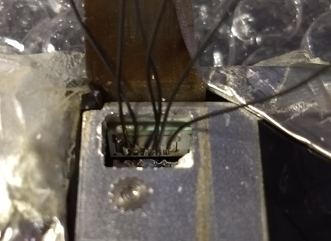

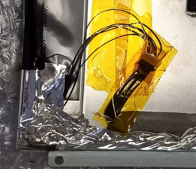

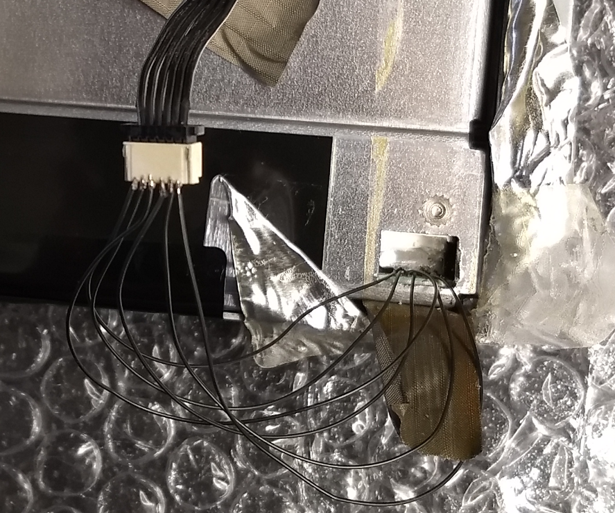

                            Attached are a few more pix from our last repair.
                            As a suggestion, cut open the (white plastic housing) area of this SMD backlight connector with sharp cutters to allow for more soldering tip room.
                            Then use wire wrap wire and consider to start in the middle of the SMD pads - there are 6 of them. Each much end up on the same pins as the original connector.
                            We just soldered extensions and then onto the broken connector + applied kapton tape to secure. See the pix and the youtube video which was of great help.
