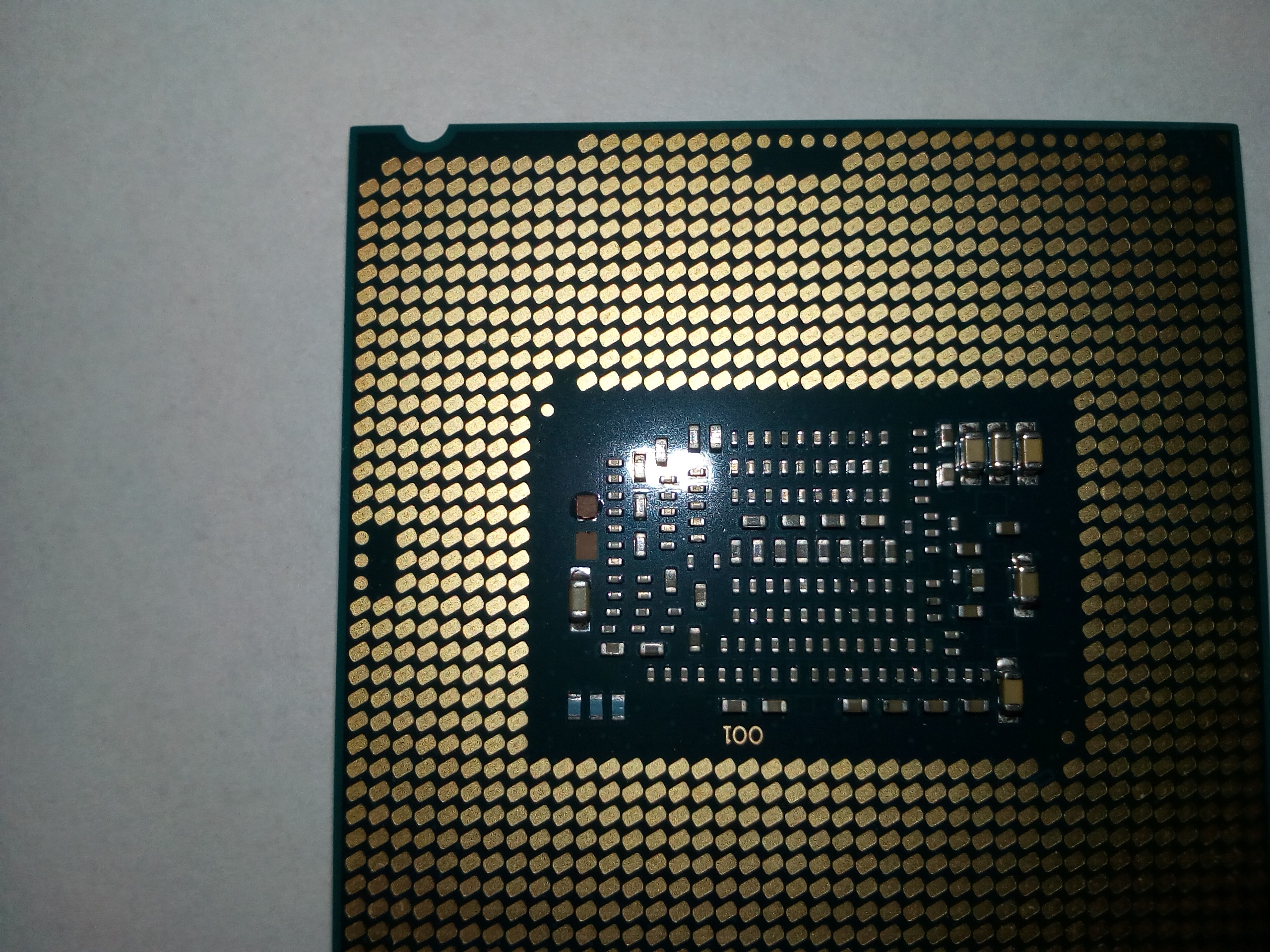

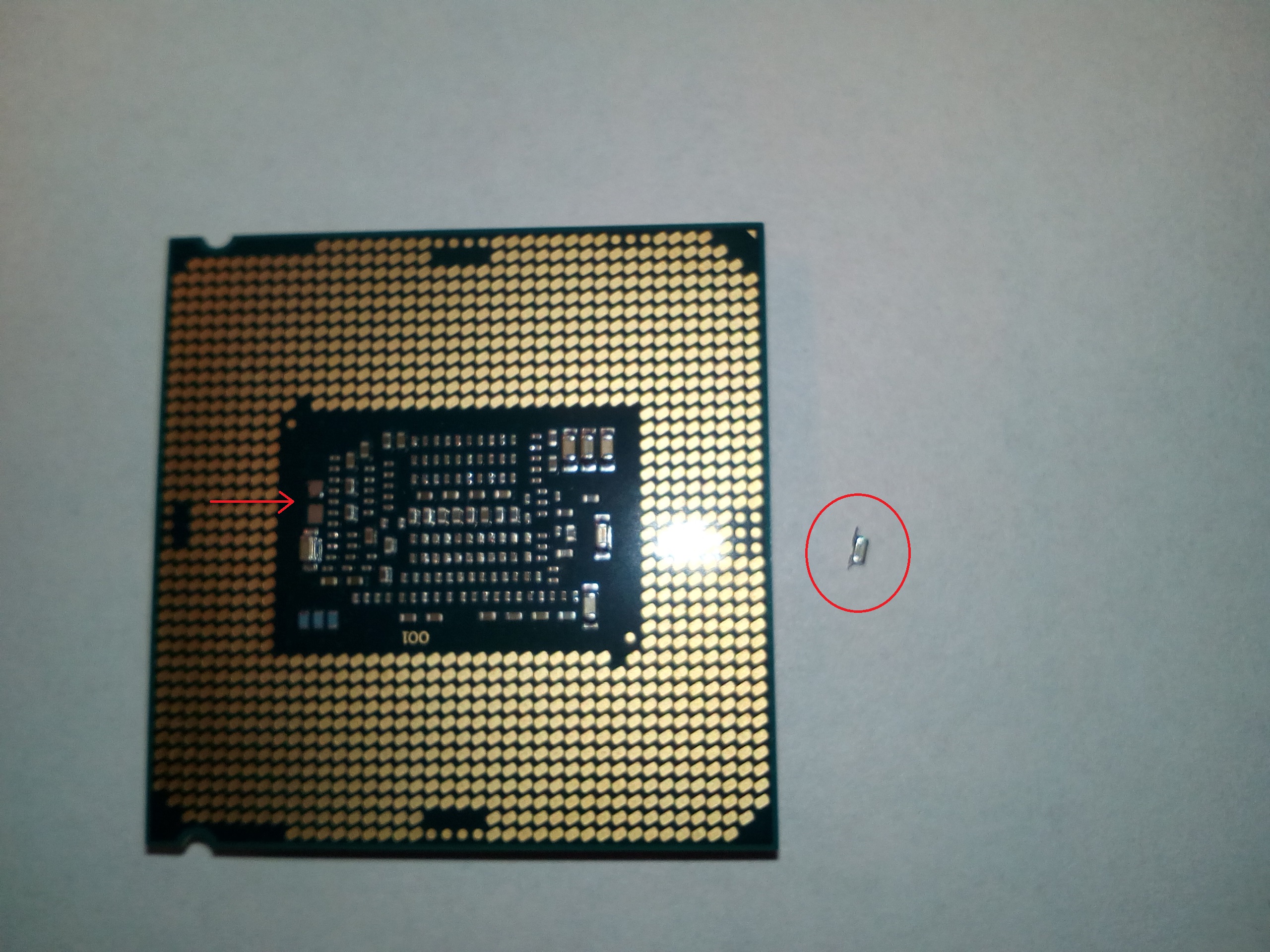

    Hi to everyone. This is my first post, so please be forgiving.
    I have Intel Core i5 7600K CPU with one SMD capacitor broken off. It happened during transport. I still have tha broken SMD capacitor, so possibly it can be soldered back to place, but the problem is, it also broke off with the tiny piece of copper pads. In one side, there is still left a tinny little fragment of it, so maybe it can work. On the other side it is unfortunately completely missing.
    But I was wondering, if those capacitors are in parallel, maybe I can solder it to another pad of the same node. Unfortunately I don't know. I am just too afraid to use ohmmetter to figure out which pads are on the same node.
    I was trying to find some schematics of Intel Core processors, but didn't find anything.
    Can anyone please help me with this? Do you thing using ohmmeter will damage the CPU?

    Re: CPU with broken SMD capacitor
    Does the CPU work?
      I wouldn't worry about it too much.
      I've used CPUs and GPUs like this with 1 or 2 busted caps. That's not to say these capacitors are not important - they are. However, most computer hardware can tolerate a certain "overhead". After all, this is why it's possible to overclock CPUs and GPUs: the manufacturer uses slightly lower speed than the absolute maximum the CPU/GPU can sustain, so that way they can guarantee that a whole batch of the same binned CPUs will work without crashing.
      So with that broken cap, most likely the noise floor on the CPU V_core will go up slightly. If you're into overclocking you *may* find that the CPU can no longer overclock as high as it did before (though, with only 1 missing cap will likely not produce any noticeable results most of the time.)
      Therefore, I second what dicky96 said: try out the CPU and see if it works. I'm willing to bet it will, unless some of other capacitors have sustained damaged too - a cracked ceramic cap can easily become short-circuited, and that will prevent the CPU from working. On that note, it's probably also best NOT to re-use that broken off capacitor, unless you have a meter and can verify that it is OK and not shorted.
      Nope, pretty sure it won't.
      Multimeters can't supply enough current when testing, so the voltage they pump out when measuring resistance will drop, especially since CPUs tend to have low resistance to ground.
        OK, Thank you for your replay.
        I will use ohmmeter to find another node on the chip to be able to solder the capacitor back and I'll post any results if successful.
          ... to find another node on the chip to be able to solder the capacitor back
          Don't!
          Unless you can check that cap for proper capacity and that it's not short-circuit, don't use it.
          As I stated above, ceramic caps can become short-circuited from too much physical force. So you may end up putting a shorted cap on your CPU, and that would surely not work.
          It's safer to try the CPU without that capacitor. If the CPU crashes or is unstable, then worry about adding that cap in. Running the CPU without that cap will *not* destroy it or hurt in any way.

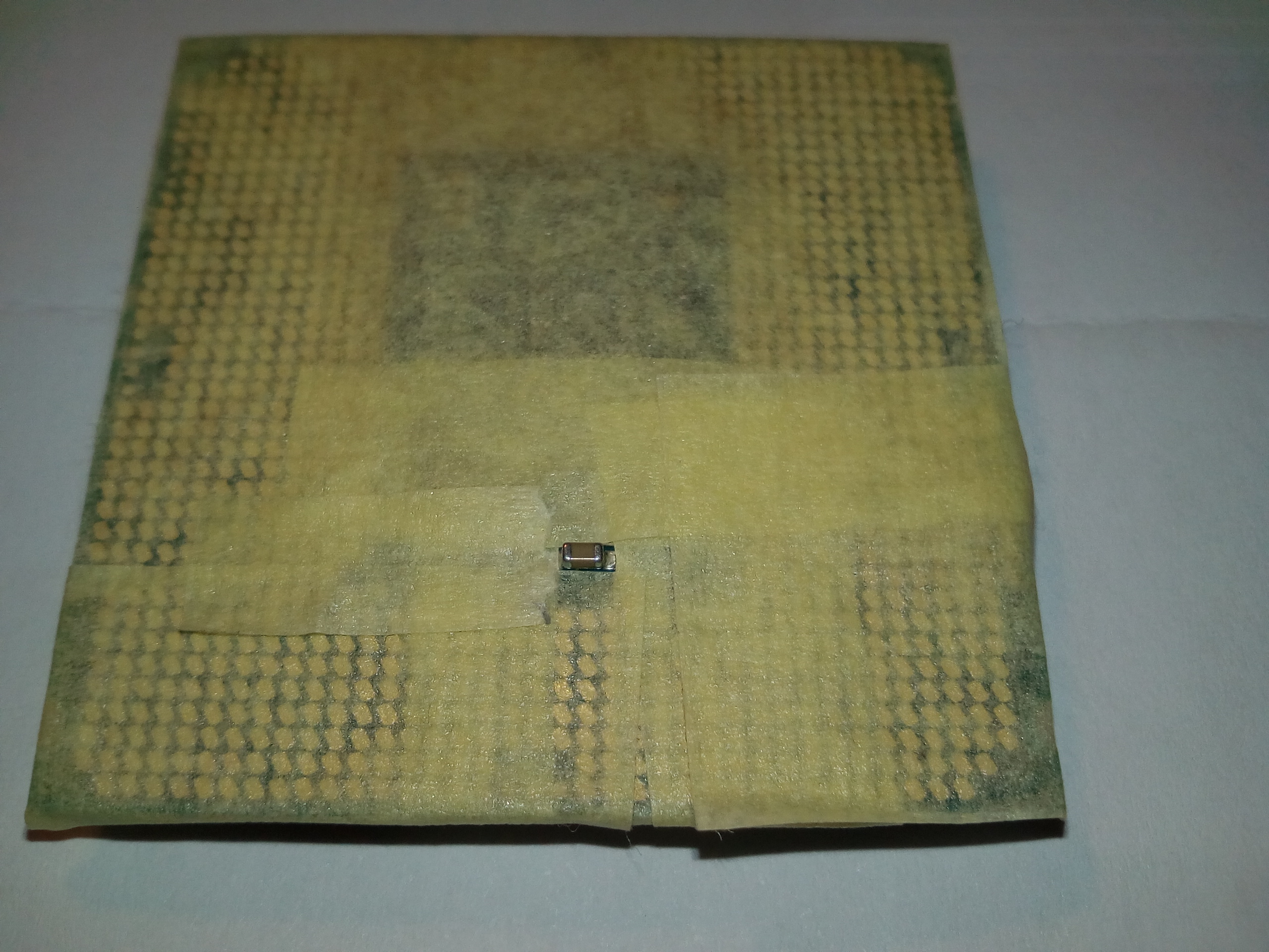

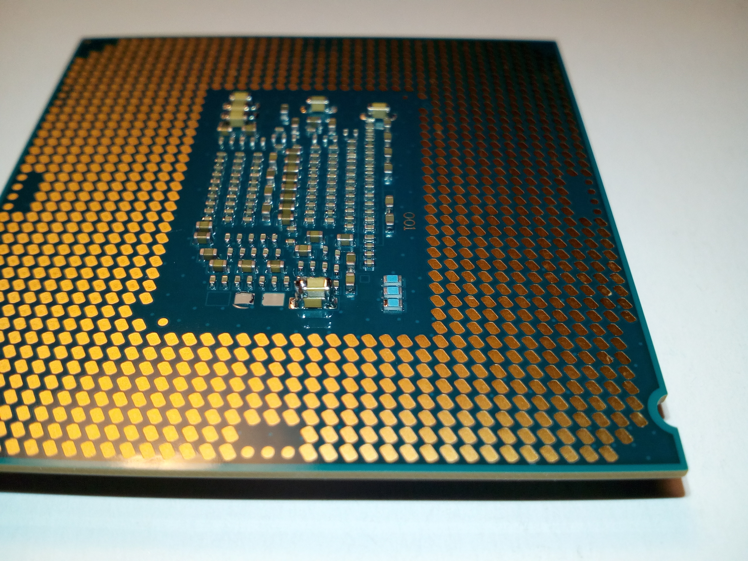

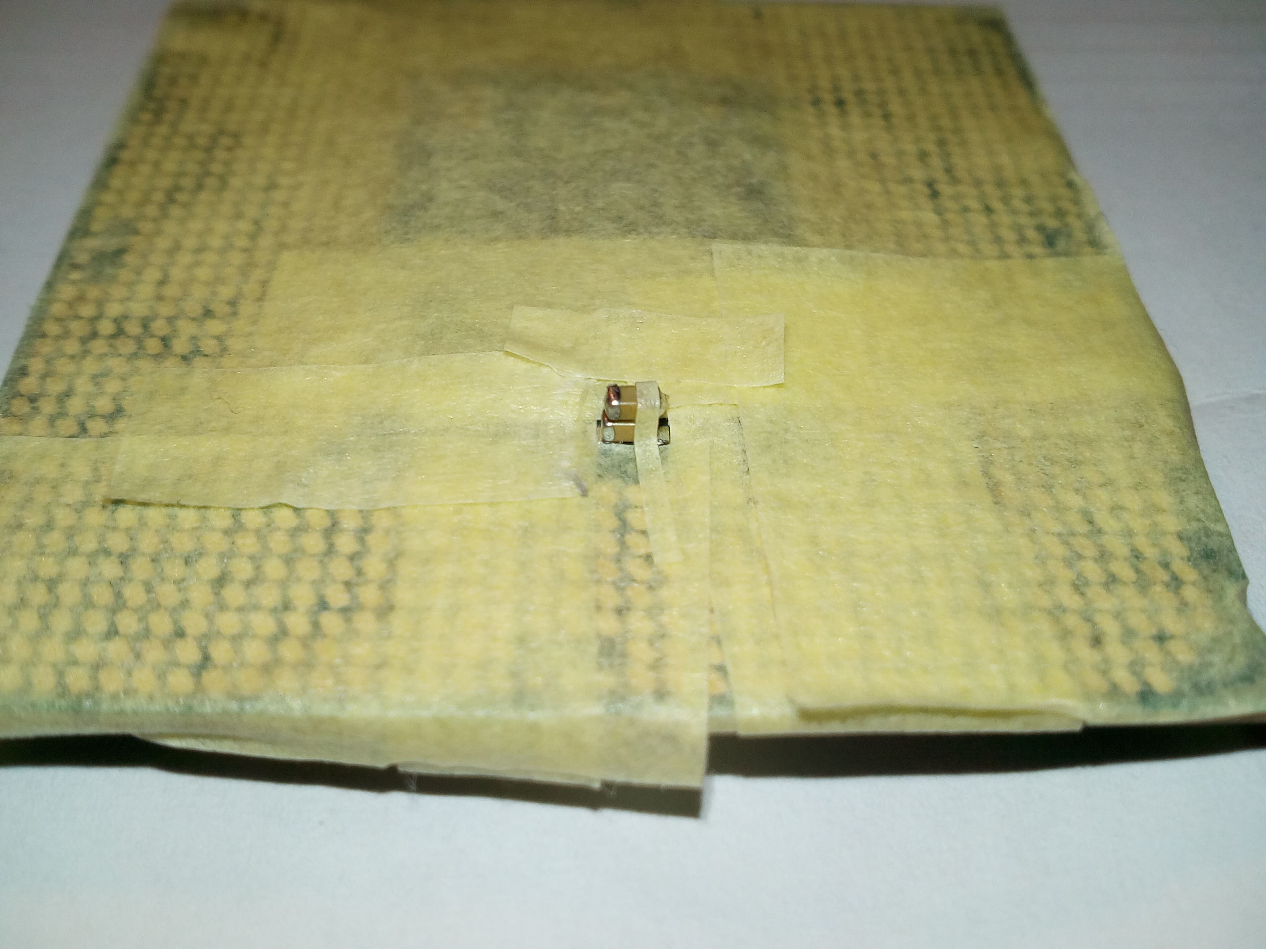

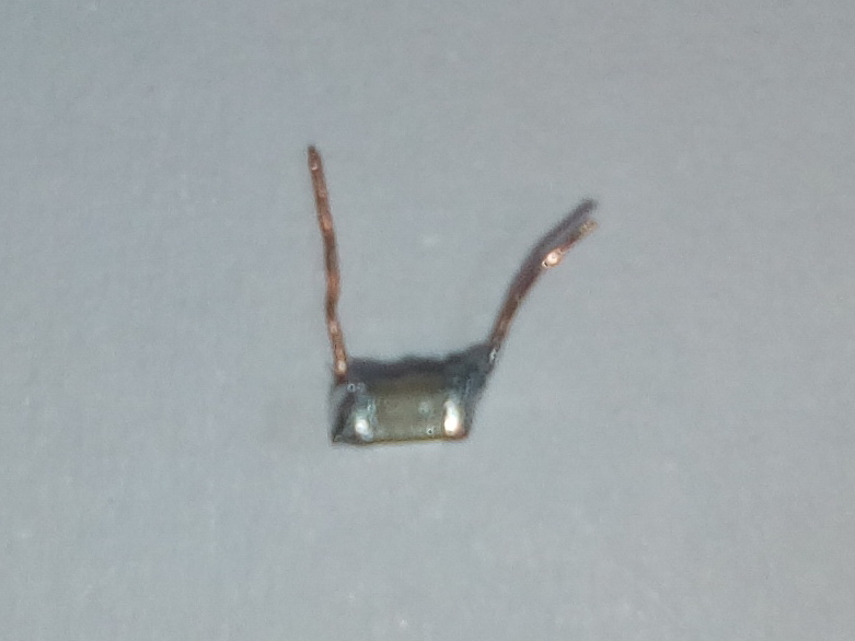

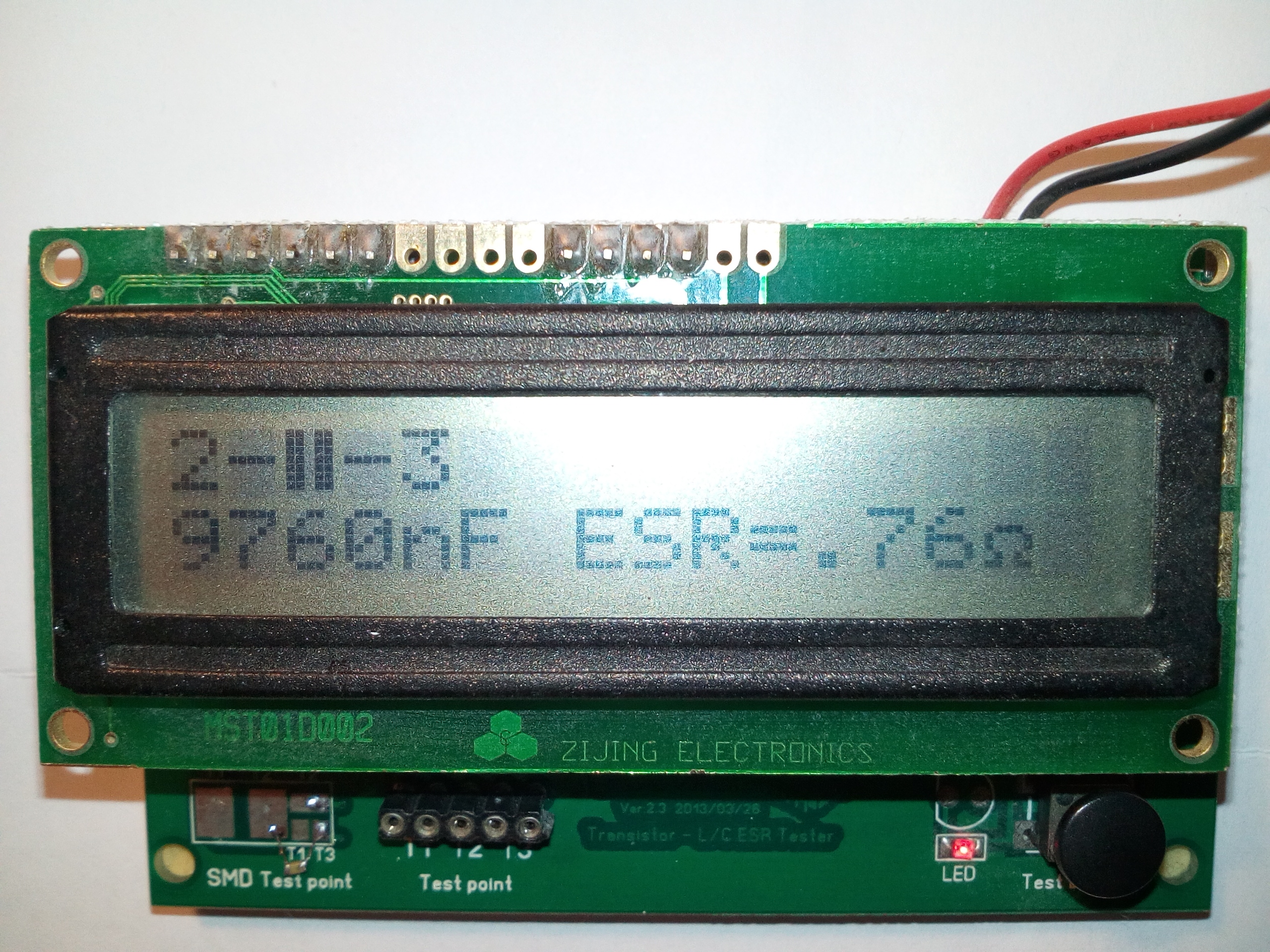

            OK, so here is the update. I took another undamaged i5 7600K CPU and using Ohmmeter I found out that the two capacitors were actually in parallel configuration.
            I measured the one that broke off using ESR Capacitance meter. It measured the capacitor correctly and showed its capacity value to be 10uF.
            So I just decided to solder it back on the CPU on top of the other one. It is a little bit off the center but I didn't want to mess with it any more. I was also afraid about soldering iron temperature. I usually solder with iron set to 320..340°C, but in the case of CPU soldering I lowered the temperature to 280°C, so it was quite difficult to get the tin melted properly.
            I tested the CPU putting it through some extensive stress workload while monitoring temperature and voltages and it passed flawlessly.
            So that's it.
            Thanks guys for your thoughts.
              That was a very inventive way to fit the broken capacitor .
              I will keep this in mind for any time I see a CPU or BGA with a capacitor broken off, and the pad(s) missing. Well done and thanks for the tip!
                My only concern is about the electrical current being conducted through the connecting copper path. I mean, the total amount of electrical energy transmitted to and from these two capacitors used to be carried through the two separate parallel copper paths. But now the same amount of energy, each time the two capacitors are charged or discharged is being transmitted though only one copper path, instead of two.
                Given the voltage value in this case to be just circa 1.5Volts and quite large capacity of the two capacitors (2x 10uF) I am afraid the only one thin copper connecting path is being stretched to the limits.
                But I am not sure about this, it's just my guess. Maybe someone with enough knowledge in this field can do the math..
                  yeah im also not confident this fix will last because stacking two smd mlccs on top of one another increases the mechanical stress on the package of the mlccs. also, i've read that excessive solder fillet height can also lead to increased mechanical stress on mlccs. over time, this stress will cause the mlcc to crack and crumble, resulting in a dead short. this may fry the cpu tho in most cases, u may get lucky when the mobo vrm and/or the psu detects a short and trips the system power, saving the cpu and maybe mobo cpu vrm from being fried.
                    I'm sorry, but isn't it quite in contradiction? If the capacitor cracks, how can it create circuit shortage? Wouldn't it create circuit break (open circuit) instead?
                    I have never in my life came across a shorted SMD ceramic capacitor.
                    I've seen a few capacitors with dry joints as a result of extensive mechanical stress and thermal cycling, but never shorted one..
