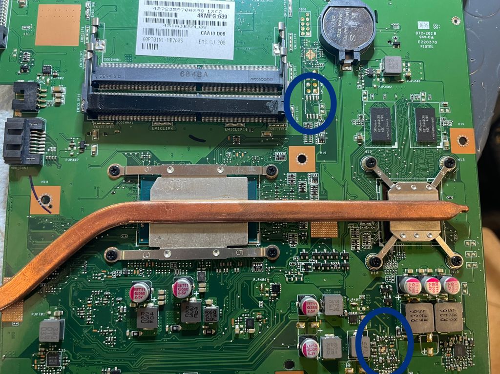

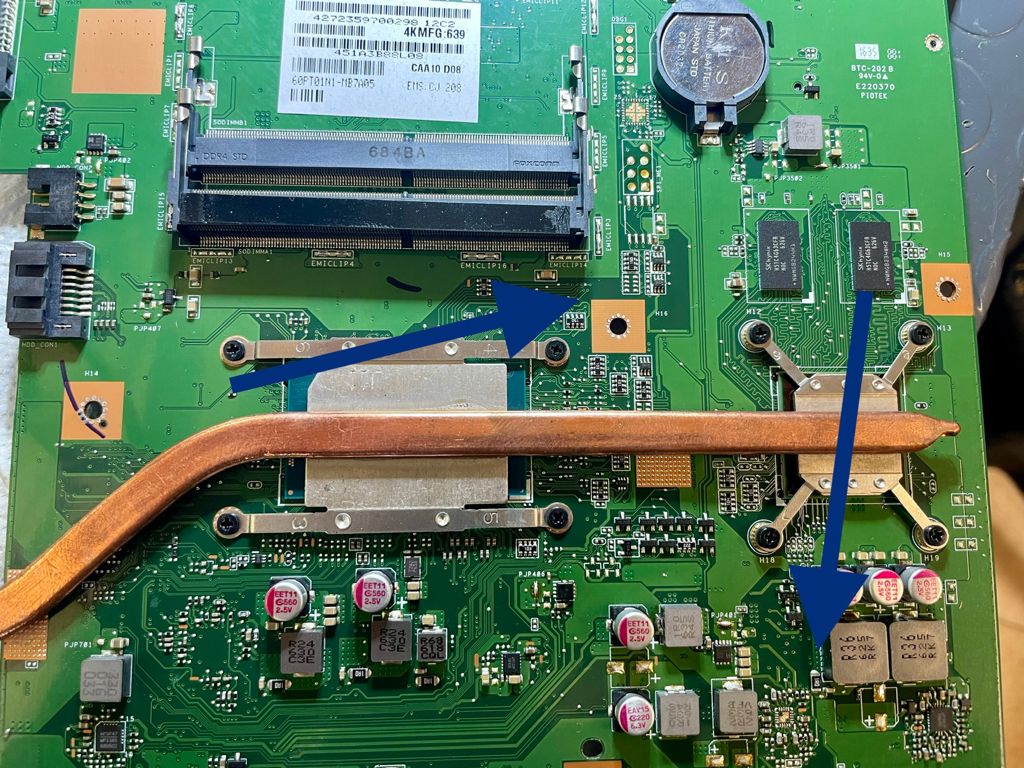

    i bought a defective asus zn220ic from ebay. The pc doesn't work. I took apart the motherboard and found that it had already been machined.
    Bios chip and a pwm in the picture are missing.
    The schematic is not available can someone help me to recognize the missing components?

    Rt3249 or tps51285 flash 24q64fv serİes

      Top one is winbond Bios Chip
      bottom is 1285A TPS51285A QFN-20 chip
      Good Luck
