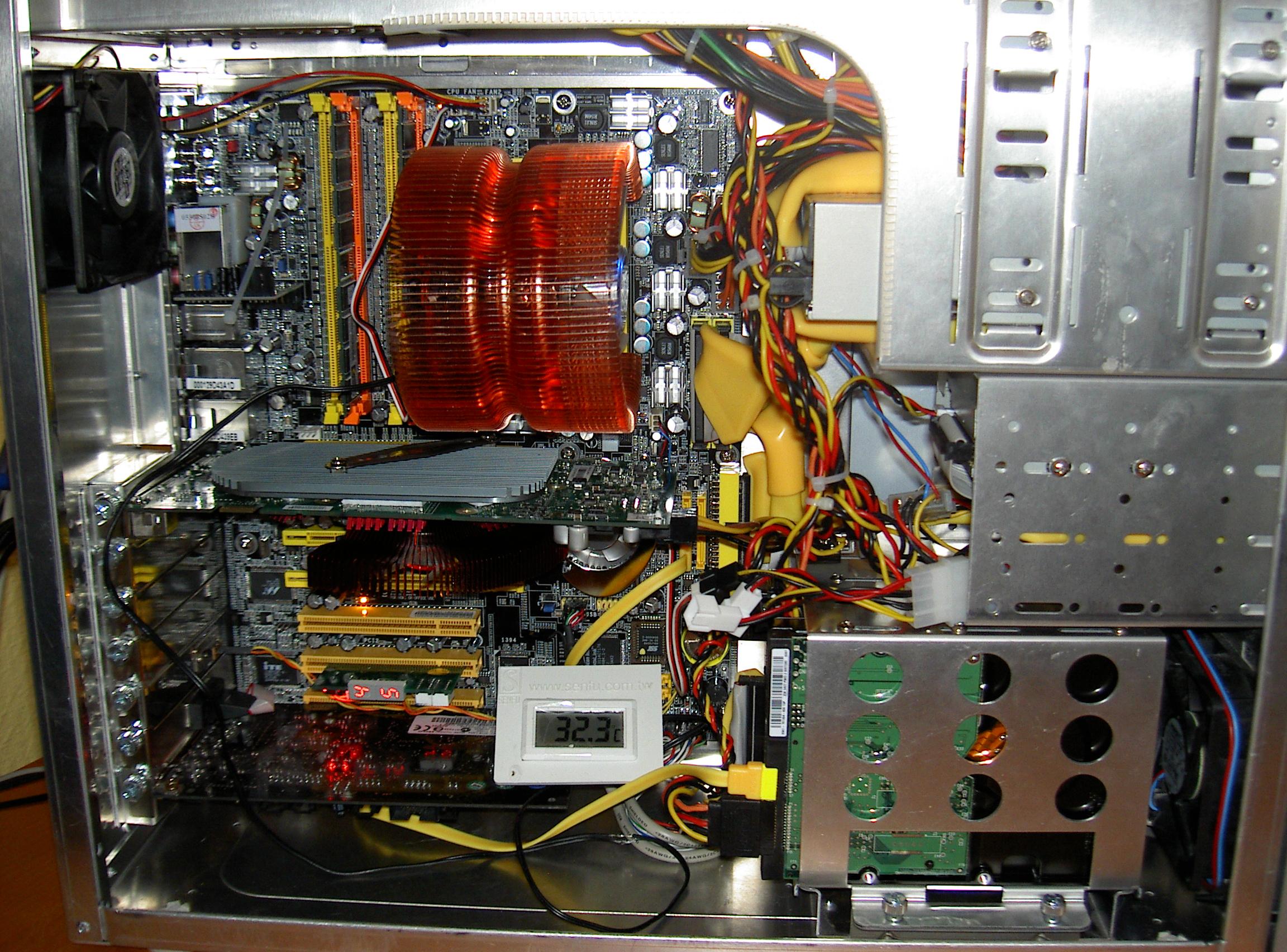

          Re: Epox 4PDA2+ rev 1.0
          Originally posted by willawake
          the buzzing is the coils, you should hear my router
          Haha, look at my patented solution, coil below PSU and between rear ports on mobo...
          Other methods to silence included nail polish lack and hut glue (like seen in most powersupplies...)
