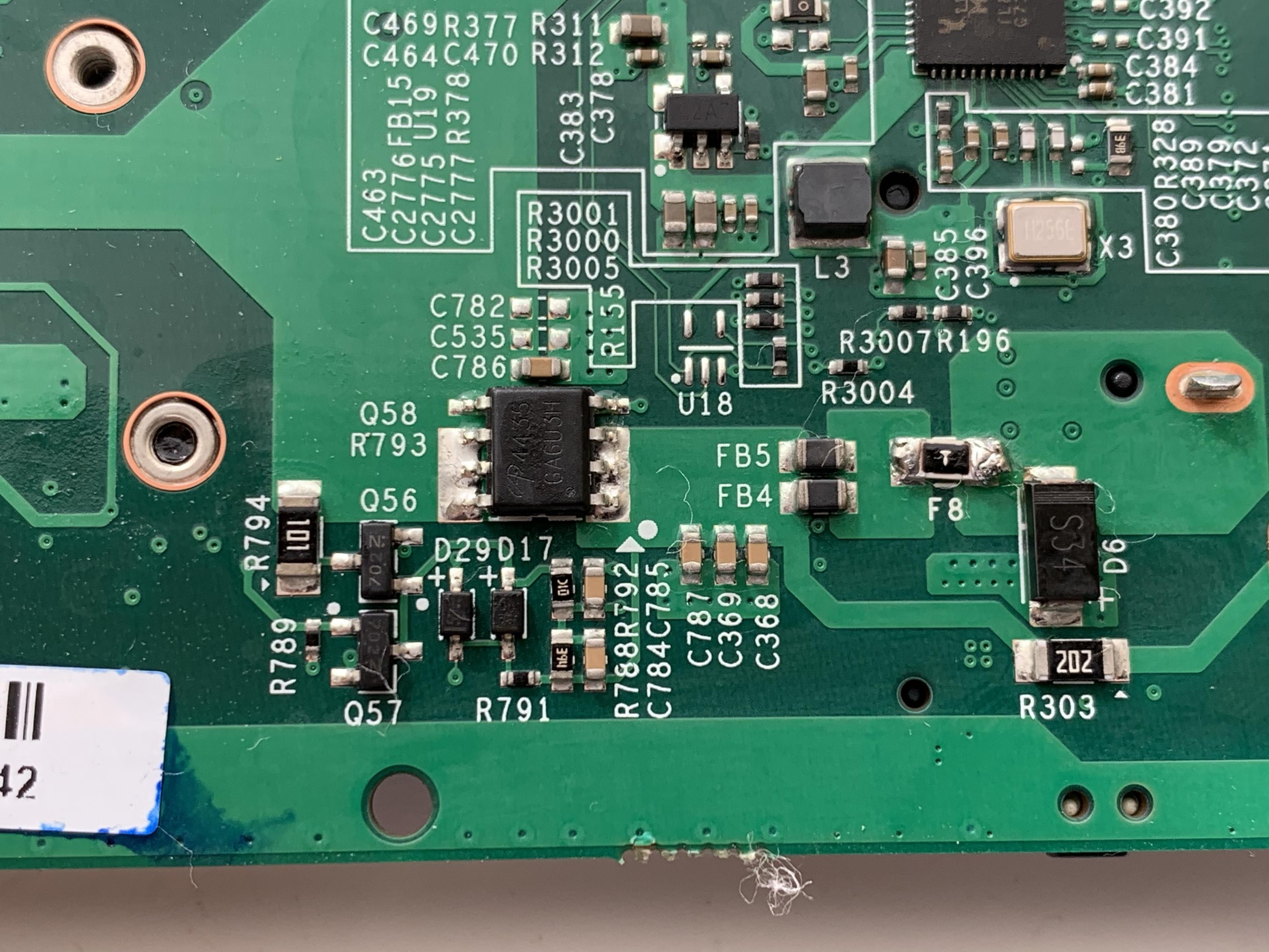

    Following on from replacing fuse i thought i should check for shorts before powering on and luckily i did.
    https://www.badcaps.net/forum/showthread.php?t=88016
    The A04435 Mosfet is shorted all over. Removed from board and short has gone and out circuit is testing short
    The capacitor above (C786) is shorting to ground both sides, removed and is good out off circuit
    The pads are shorting with each other.. Followed the 8 vias to other side and dont appear too be going anywhere.
    Is that cap supposed to have continuity or the pads?

    What part number is the motherboard,is there a schematic available for it ? .Do you have a DC bench power supply .
