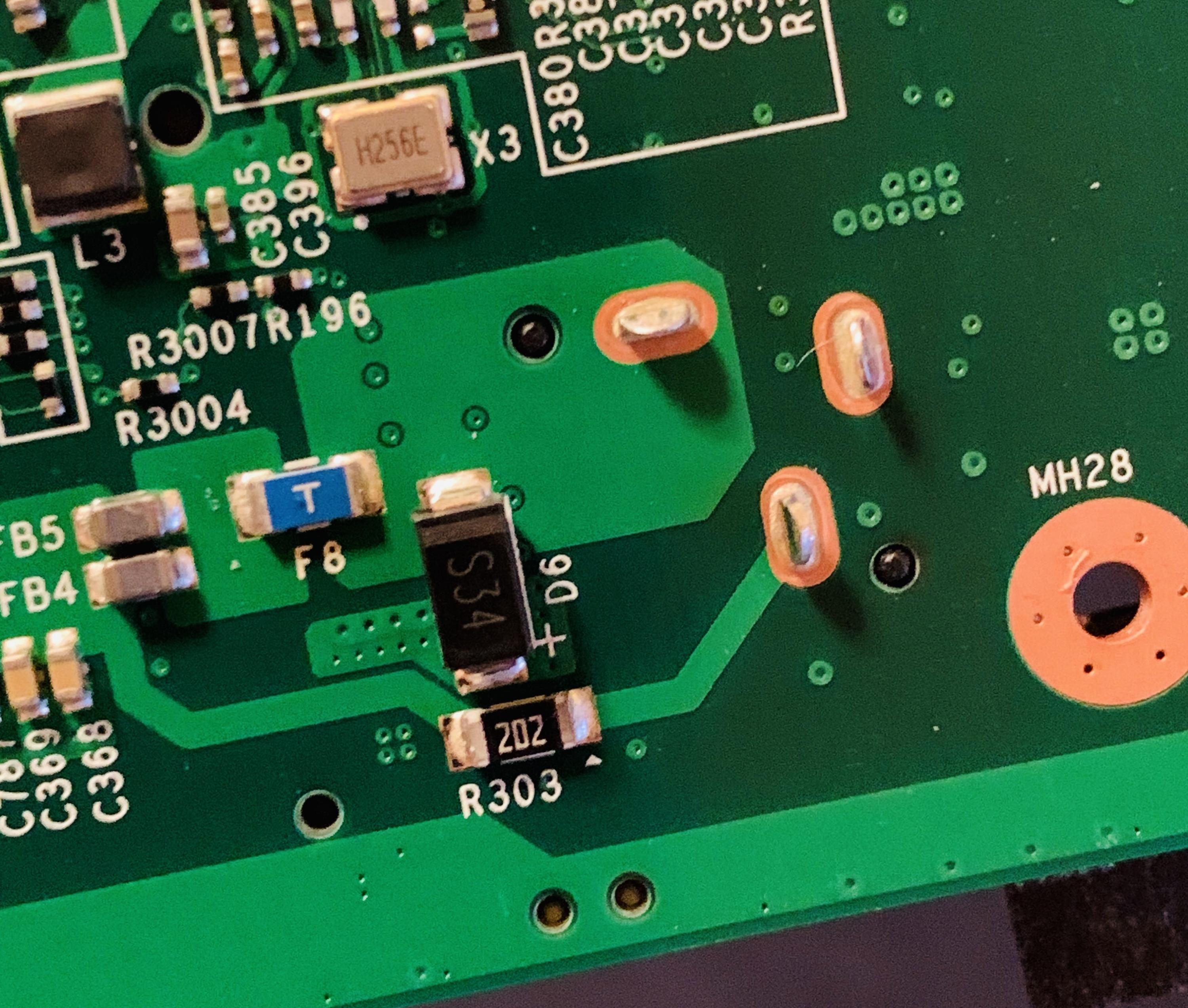

    Working on a Acer c24 760 that i got in today, guy said hes been plugging in loads of dc adaptors but wont power on lol
    Anyhow fuse is blown on the DC jack so need to replace but not the foggiest what to use?
    3.3mm x 1.5mm T on it
    charger is 19v 3.42a

      Re: Fuse identification
      Haha done that
      T = 5a
      Will it be fast of slow blow?
      Will this be sufficient?
      https://uk.farnell.com/bourns/sf-120...ing/dp/1652156
        It sounds like the guy use the wrong polarity so the fuse blow, that crowbar protection diode D6 is there in case wrong polarity is applied to the circuit.
          part number ....MC06CF 005
          very fast acting
            Will that need checking too?
            Thank you
