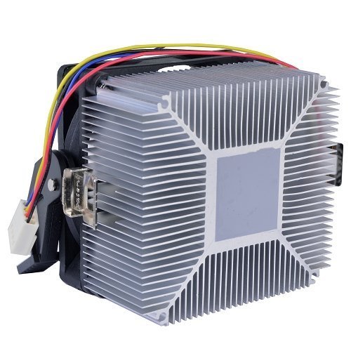

        The CPU heatsink had no paste on it - it was loose when i unlatched it.
        The heatsink is the same as the one below - i note that the square pad on it is smaller than the size of the CPU. Is that OK, or would it be better to use one with an entirely flat base that totally contacts with the entire surface of the CPU?
            WOW.
            Someone goofed up badly.
            Wonder if the CPU is OK and maybe part of the issue? After all, on AMD systems with socket 754 and newer, memory controller is built into the CPU. So even if your RAM stick is good, perhaps the CPU is screwing things up somehow.
            On that note, maybe you can get a cheap sub-$5 Athlon II X2 CPU to see if the problem remains??
            It's OK. Slightly smaller contact surface might increase the CPU temperature 1-3 degrees C more, but generally isn't an issue. Not having thermal compound is a BIG issue, though. Also, depending on what CPU you have, that heatsink may or may not be adequate. For a 65 to 90-Watt TDP CPU, that heatsink is probably OK. But if your CPU is one of those 100+ Watt TDP burners, you should consider getting a bigger heatsink (or better yet, one with heat pipes - three minimum for 100+ Watts.)
