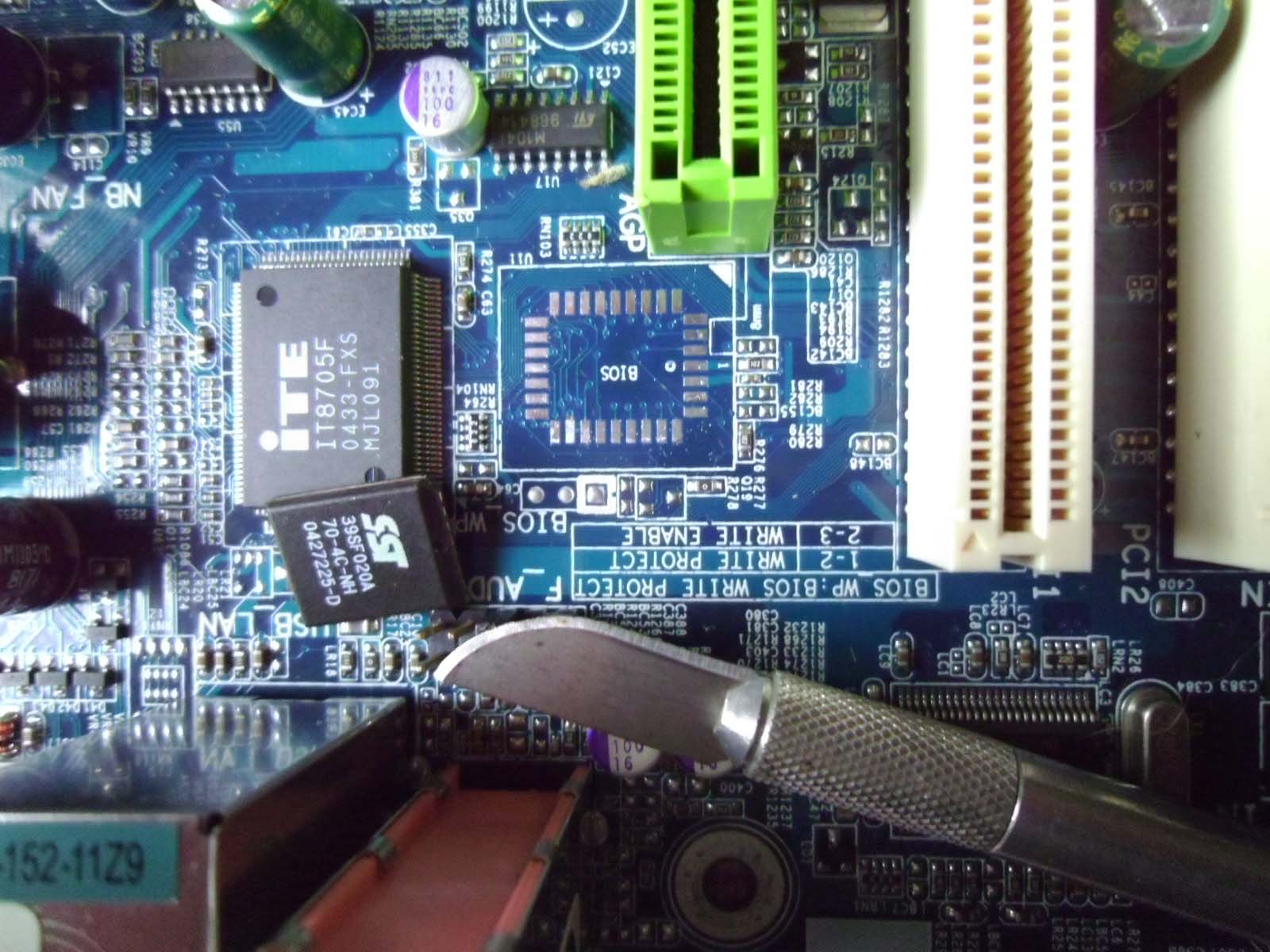

    Pretty miffed when my 7VM400M-RZ stopped working, quite a handy board for testing Socket 462 processors
    First try at resuscitation was replacing its larger capacitors, when that didn't work, all smaller ones as well
    Still dead as, so I embarked upon what would usually be my first try, reprogramming the BIOS externally

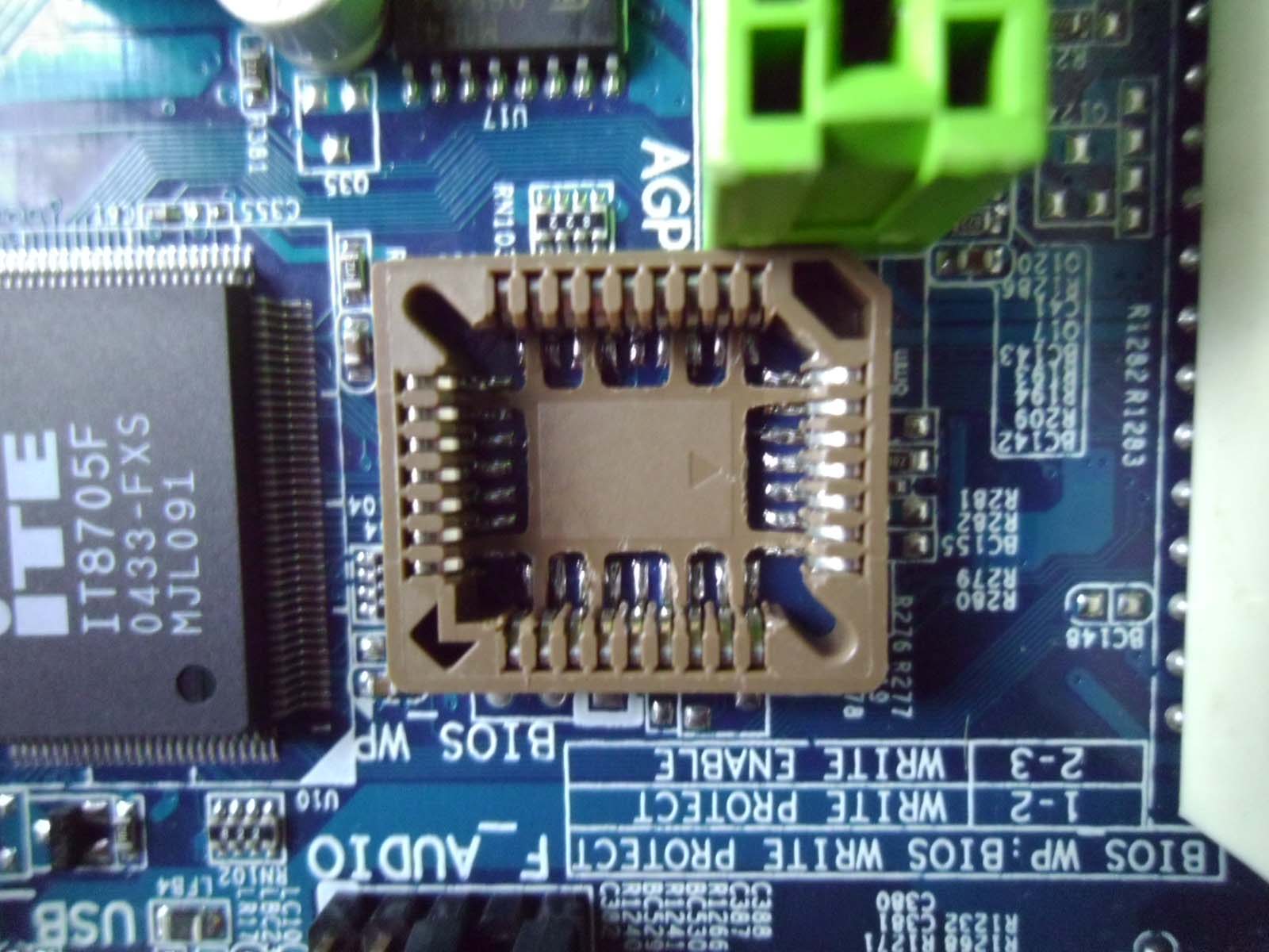

    Unfortunately Gigabyte being one of those $hit manufacturers who added a couple of cents to their profit margin by soldering BIOS chips directly to the board, I had to cut the chip out
    solder in a socket
    -then- program a replacement chip
    Still no sign of life

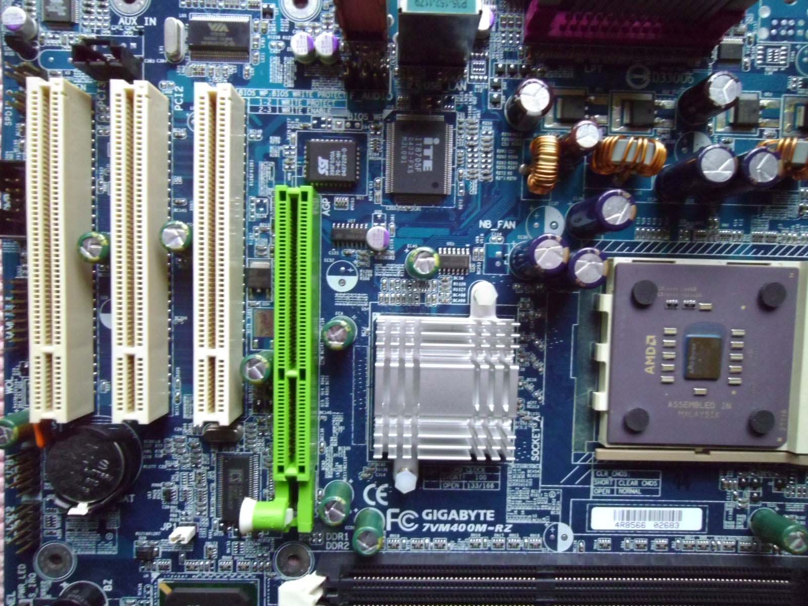

        BTW here's pics meant to be in original, which I cannot now edit

            Hmmm. I see green Sanyo caps on those pics. Are they WG or WF series? If WF, you might want to replace them. They are known dud series, though they usually bulge the same way as United Chemicon KZG - i.e. typically when they are not used for a long time.
            Other things to suggest:
            - Did you try the board with a different stick of known good RAM? What happens if no RAM is installed? Motherboard beeping errors or not?
            - Did you try re-installing the CPU. Old CPUs and sockets are usually very resilient against corrosion, but it doesn't hurt to try and reinstall the CPU a few times to clear any possible surface dirt on the contacts in the CPU socket.
            - Was the CPU and RAM inserted and removed many times before? CPU and RAM sockets aren't meant for frequent component swapping, so if you did this every time you used the board, that could be a problem too. (Though it should be noted that CPU and RAM sockets can still probably take around 100 insertion cycles safely, so I doubt this is the issue here. Still had to mentioned it anyways, not knowing the history of the motherboard or how it was used.)
            - Have a PCI POST card or can borrow one? Older boards are usually pretty decent about displaying POST codes on POST cards. The code is actually not that important, but rather seeing if the board is even trying to POST. This is handy for narrowing down the issue to voltage and/or enable signal problem or a component getting stuck at POST.

              Green caps are recent Suncon, albeit from eBay, checked on Transistor Tester before use - replaced KZGs which looked fine before removal
              Tried with several different RAM, varying from DDR266 to DDR400, seeing test CPU is a Duron 800
              No beeps if no RAM
              Duron recently removed to test on another board (ironically a PC Chips M810) to verify it was working
              CPU hasn't been changed too often - something I try to avoid, especially with sockets having flimsy HSF clips
              POST card's LED card showed No Signal as I recall - reason I wanted to try another BIOS chip
              It's winter here in Southern Hemisphere - I'll probably try ChaosLegionnaire's suggestion when my garage becomes habitable again
