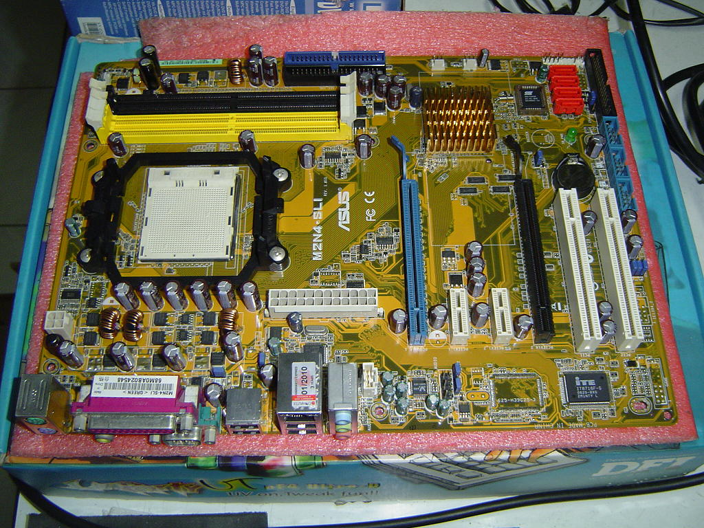

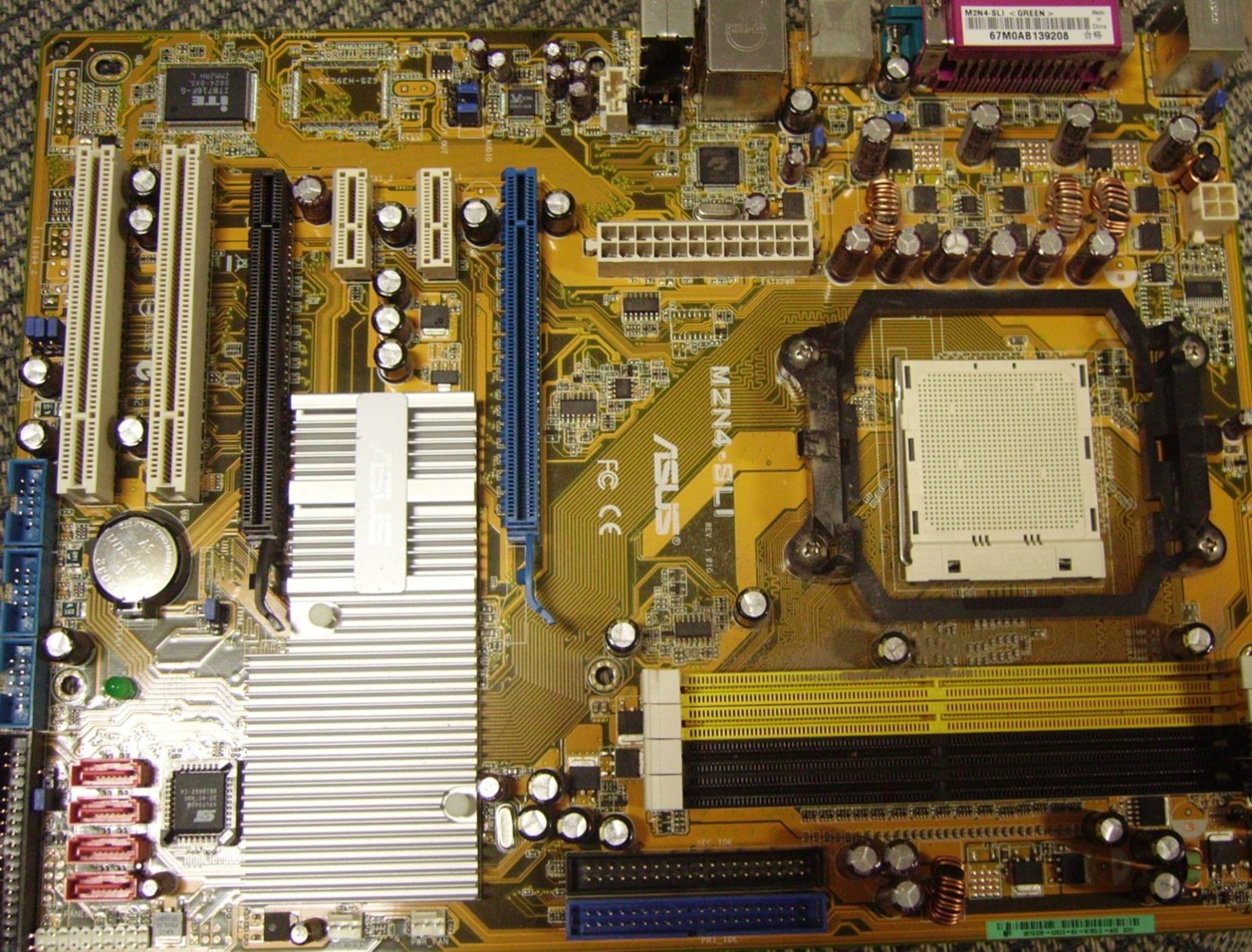

    I recently aquired this motherboard from work. According to the customer, it would post sometimes but not others times (although I couldn't get it to post at all at work). Caps are as follows
    4x 1000uF 16v Chemi-Con KZG
    9x 1500uF 6.3v KZG
    1x 470uF 16V KZG
    2x 1800uF 6.3v Panny FJ
    25x 6.3v 820uF FJ
    Obviously, the KZG need replacing. I have Panny FJ for the 1500uF 6.3v, FL for the 1000uF 16v and Sanyo WG for the 470uF 16V.
    Let me know if any of the replacements aren't suitable.
  • c_hegge
    • Sep 2009
    • 5219
    Re: Asus M2n4-sli
    Done the re-cap. and it seems to POST reliably now, although it takes ~30 seconds for the first power-up since the 5vsb was removed. I'm currently installing windows on it. I'll let you know how it goes with the Prime95 stress test.

        I've got an identical M2N4-SLI board from my friend.
        it can not POST (BIOS beep not find any display adapter, beepppppp....beep.beep.)
        most of caps on my board are Chemicon KZG.
        All of them has no sign of bloat or any damaged.
        Could it possibly back to live, if I recaps all KZG to Panasonic.FJ?
        Pics will post later

          Re: Asus M2n4-sli
          Yes. KZG can die without bloating

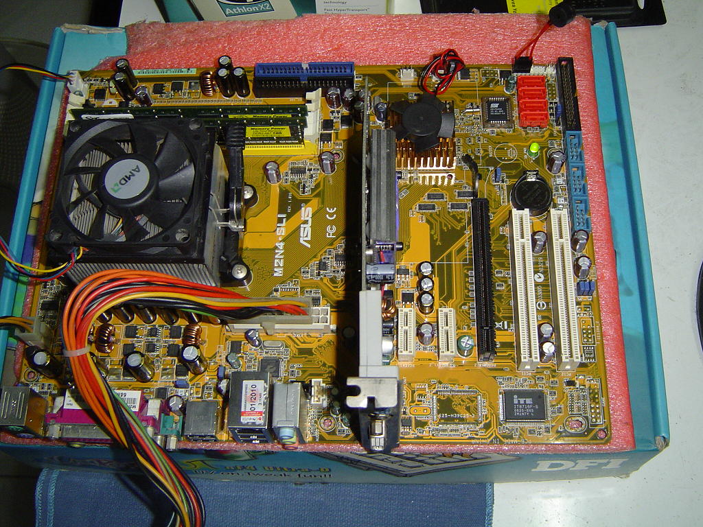

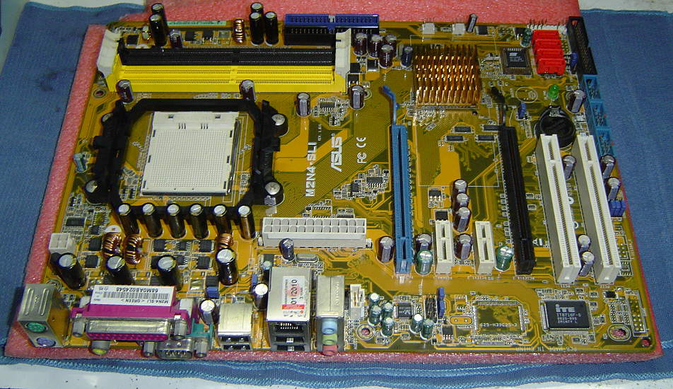

            This one is mine, full of KZG. too many 820/6.3V caps
            Where should I start to recaps for symptom cannot detected display adaptor?
            | AMD Phenom II X2 550BE | GIGABYTE GA-MA790FXT-UD5P | GeIL DDR3 Ultra 2x2GB 1600C7 |
            | XFX GTS250 DDR3 512MB | Dell H525EF-00 | Lancool PC-K62 Black | Samsung 2232GW |
            | 2xWD7500AYYS | 2xHD322GJ Raid0 |

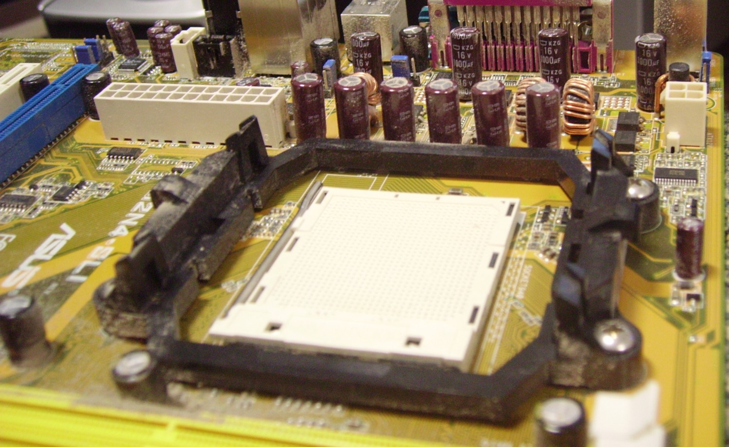

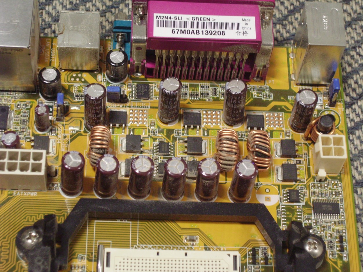

            • c_hegge
              • Sep 2009
              • 5219
              Re: Asus M2n4-sli
              Start with CPU VRM (All the caps on my second pic at the start of the thread). If that doesn't help, then replace the others.

                        I've done recaps around CPU socket.
                        4x1000/16V.Chemicon.KZG -> 4x1500/16V.Panasonic.FL (ATX12V ?)
                        6x1500/6.3V.Chemicon.KZG -> 6x1800/6.3V.Panasonic.FL (Vcore ?)
                        3x1500/6.3V.Chemicon.KZG -> 3x1800/6.3V.Panasonic.FL (near IDE connectors)
                        1x470/16V.Chemicon.KZG -> 2x470/16V.Samxon.GK (near PCIe slots.)
                        I have no AM2 processor now , I will get one tomorrow.
                        Any suggestions welcome?

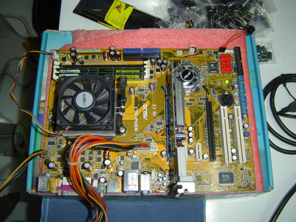

                        • POM_MJ
                          • Aug 2009
                          • 228
                          Re: Asus M2n4-sli
                          Yeh!, Its work!.
                          I will test it's stability next time after find a better chipset heatsink.
                          Thankyou Badcaps.net

                                      • POM_MJ
                                        • Aug 2009
                                        • 228
                                        Re: Asus M2n4-sli
                                        Originally posted by c_hegge
                                        It's supposedly conductive, although I have done it before and not had problems.
                                        Originally posted by stj
                                        i saw a guy power one up sitting on one of the silvered bag's once and it arced & blew the board!
                                        wow, I will more careful with these.
                                        btw, stop changing the chipset heatsink!
                                        get a really tall sink that dont need a fan - it's more reliable.
                                        the tiny fans die, they have been the cause of several dead motherboards here.
                                        my friend cannot find the original heatsink.
                                        the gold tall sink in the pics that's CM blue ice, I've moved its fan to NF4-D.
                                        I will find a big tall one with fan included for safe.
                                        thanks for suggestions.
