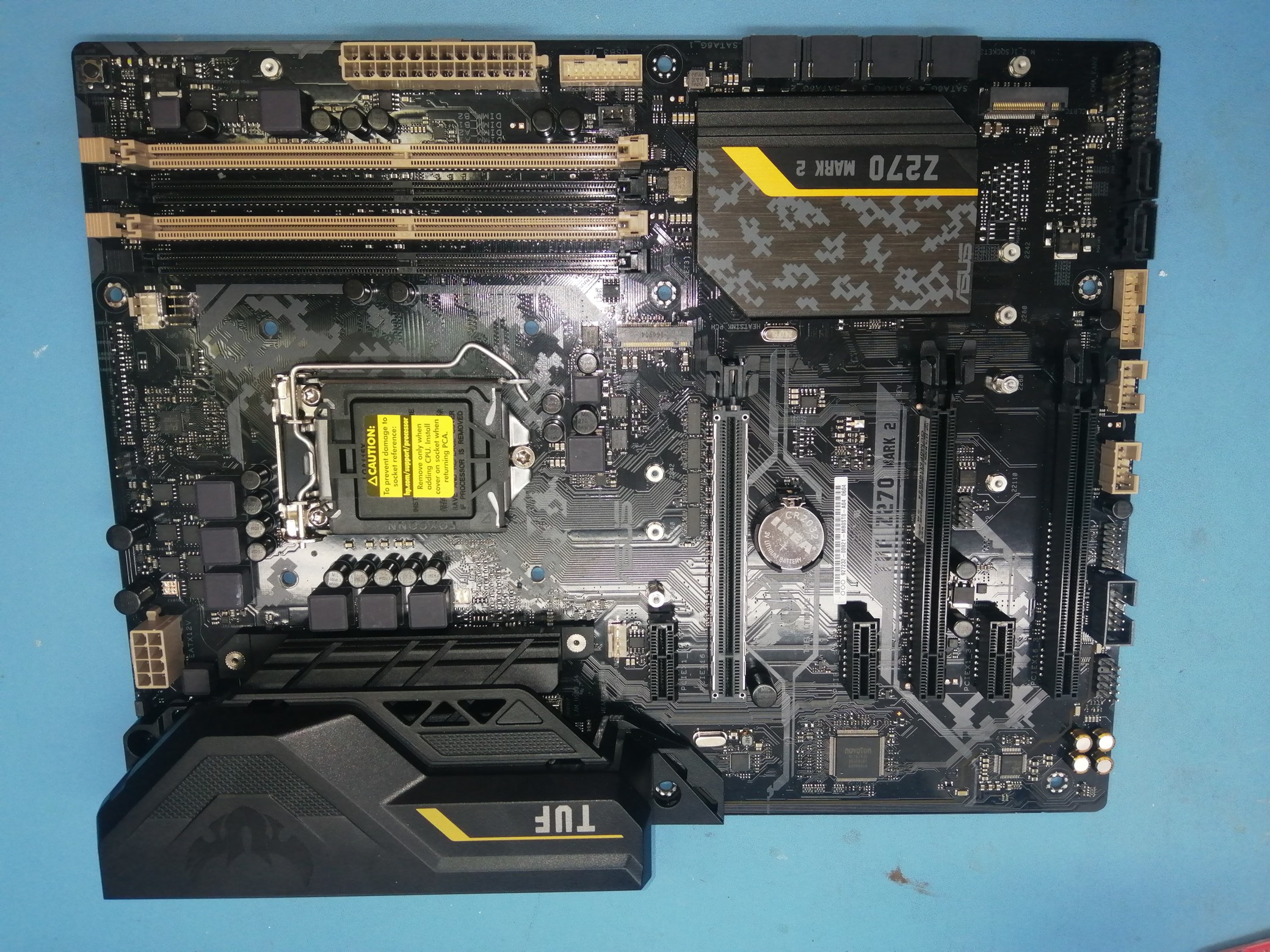

    Known good compatible Celeron G3900 CPU and all pins in the LGA1151 socket look good under a microscope
    Nothing is getting hot and no visible damage

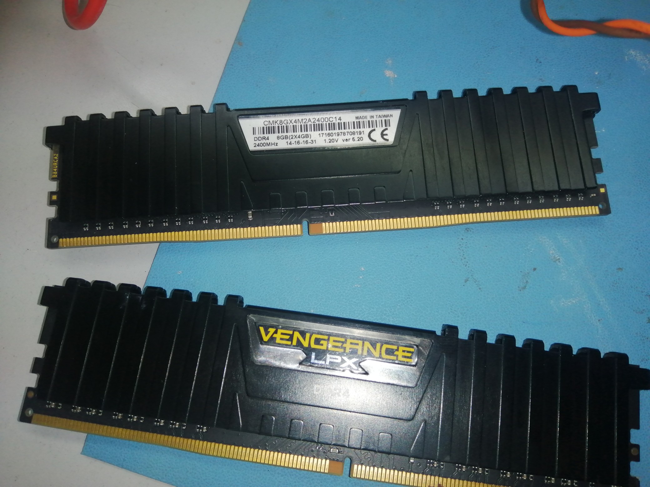

    Tested with No RAM, with pair of Corsair Vengeance LPC 2400MHz DIMMS and also with single DIMM in any slot.

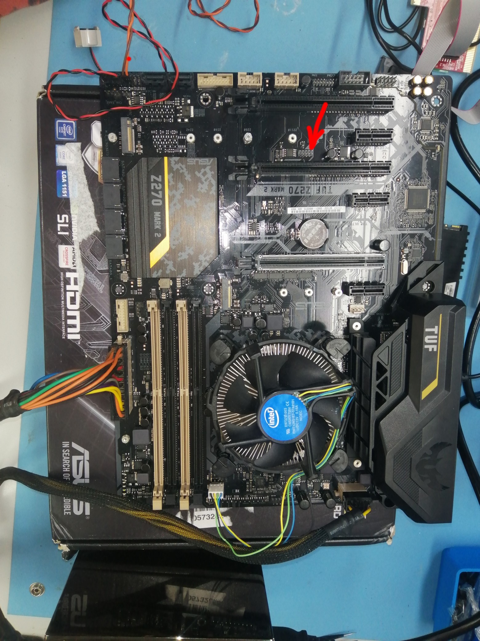

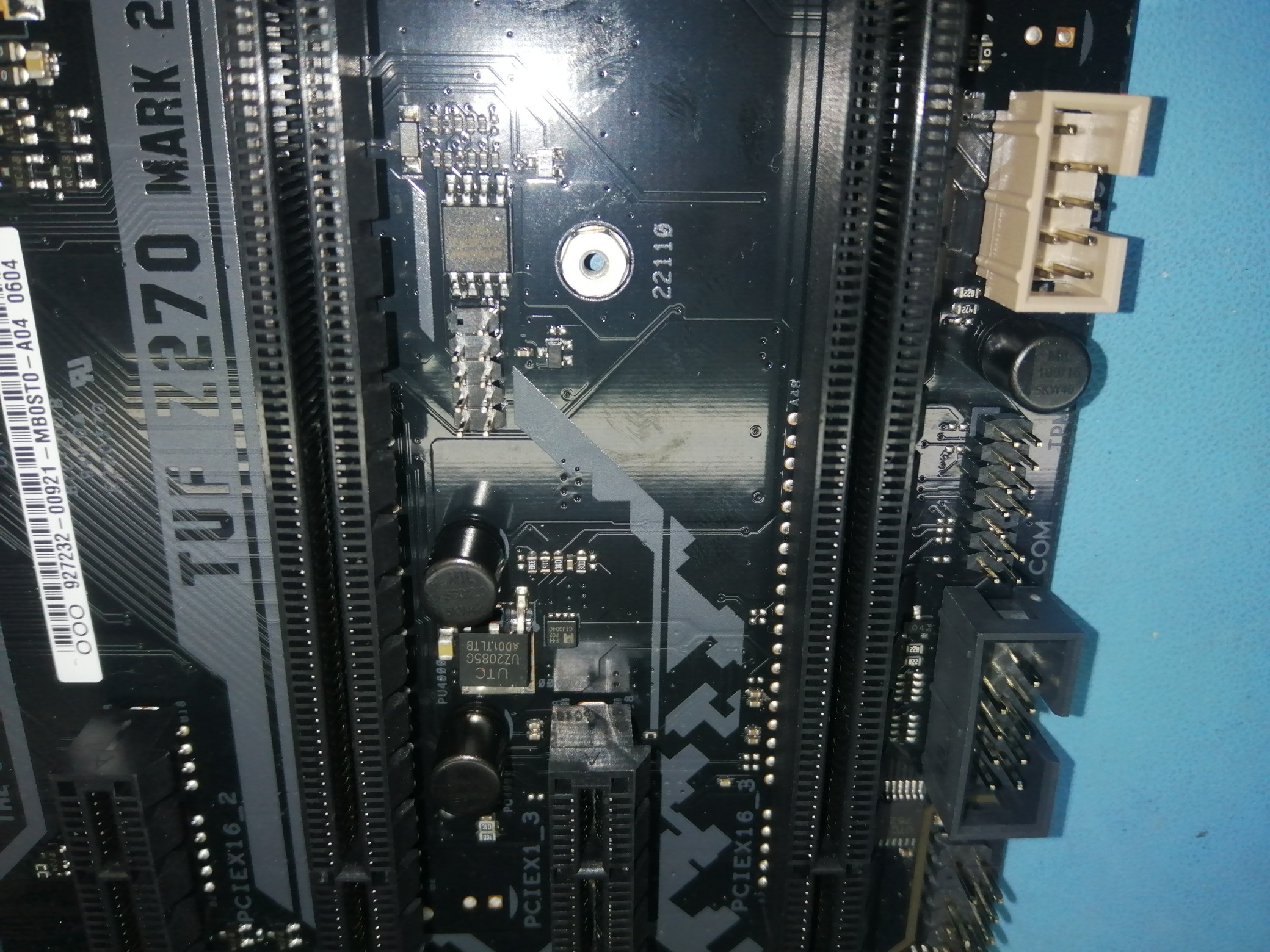

    There is a little 9 pin connector (marked with red arrow in pics) and this is not mentioned in the user manual. I thought perhaps it is an LPC debug port but when I connect my diagnostic card to that (tried various orientations) the board will power on (with or without RAM) but no longer beeps without RAM
    Why do I get no POST diagnostic code when the motherboard it is obviously active?
    Do these sort of boards output the POST codes in some other way than to the PCIe slot?
    Can these modern boards be really finicky with DDR4 RAM type? The ones I have are known good, as is the CPU and the speed of the DDR4 (2400MHz) should be compatible with this board according to google search but could that be the problem.
    Pics attached

    I'm not 100% sure, but this 9-pin connector may be the interface for bios flash. Is there a bios IC near this connector?

      The 9 pin header indeed looks like an SPI header to flash the BIOS in-circuit (but I rarely have luck doing so, so I always take the SPI ROM chip out). It is right next to an SPI ROM that probably contains the BIOS.

        I removed the BIOS and programmed it with this file from ASUS website
        https://www.asus.com/us/Motherboards...HelpDesk_BIOS/
        The file wasn't a BIN or ROM file it said it was a CAP file, whatever that is but my PC said it was the same size (16Mb) as the backup I made of the original ROM before erasing it, and the programmer happily wrote it to the ROM and verified it/.
        Anyway once I wrote that to the BIOS the motherboard would not boot - it would start and the CPU light came on solid Red but it no longer flashed the orange RAM LED or beeped with no RAM fitted
        I had a look the the backup file and the one I downloaded with a hex editor and figured out the downloaded file had some Kilobytes of shite at the start of it. So I edited the file to remove that and then programmed the Bios again with the edited file.
        There are some differences between the edited download and the original file.
        Now it boots again and beeps with no RAM fitted but it still doesn't boot or beep with RAM (I get no video output). I checked the Caps Lock LED on a USB keyboard, it does not illuminate either so I can say for sure the board is not fully booting once RAM is fitted.
        As before, if I press the MEM OK button the board goes through the sequence of testing different RAM settings as described in the user manual.
        That little 9 pin connector I found near the BIOS does in fact connect to the BIOS pins. So where do I find this TPM header to attach a POST test card to get some better idea what is going on with this?

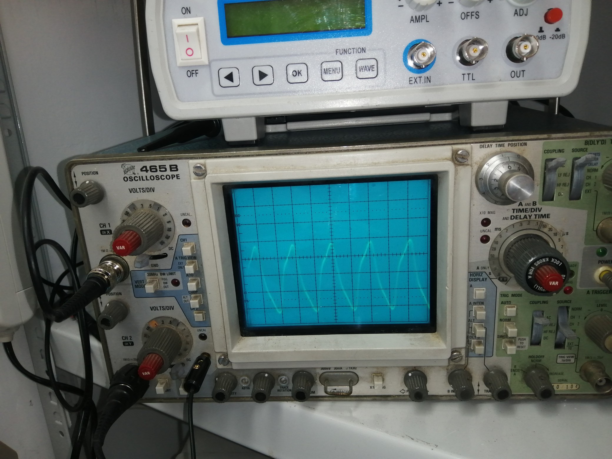

                        I thought it would be a good idea to probe around the TPM header to see if there was any activity there when the board is doing its MEM OK test
                        All i found is pin 14 is 0V, and all the others are 3.3V apart pin 5 which has a high frequency clock on it with a duration of around 0.04uS (around 25MHz) according to what I can see on my trusty old 465B scope
                        So there seems to be no data there for a debug card to read, unless there is a quick burst of data at power on, and I am missing it.

                                      I was using this motherboard yesterday to make a youtube video (simulated high side MosFET short on Vcore) and I spotted one pin in the LGA socket looked a little out of line
                                      After the video I had a look at that and thought it could just possibly be shorting to the next pin when the CPU was in place so I straightened it.
                                      I now think that RAM Channel 2 of the DDR sockets is working because I get the same error code on the TL460s with a single DIMM in A2 or a pair of DIMMs in A2+B2
                                      So that is an improvement. I am now getting error A0 and the VGA LED lit on the TL460 regardless of the RAM configuration. Interestingly, the VGA diagnostic LED integrated on the motherboard does not light.
