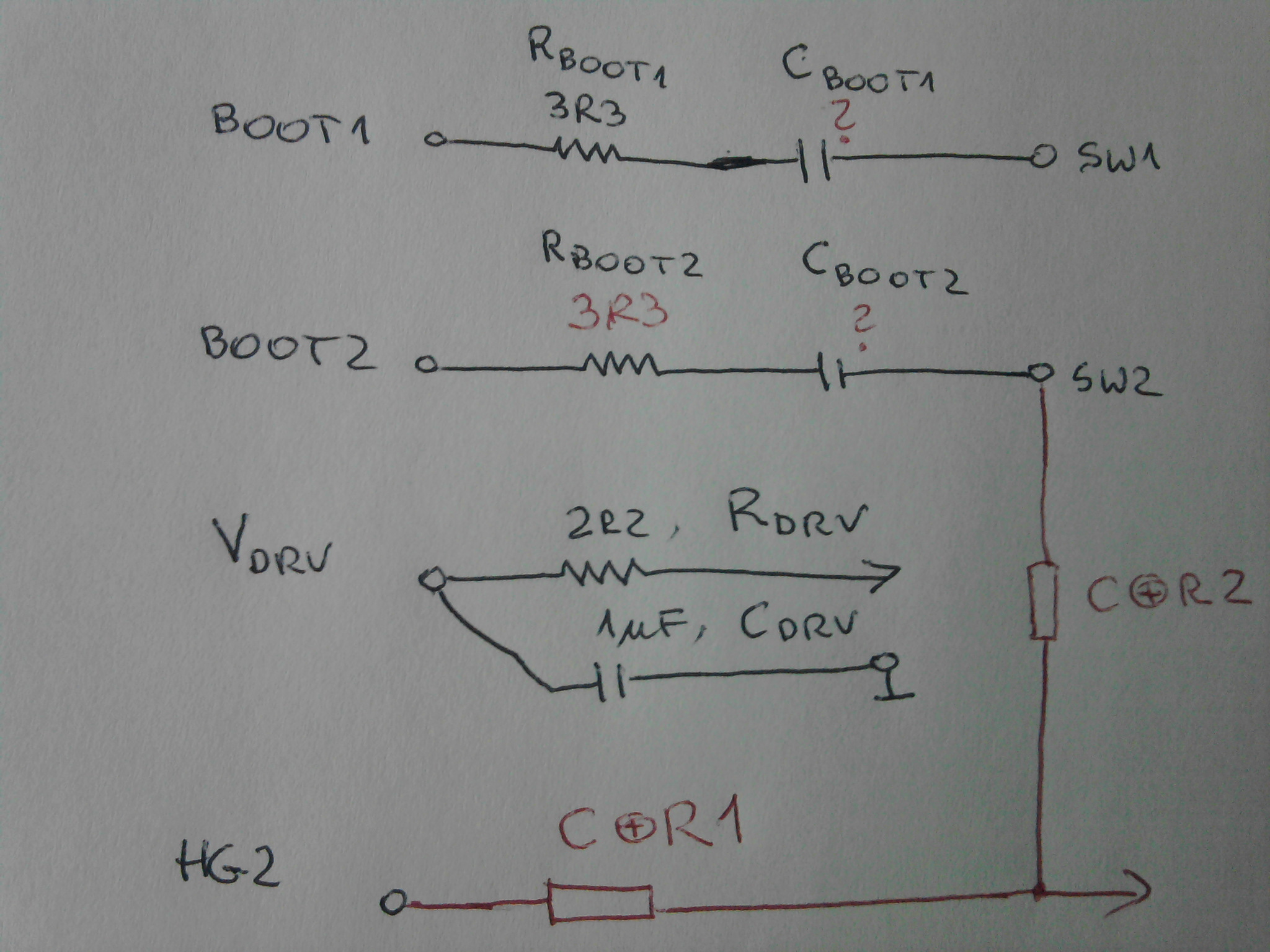

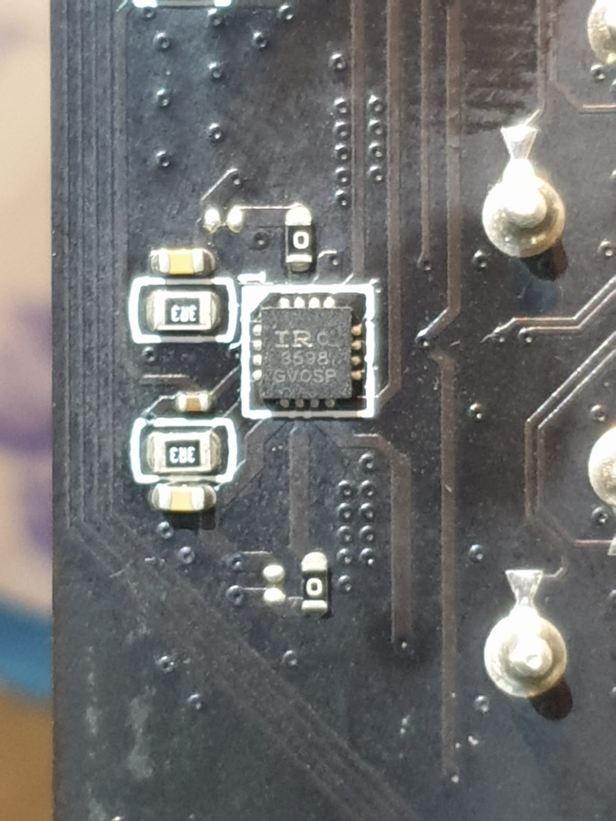

    Hi, I have MSI X570-A Pro motherboard with damaged 5 components.
    The problem is centered in the neighbourhood of IR 3598 on the bottom side (solder side) of the mobo. The chip is located above backplate near the edge of the board (left chip). First picture is a shot of this place.

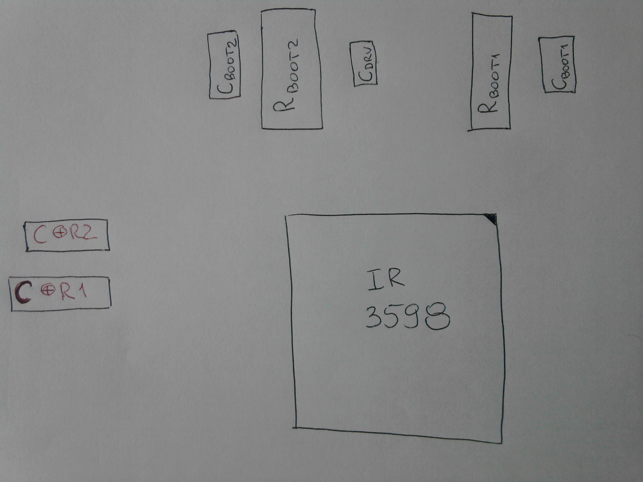

    Second picture is my guessing of circuit diagram of connected to IR 3598. Third picture is my guessing of component location. C+R is a designation of capacitor or resistor.
    I need value of components: C+R1, C+R2, CBOOT2, and reassuring of RBOOT2=3R3 and CDRV=1uF. I can't find any schematics for this board. I would be grateful for schematics of the mobo or value of these components.

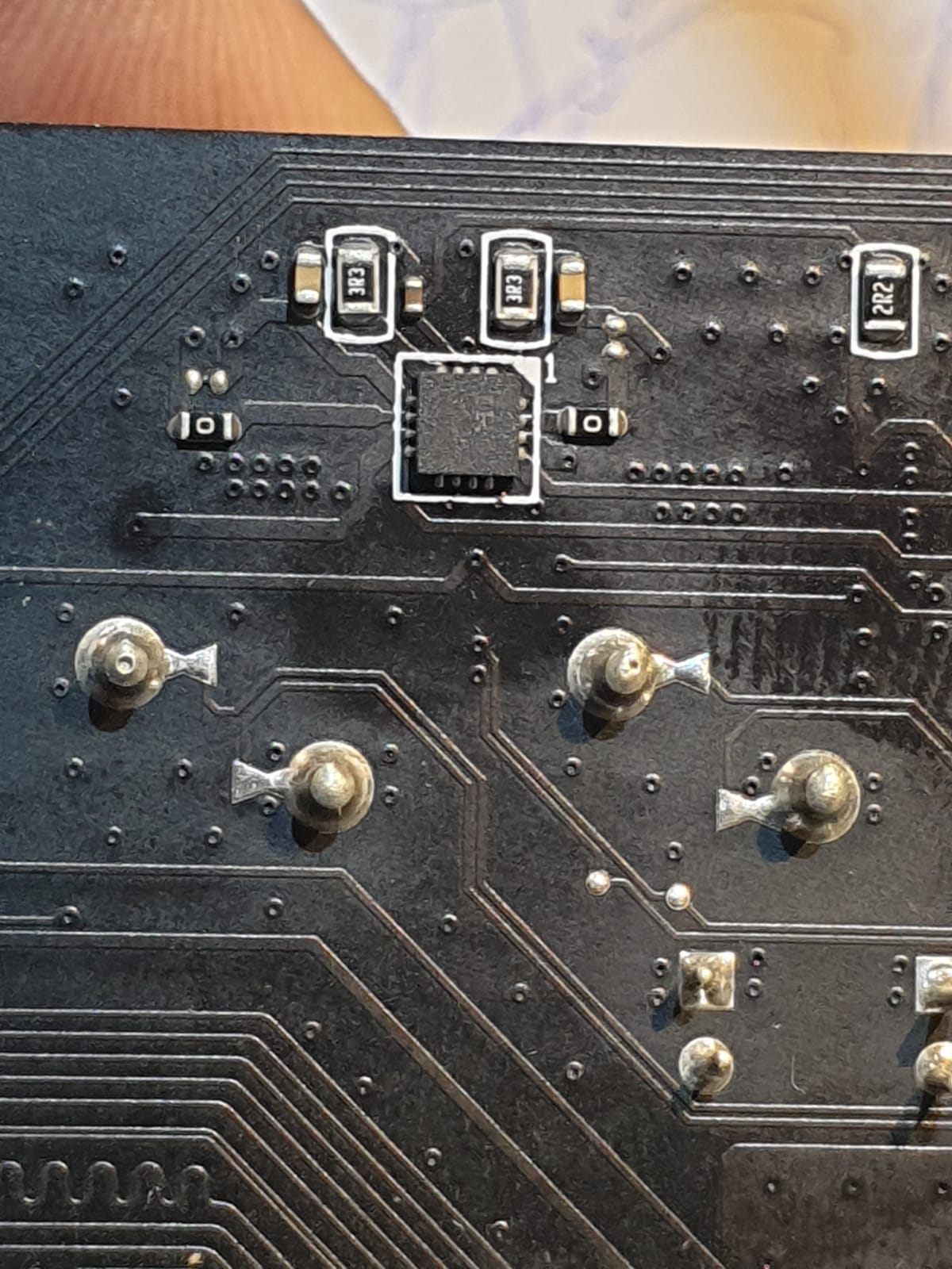

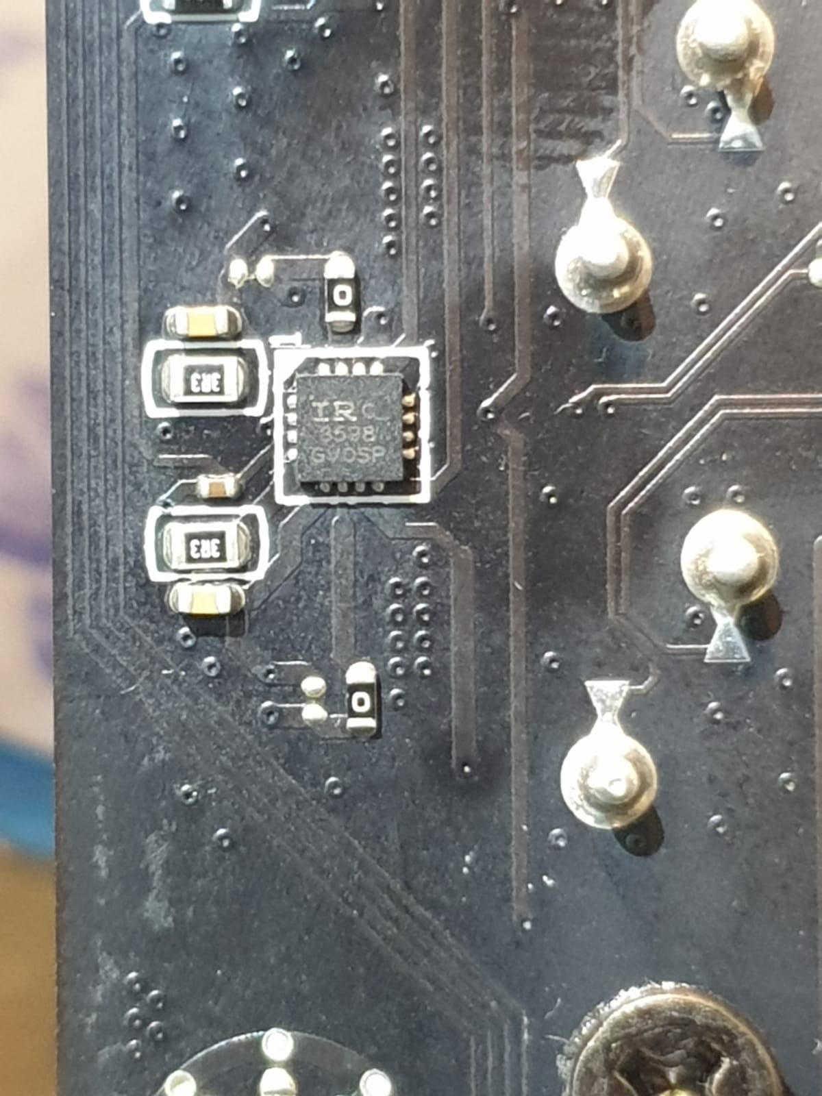

    Maybe someone could take shot of this location healthy MSI X570-A Pro and place it here as attachment.
