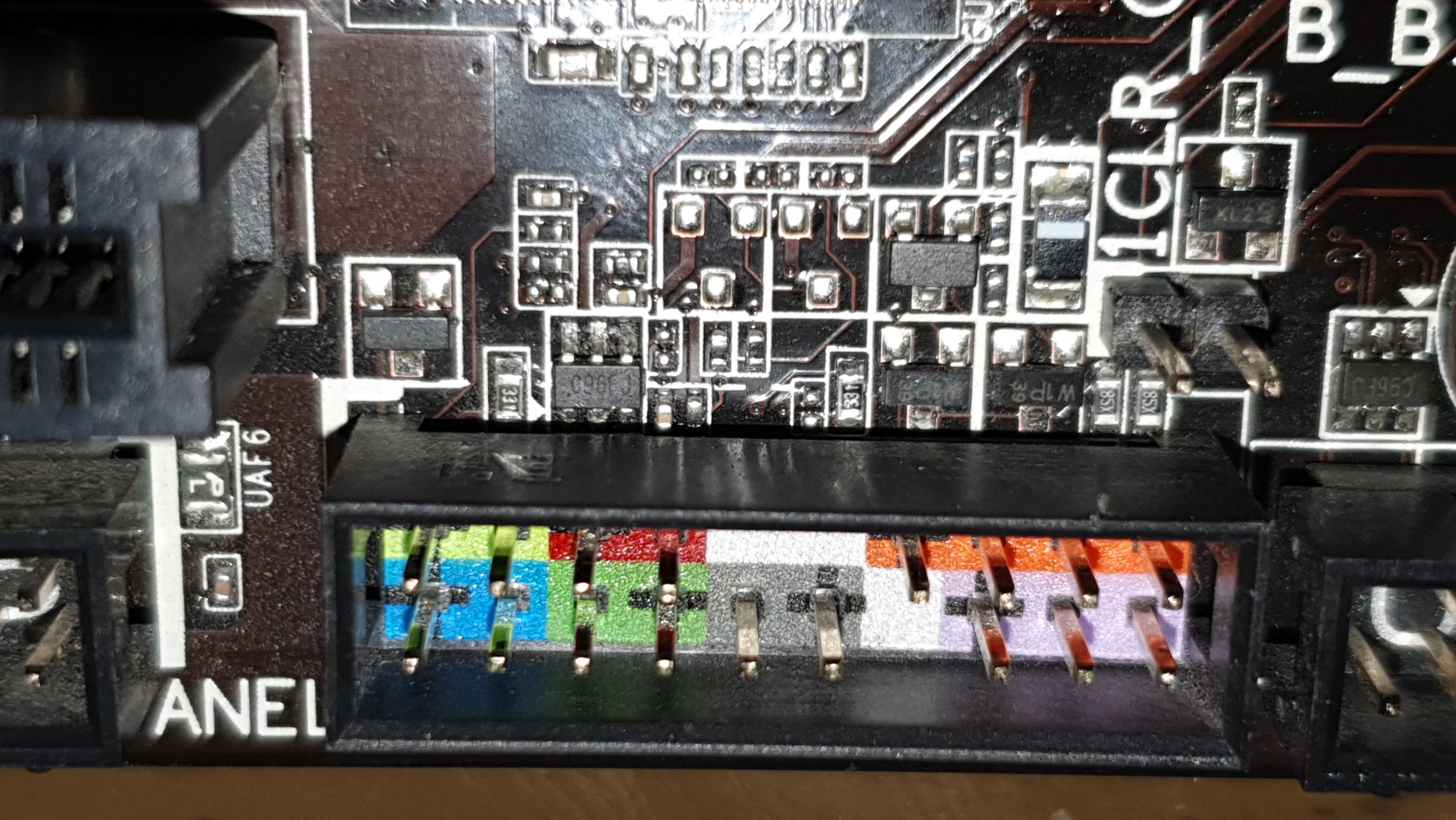

          I don't have the board nearby unfortunately, so the best I can provide right now is an alternate picture which shows an identical looking chip, though it might not be the same. It looks like this (hope the link works).

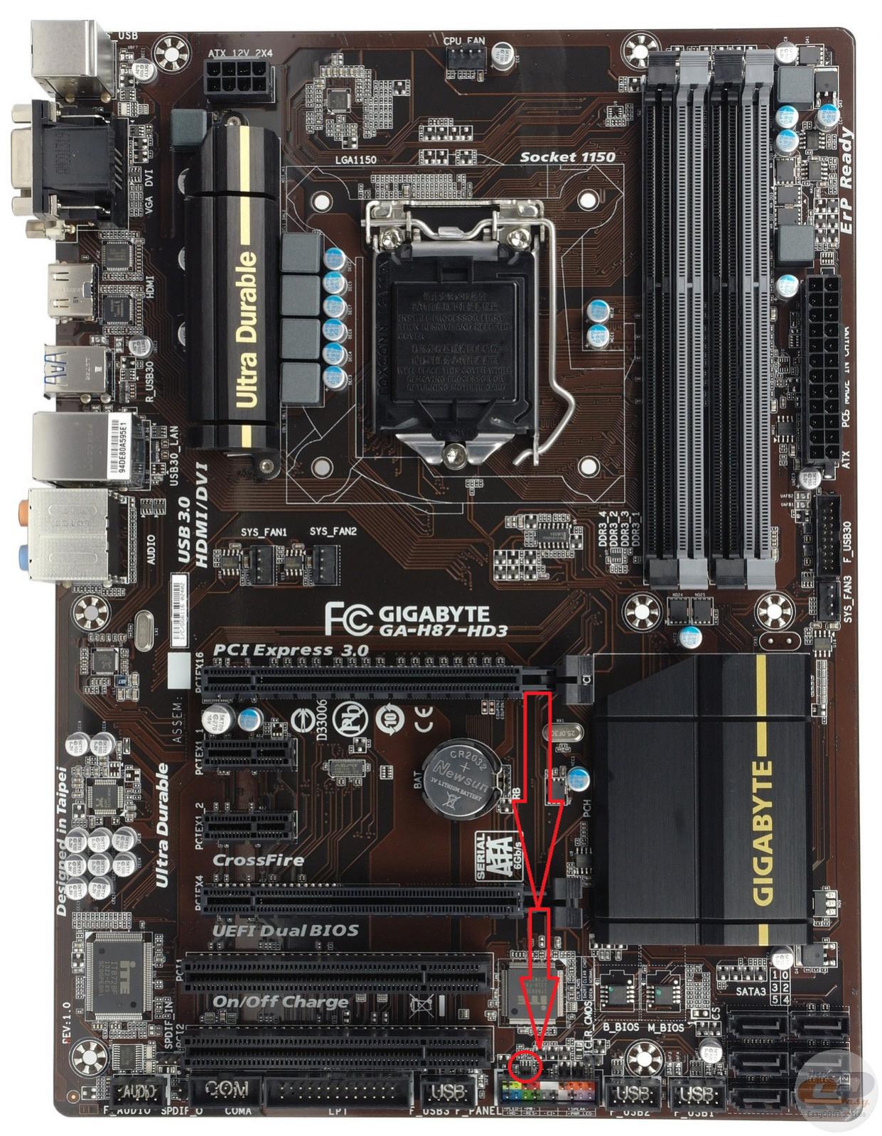

          Also, I got a high-res pic of the board and the chip is right next to the front panel header, circled in red there...unfortunately you cannot read what's on it. The VCC pin is the one in the middle, on the top half and the pins going to the ITE are on either side. The bottom-middle pin is GND and the outer two lead to the reset/power button headers. If I short the VCC pin to the ones on either side of it, the corresponding function activates, but only for turning off the system - it doesn't work again for turning it back on...

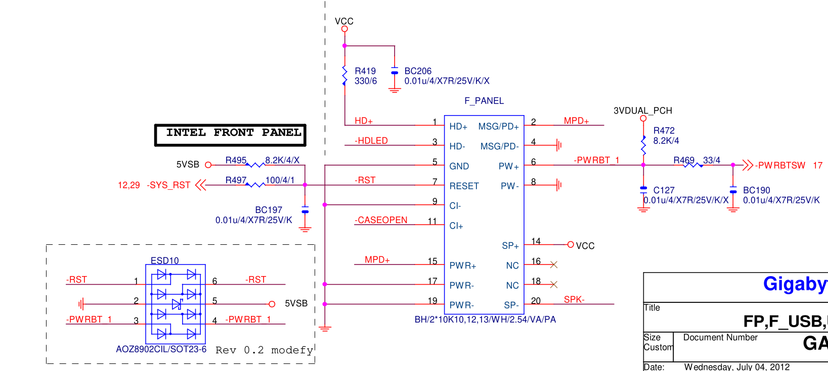

            Looking at the schematics of GA-B75-D3V (I don't have GA-H87-HD3) there's indeed a TVS array for the power button and reset button. You can simply desolder the chip to exclude the possibility of it being bad. (then you'd have to replace it to keep the safety feature)

              Yes, that's the area in question and how the internals of that chip look like. Judging from the schematic, it would seem I'm not getting "3VDUAL PCH" for whatever reason, since my power-on pin is "dead" and stuck at 0.6v all the time, but where it comes from remains a bit of a mystery. Assuming that "PWRBTSW 17" tag leads straight to the ITE chip, it could be that it's faulty and pulling that line down. I'd need to find the pull-up resistor and measure before it to see if there's 3.3v there. The BIOS chips also don't have 3.3v on them when in standby. It's only after I perform the trick to start the board that they actually get 3.3v on pins 8....

                3VDUAL_PCH is present if you can get the board to turn on, so nothing to worry about there.
                Did you remove ESD10 yet?

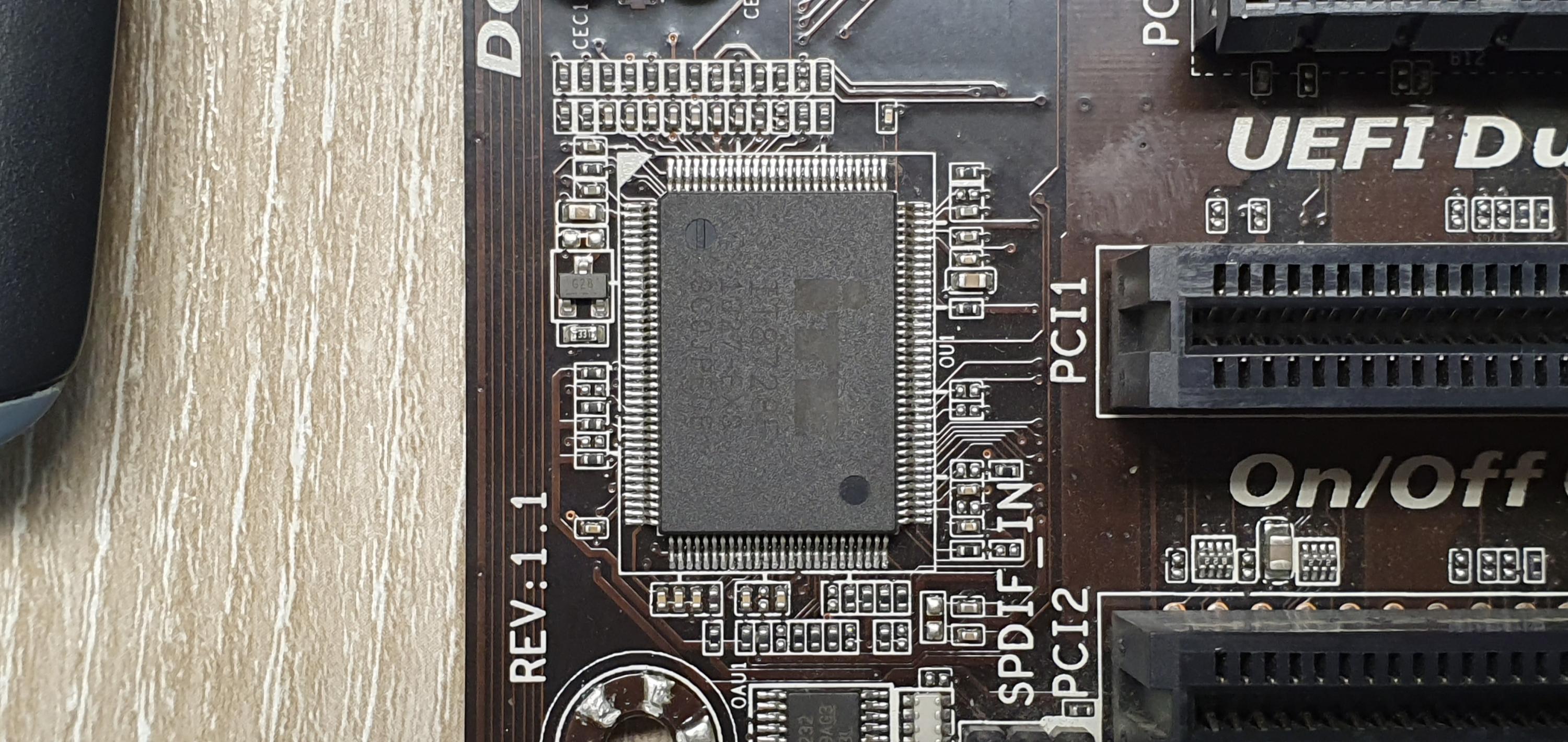

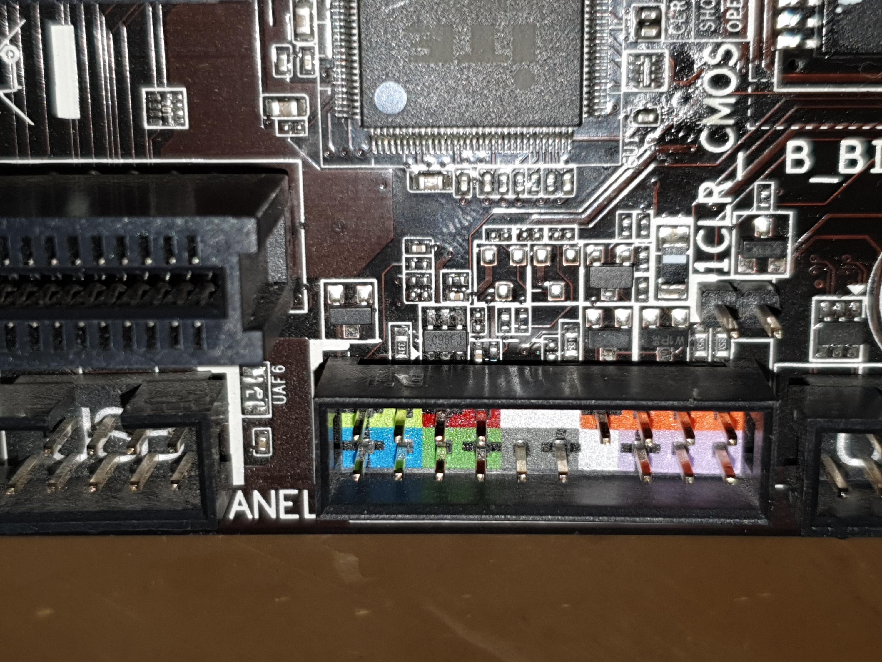

                        Here's some actual close-ups of the area around the front panel connector. The chip in question is a c96fj which links to THIS. I doubt it's to blame though. My money is still on the big ITE chip.
                        EDIT: here's a close-up of the ITE chip as well. The pins I touch to get it going are the ones in the top-right where that small lone capacitor is.

                          Ok, get this: the board is now working I ended up removing that 6-pin ESD chip and I got 3.3v on both of the pins (reset and power) so the board is behaving normally now. My idea is that one of those internal diodes had become shorted and those 0.6v I was seeing on the power/reset pins was the voltage drop across the remaining diode which was still good...just a thought :|
