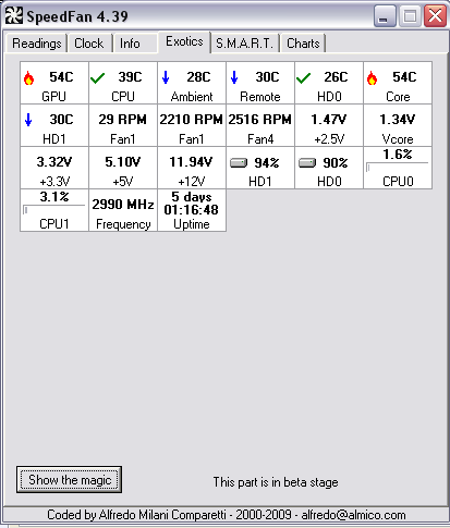

Today me and my stepdad performed our first successful motherboard re-cap on an Intel D865GBFL board, that has been freezing on Flight Sim for a while now. The results have so far been good, and I'm surprised the motherboard works considering the abuse it went through fixing it.
The only issue is that the CPU core power is around 1.35v, which only bothers me because the Intel Active Monitor does not show it right in the middle of the gauge.
Other than that, the machine feels like new. I do feel bad that I didn't get the parts through Badcaps, but other than that, I'm happy I was able to get the repairs done, and if it weren't for sites like these, many older machines would be in the trash.
