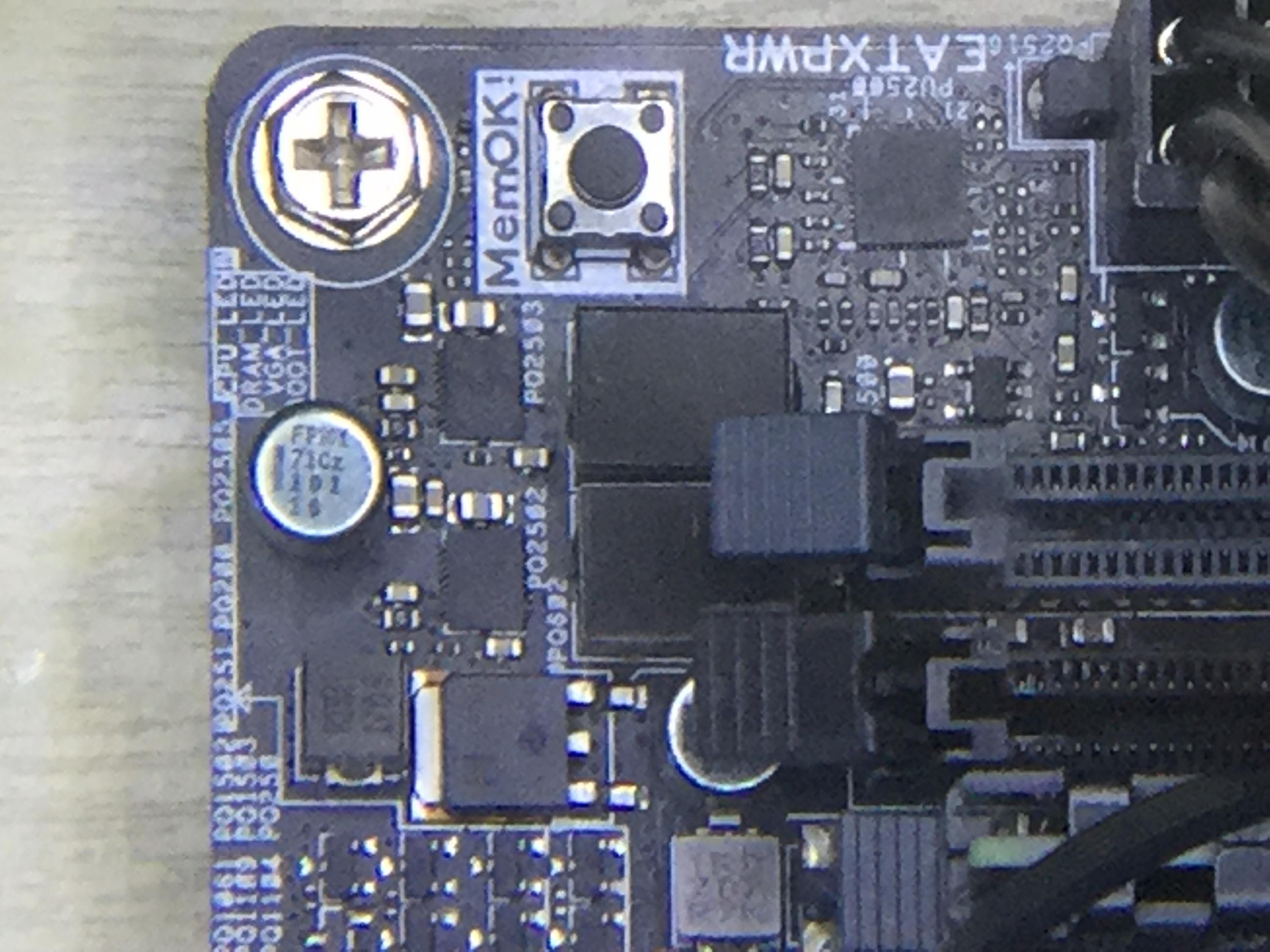

    Hello All
    Im hoping you can help me. I bought an Asus x99 from ebuyer.co.uk to replace a failing motherboard. From the get go it would randomly hang. even if i left it running in the BIOS setup it would hang so i raised an RMA and sent it back to Ebuyer.co.uk however i did forget to install the CPU cover so they returned it to me without even checking it saying i voided there returns policy even thou it was sent back in the original anti static bag and packaging.

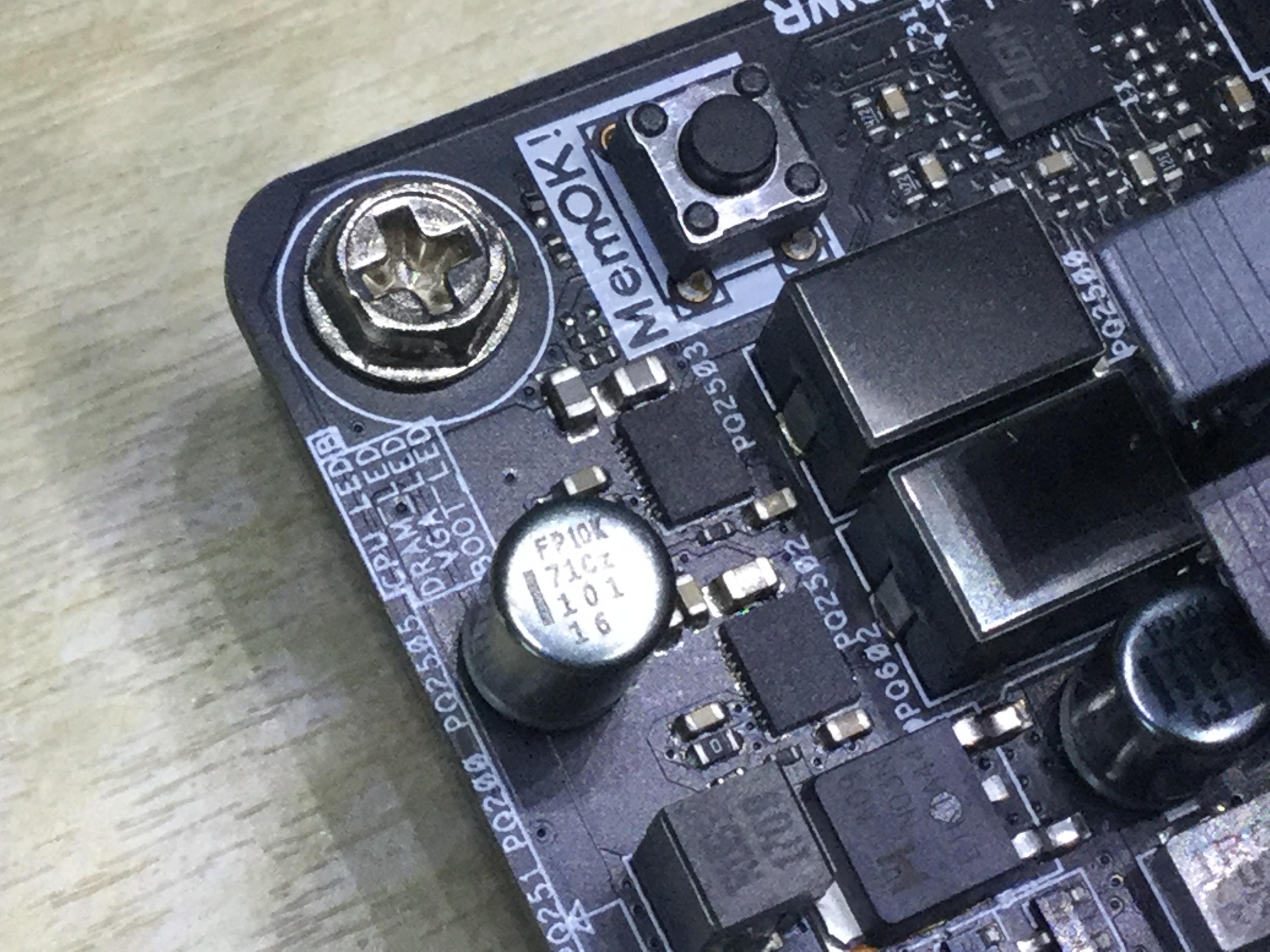

    So im stuck with the motherboard. i decided to try and find the fault and found a single capacitor gets RED HOT even too hot to touch. i found this using a temp sensor

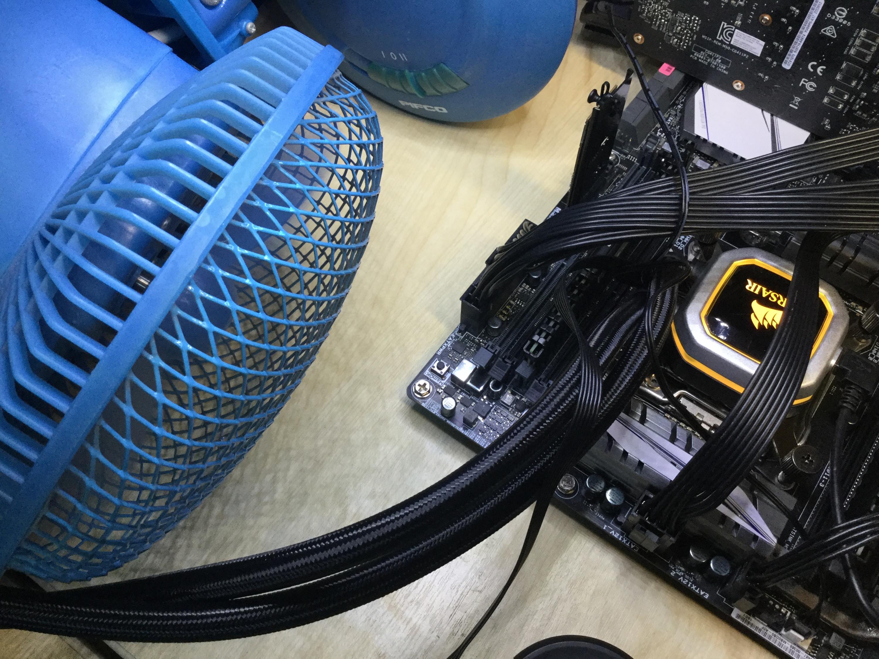

    if i direct a fan onto this capacitor the system doesn't halt/hang and its useable. If i take away the FAN it will hang within minutes.
    So i contacted ASUS and explained the situation with Ebuyer.co.uk and stated that the issue is not related to the CPU but this capacitor however they inform me that they no longer take RMAs directly and that i have to go through Ebuyer.co.uk and they are refusing so can you help?
    The issue of the hanging seems to be with this overheating capacitor. Is it something i can source and replace and would fix the issue or is the over heating cap a symptom of something else?
    Is there a test i can do on the cap?
    Can i get a replacement? if so what do i order as the numbers dont mean much to me. I do work in IT and can use a soldering iron
    The Marking on the Cap are
    FP10K 71Cz 101 16
    Thank You

    Polymer Aluminum Solid Electrolytic Capacitors (FPCAP)
    I believe the FP10k is the original fujitsu series
    71Cz is a lot number, 101 = 100µf, 16 = 16volt
    Fujitsu is now nichicon
    panasonic also makes them
    Nichicon RS8 series I would think would work, I'm sure someone that has replaced these will recommend something
    RS81C101MDN1 size = H,9mm; D,6.30mm

      check the mosfets and inductors near the cap. most likely a failed, overheating mosfet and/or inductor is the root cause of whats causing the cap to overheat. replacing the cap wont fix the issue unless the bad mosfet/inductor is fixed first.

          Thank you all for the replies. It seems its not just the capacitor thatoverheats. Those 2 black square components also overheat. If i put a heat sink on them and take the fan away the pc run a few more mnutes but again the capacitor gets red hot and hangs. So i think your right its not just a capacitor issue. not sure where i can go from here

                      That circuit seems to be for the memory on that side of the board, have you tried removing the memory stick and see if it still gets hot?
                      There also seems to be an identical circuit for the other memory stick. Try swapping the memory sticks
                      The ic's seem to be CSD97374Q4M

                          The ic's are stepdown buck converters, likley 12v input and 1.8v output, you could check the voltages, there could be a shorted mlcc on the output loading down the whole circuit. There looks like an identical circuit supplying the other bank of ram, Try comparing resitance or voltage between the two circuits
                          It could be that cap on the ouput is bad (560µf/6.3v)
                          I see some boards use a IR3553 for the buck converters
