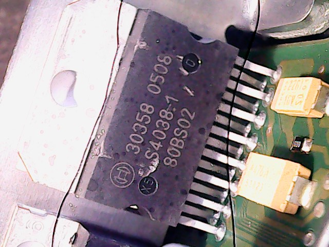

    Hi Guys.
    I have a ECU board here... According to the Mechanic, the motor is being over fueled... I saw the injectors pulse while cranking the engine. Which seemed fine to me but anyways. I just need some help if possible to find details on some parts.
    Attached are photos with the first number on the chip.
    These I assume based on various searches on the net... hence the thread here...
    Bosch System [0 261 206 916]
    30358 = Seems to be the ECU Driver
    30311 = No idea

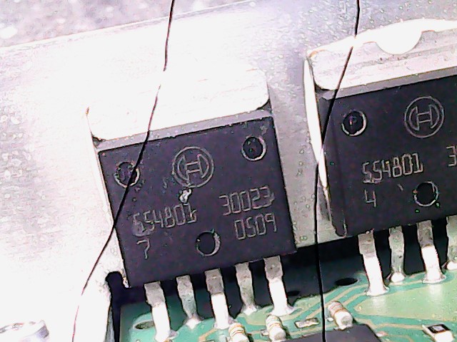

    30023 = Ignition Drivers
    30313 = Fuel system / Injector Driver
    I haven't really ever found any datasheets regarding these Bosch chips... and ofc no schematics/diagrams for these ecu's

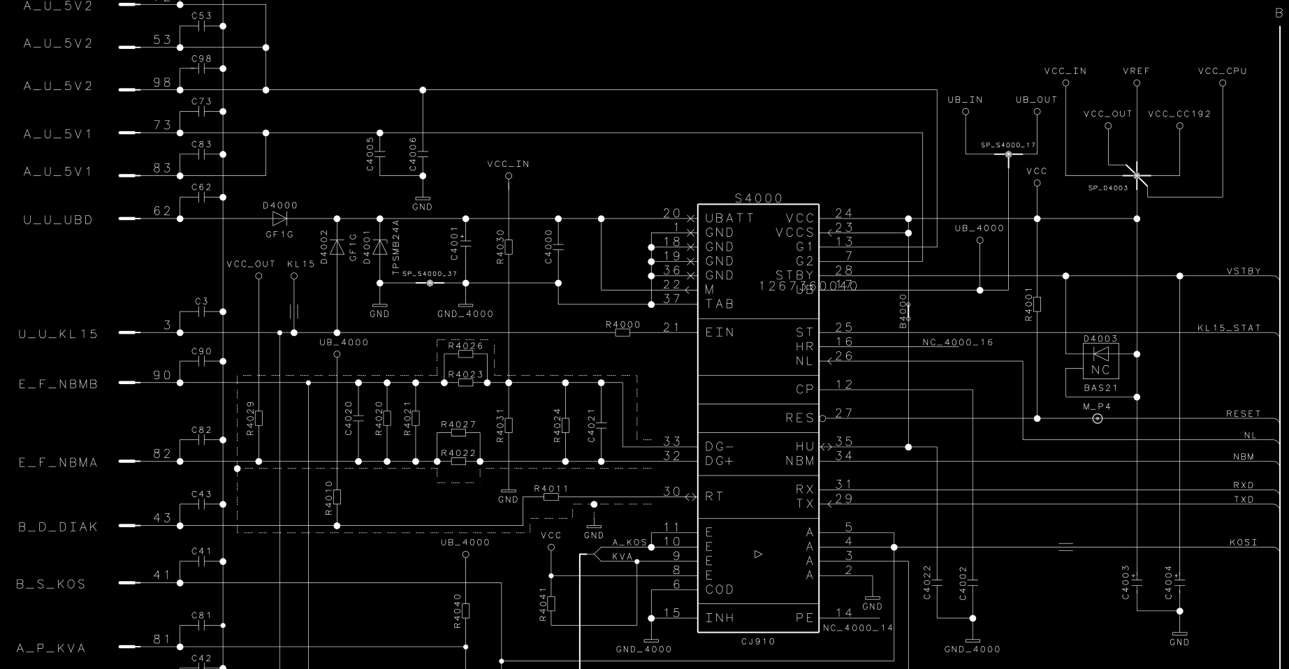

                  Which brings me to another point, I have found some schematics for a ME7.1 Bosch ECU. I also have that same type ECU here (broken, donor board) and that has given me some real insight the last day or so to try and semi reverse engineer / understand these ecu layouts. I have to say that the NR.1 and NR.2 ECU's are also bosch and the over all placement and layout of the boards are very very very similar. Even tho they differ a bit, all 3 are Motronic as well... BTW Willing to share what I find here if anyone's interested.
                  Attached is a sample of the CJ910 chip which seems to handle the Boards supply voltages for the CPU and controllers. (This is from a ME7.1 Bosch ECU. Similar to the one I'm working on, cross reference is not to difficult here...)

                    Okay so just to finalize this issue.
                    About the chips on this Bosch M1.5.4. After a few days of insane research/reading I gathered a lot of info... Learned a shit ton of stuff as well.
                    Reviewing those chips
                    30358 = 5V supply and output for 5V ref circuit to sensors. May handle digital ground as well.
                    30311 = Sensor signal converter / Controller. (Various if not all Sensors)
                    30023 = Ignition Coil Driver
                    Also discovered various other chips that do other things.

                            This is an old post,but I thought I might add in a few details in case someone needs info in future .
                            The Bantam ECUs (also fiesta rocam and 1.4 Mazda soho) have very little info available on them,but over the years through hacking away at spare ECUs i managed to identify components,create tunes and pluck apart the 8051/2 routines.
                            30358 = Voltage Regulator and power control,this switches the main relay when a certain ECU pin goes high and supplies a constant power source to the internal ram,as well as a switched 12v and 5v to the sensors.
                            30311 = Bus converter and buffer for CPU serial Comms (diagnostic Comms to CPU) and buffer for other signals such as crank and cam
                            B58543/M27C512 = external program memory,this memory space holds all the engine control parameters (Maps)
                            30389/30117 = sub-processor for dual channel knock control.sometimes this is not equipped.
                            B58290 = low level ignition driver
                            B58291 = 2 channel PWM driver for idle control and heater valve
                            B58253/24C02 = serial EPROM,storage for immobilizer data,also fuel trim,octane increment adjustment,idle fuel trim,idle stability.
                            Hopefully this will help someone out in future,took some years to get this data together.
