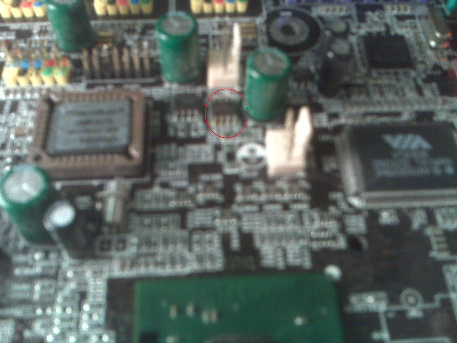

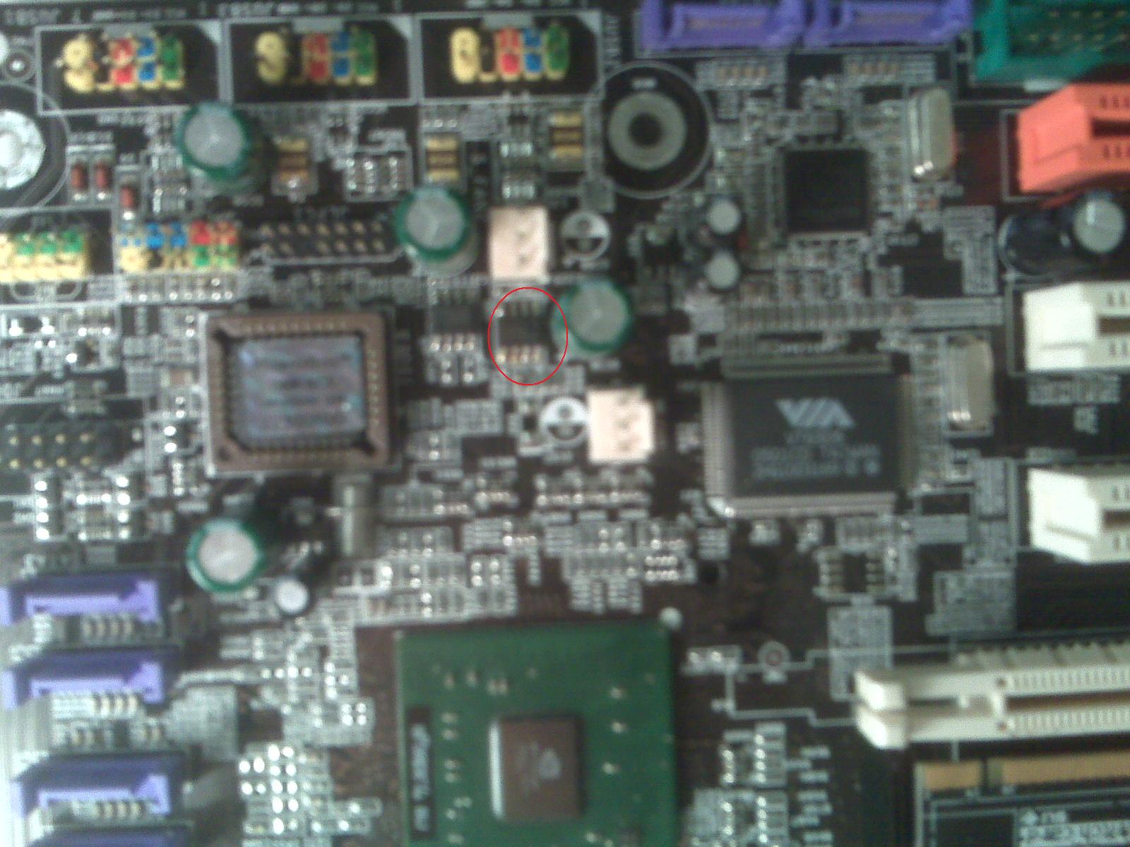

    Last night I inspected the mobo again and then I noticed that one of the MOFSET (APM7313 ) has a brownish discoloration on the top and some brown substance around its legs.
    I was wondering if this could be an indication for a bad MOFSET? How can I test it? Could one of the caps near it (KZE 470micF 10v 105degC) have killed it and need to be replaced?
    I attached a couple of pics, but unfortunately I don't have my camera with me, so I took them using my cell phone and the quality is bad.

          Testing the power supply is not the same as opening it and inspecting the caps. Another board may be much more tolerant of bad power. Ignore the warranty sticker. Open it up.
          The cap could only have killed it if the cap was bad and that can be tested. Nothing brown comes from a burned chip so unless it's rosin which would only be on the solder then it would be a leaking cap next door. Caps with a poor seal will leak out the bottom onto the board without bulging the top or pushing the bung out. Caps can also dry out with little or no bulging or leakage. Clearer pictures would help. An ESR meter will tell all.

            The capacitor by the MOFSET seems to be intact; I don't see any leakage signs and the brown substance might be some flux or something that wasn't cleaned out before leaving the assembly line.

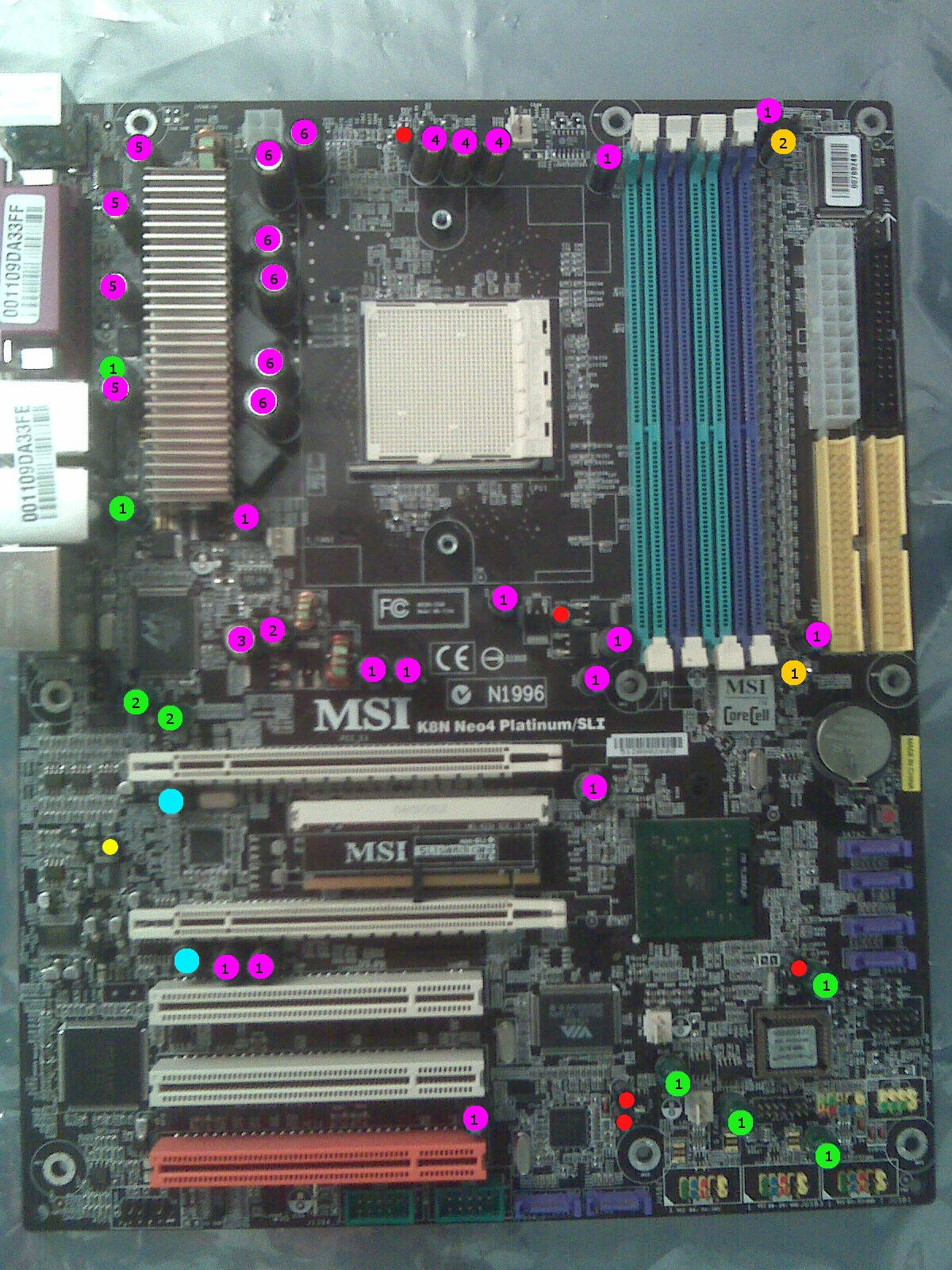

            I attached a pic with the caps marked in colors by manufacture, hopefully this would make more scene to someone.
            The caps on the board are:
            KZE - Green
            1. 10v 470uF 105°C
            2. 25v 100uF 105°C
            G-Luxon - Red
            6.3v 100uF 105°C
            Panasonic (Matsushita)? Has a logo with the letter M inside of a square - Purple
            1. 6.3v 1000uF 105°C FJZ
            2. 10V 1000uF 105°C FL
            3. 10v 1000uF 105°C FJ
            4. 6.3v 1800uF 105°C FL
            5. 16v 1800uF 105°C
            6. 6.3v 3300uF 105°C CFJ
            Nichicon - Turquoise
            16v 470uF 105°C
            KMG - Orange
            1. 10v 470uF 105°C
            2. 16v 470uF 105°C
            Unknown – Too small, has some vertical round equal signs from top to bottom - Yellow
            16v 47uF 105°C
