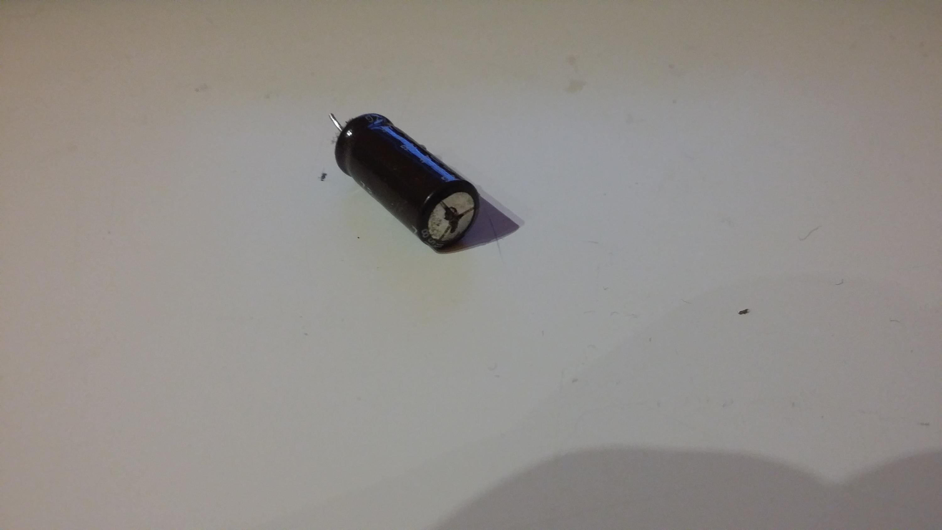

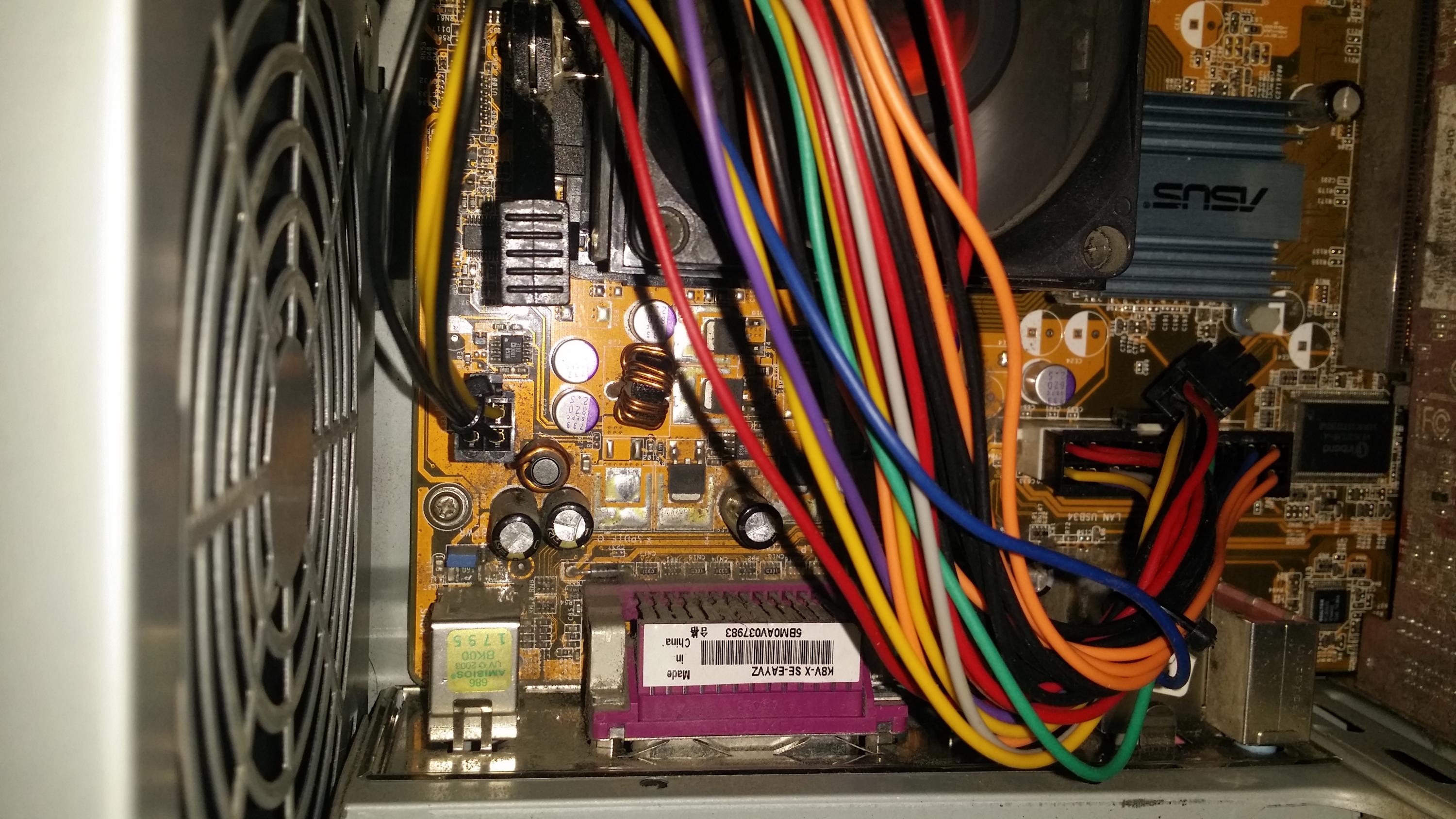

    I have an Asus K8V-X SE board with nippon-chemicon KZG 6.3v 1500 microfarads capacitors defective, I made full VRM the polymod, with capacitors os-with SEPC 820 microfarads 2.5v. At the moment it works very well, I am writing this post with this computer.

            Ok, I'll put more to compensate for the loss of capacity. So far with the 6 there is no abnormal noise, and the capacitors are cold, and I have it overclocked at 2.4GHz to 1.4v
            I think the polymod output worked well, but since you say so I will put more capacitors in the empty areas.

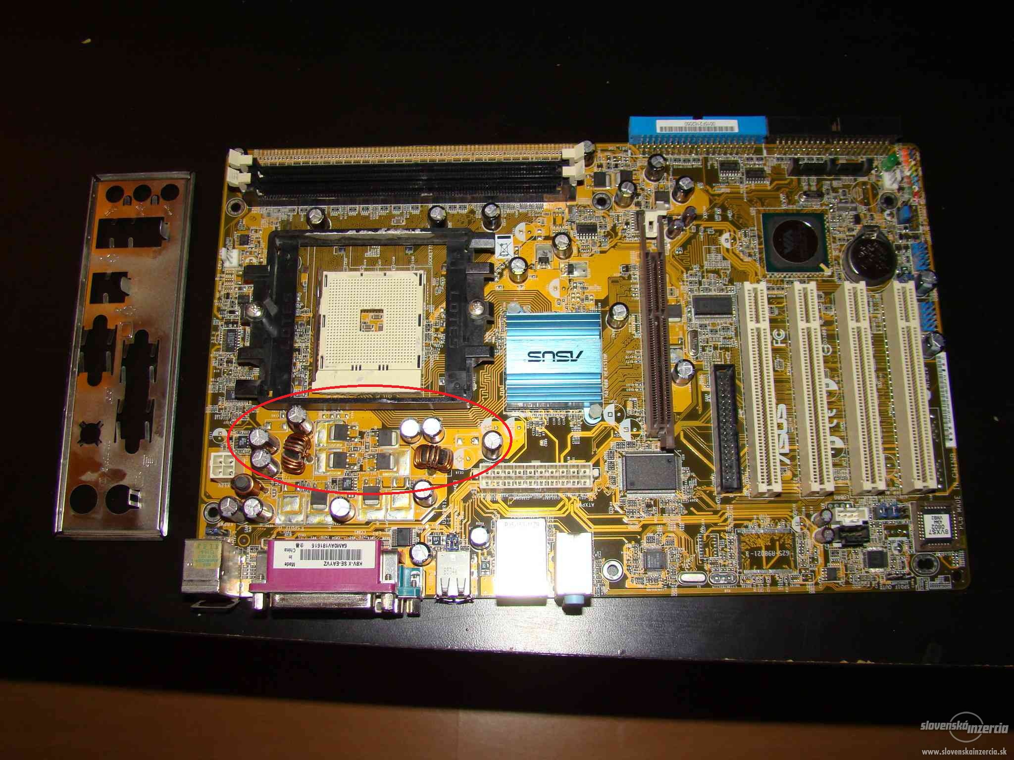

            In the area marked in red in the image, they are the ones that change for the Sanyo.

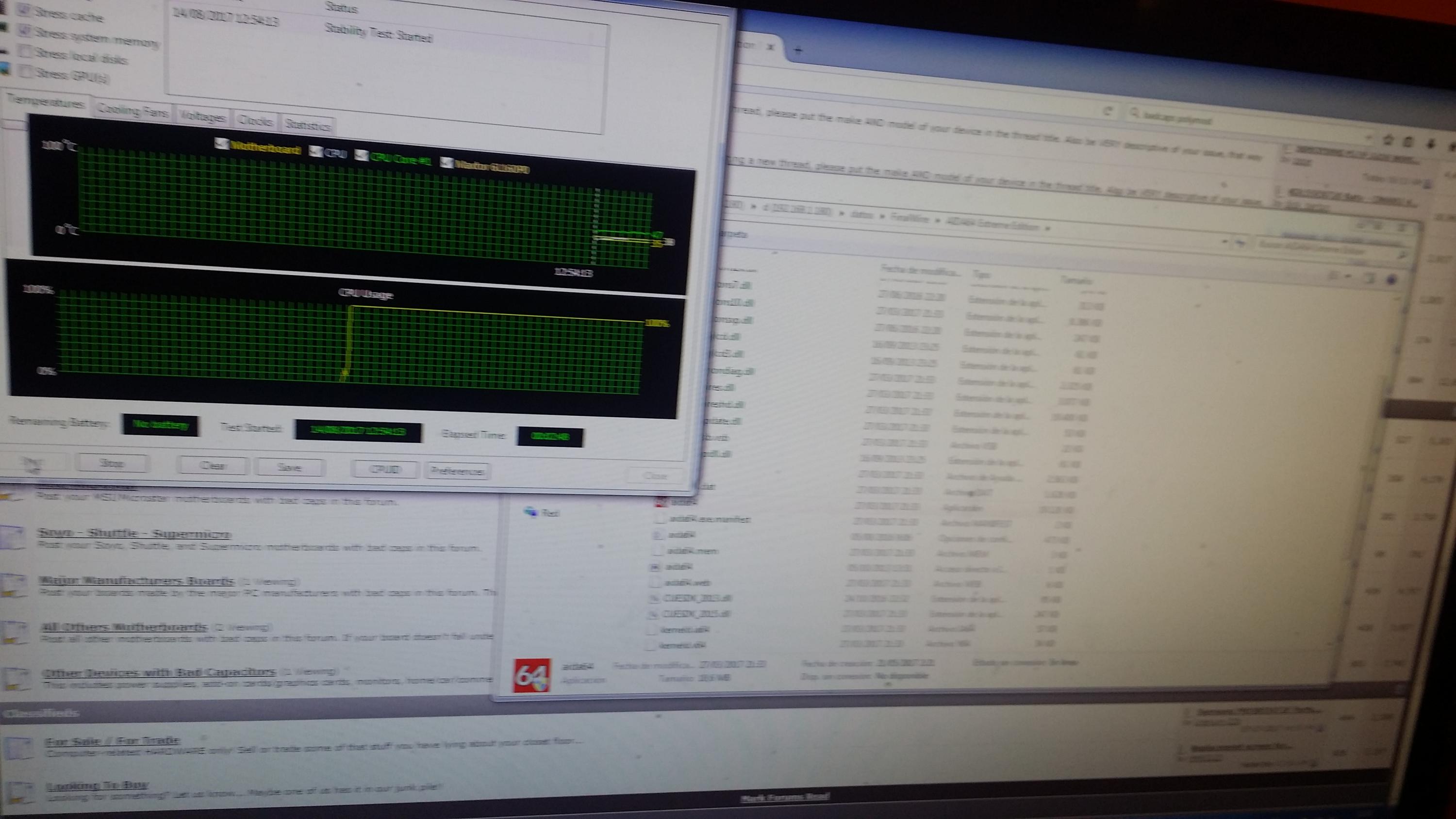

                Yes, I was pleasantly surprised to have overclocked 2.4GHz to 1.4v, I worked, but today I plugged the computer and started to hang, I discovered that it is the fault of the AGP bus, it seems that even if I put it locked at 66MHz, when I go A FSB so high the chipset becomes unstable, It's a shame because the CPU holds up very well and likes very much the overclock, to see if I get a better motherboard and I can give more overclock.
                The temperature is maintained above 114 ° in the bios, it seems to me a suitable temperature.
