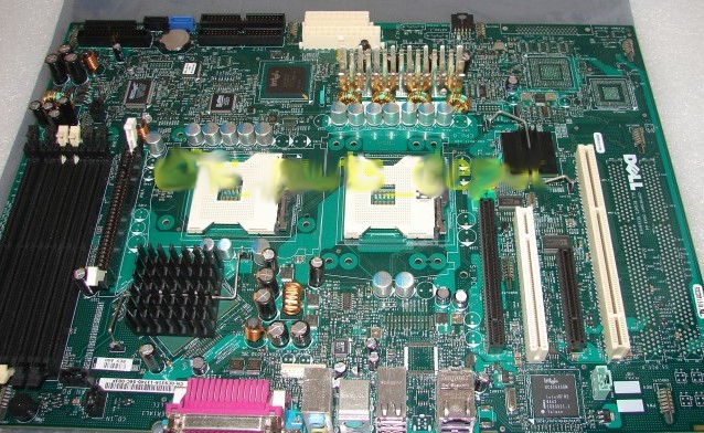

                              Hey all,
                              I was sent over here to get some advice on "poly caps"?
                              This was my Exchange 2007 server that crashed, umm.. burned up day before yesterday.
                              She gave no warning just quit. I have taken them out (but y'all say these are top caps so.....?) with a HAKKO 808 desoldering kit. (darn thing works fantastic!
                              Here I was thinking I was going to pop into RadioShack, but I now see that is not going to work as hoped

                                I hope you made a cap map taking note of the polarities in addition to uF and volts.
                                Excessive heat will kill any lytic after a while.
                                The ones that didn't bloat are probably aged pretty well and since you have them out anyway...
                                The photo is one that has been poly'ed.
                                Not sure if it's a newer revision or if its been rebuilt.
                                The Vcore caps can be down to 2.5v and 820uF is probably best.
                                The VRM-IN caps [caps on +12v that power the CPUs] need to be 16v caps and on a server I'd use at least 470uF.
                                The others you should probably leave as lytics at the original values because, without knowing exactly what they do or what actual voltage they are on, changing the uF or volts can much things up. [Little too late to check their voltages with a meter.]

                                    Originally posted by PCBONEZ
                                    I hope you made a cap map taking note of the polarities in addition to uF and volts..
                                    Oh yes i did and they are numbered on the board and polarity is clear
                                    The ones that didn't bloat are probably aged pretty well and since you have them out anyway....
                                    The ones that popped i had marked with a red sharpieI was not thinking I should pull all of them
                                    Not sure if it's a newer revision or if its been rebuilt..
                                    might just be my pen marks?
                                    The Vcore caps can be down to 2.5v and 820uF is probably best..
                                    All the ones I pulled were all 6.3v
                                    The VRM-IN caps [caps on +12v that power the CPUs] need to be 16v caps and on a server I'd use at least 470uF..
                                    Those are 16v 1000uF. you are suggesting change those?
                                    The others you should probably leave as lytics at the original values because, without knowing exactly what they do or what actual voltage they are on, changing the uF or volts can much things up. [Little too late to check their voltages with a meter.].
                                    There are four of the 6,3v that look in great shape. only thing is my range meter wont charge the board enough to get an accurate reading
                                    I took your photo and circled the ones that I pulled.
                                    If so many of them blew up how do you know if somethin much more fragile like a transistor/thyristor or a mofset isnt burned? They TO SMALL to see and toooo many of them!
                                    After all, caps can be used as voltage regulators. Oh and how can you tell the VRM-in caps from the rest of them?
                                    Sean

                                          All of the caps you circled should be replaced with electrolytics.
